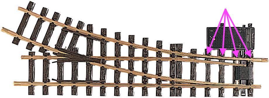

Team, once again I'm seeking your wisdom and advice. I have x2points on the layout (Piko curved points, LGB R3) where the track ties on one side have been damage. This affects the gauge between the rails (making it smaller) and is frequently causing derailments. I can generally reposition a rail after a derailment and it will be fine for a while before it moves again. My track is fixed with rail clamps but these don't seem sufficient to hold them in place.
I'm curious if anyone had a similar problem in the past and how they resolved it. I was thinking of simply supergluing the brass rail to the remaining cable ties but this seemed quite slapdash and I wasn't sure how it would hold up outdoors.
EDIT: @JimmyB pointed out I wasn't clear _where_ the issue is which isn't very helpful when asking for advice so I added a picture:
