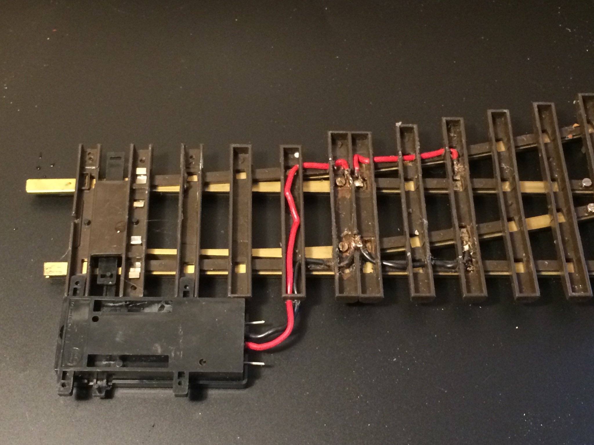

Reading all replies i conclude thet there is no attention to conductivity problems with points. My experience is that all points after some priod have a problem with conductivity. This is caused by the bad contact between the moving parts. The solution is to solder extra wires at the underside of each point. This is well described in my book “our model garden railway” available at Amazon.
Gerard van der Schrieck
