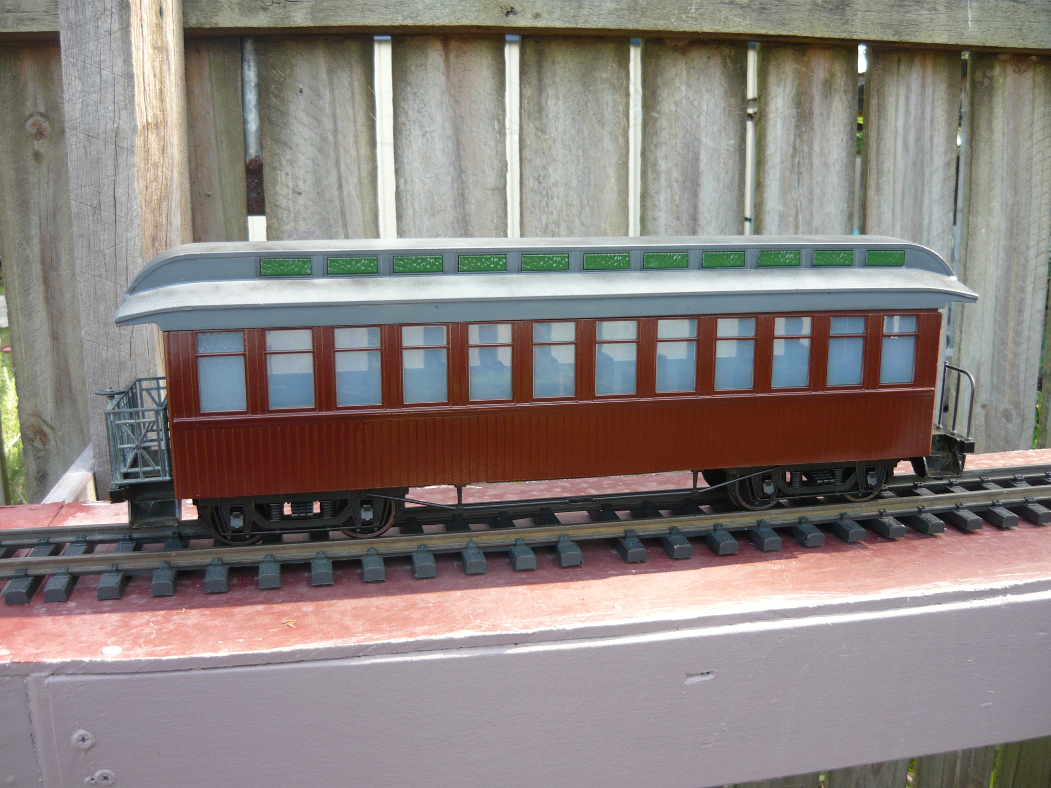

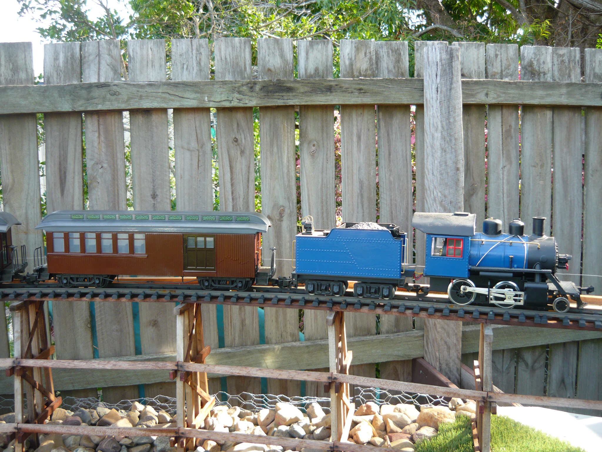

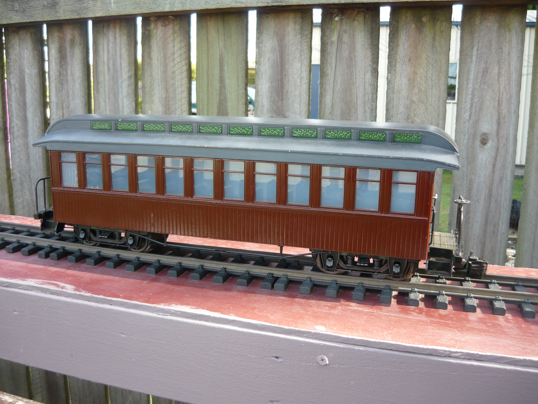

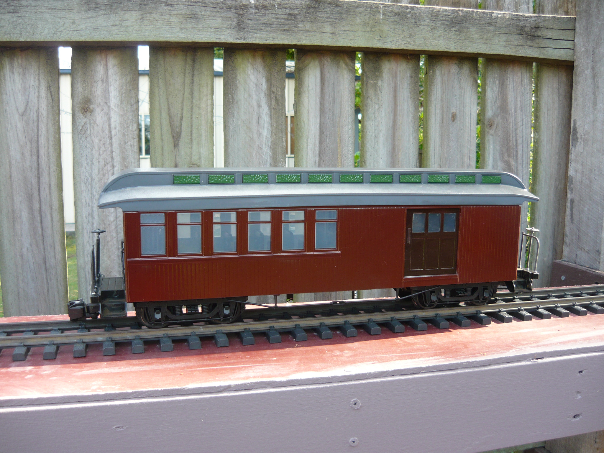

I repainted my Bachmann coaches, originally they were a gawdy canary yellow that just did not please my eye so I repainted them to a colour more attune to Australian rolling stock.
These carriages are pulled by an LGB loco that I painted blue similar to a loco known as the "Blue Baby" that is at the "Ipswich Railway Workshops" in Australia.
Bit of "dirt" added to steps and verandahs plus a dusting of Matt Black on the roofs.
Carriage after repaint.JPGCombine after repaint.JPGObservation after repaint.JPGPeanuts and Combine close up.JPG

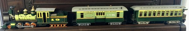

Painted mine, LGB' in remembrance of the old Orange Blossom Special just brightened the greens up a little, and since the picture was taken I have added a combine, BillMB complete 2.jpg
