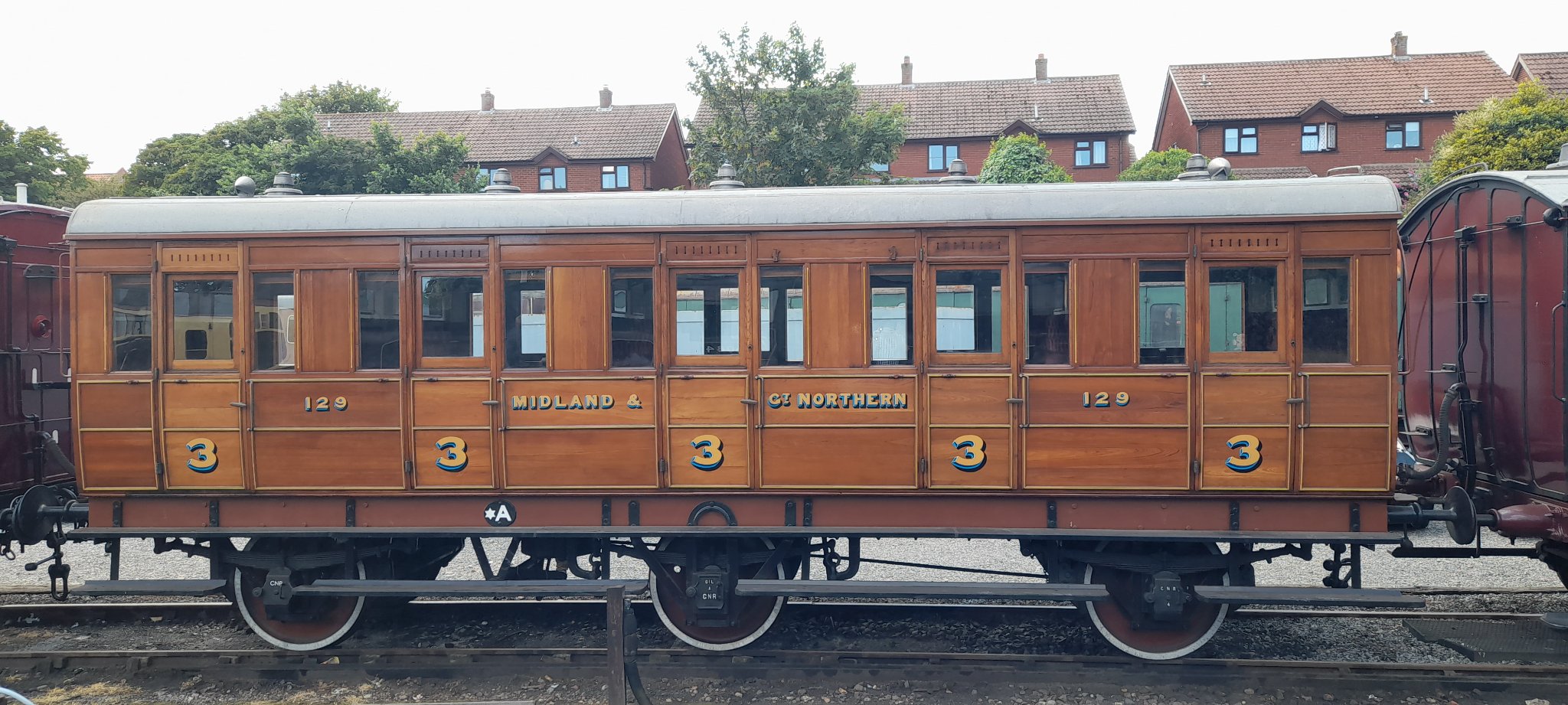

Northsider Northsider did you have the measures to notice the beadings were too thick or did you only notice by the appearance?
I would like to make my Maunsell coach look like the real ones but for now I could only find photos from the internet, not any precise measure

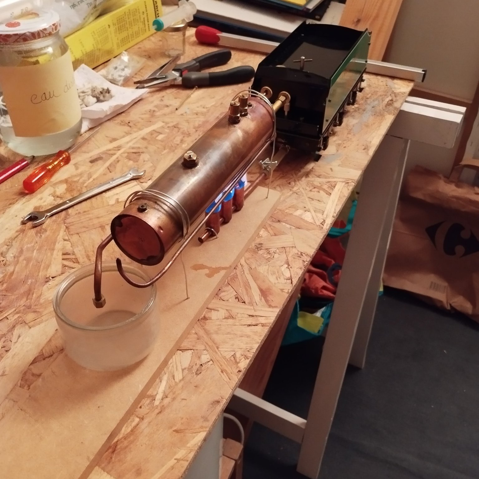

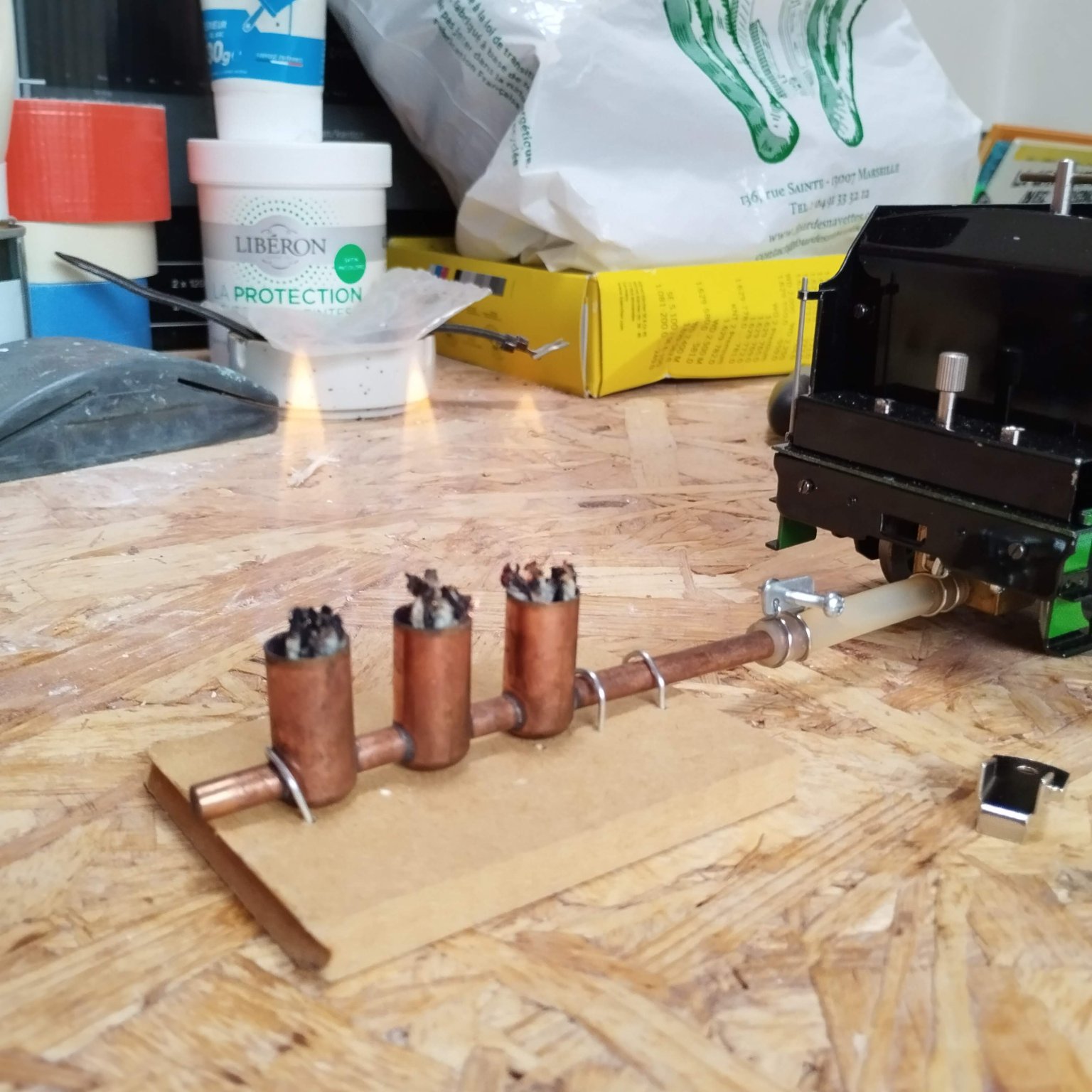

Later when I tested the burner of my Schools I was really afraid of lighing it but I went step by step, making sure the new seals of the alcohol tank did not leak using water, then with alcohol but no fire, finally after double or triple checking everything I lighted the burner out of the loco, once confident I put the boiler to test it, then plugged the wilesco boiler to to the loco and finally steam from the loco !
First burner lighting, I then did a lot of wick tests to get more blueish flames
Then the boiler
I try to be secure by having some habits like never put the meths bottle on the table or desk but on the floor so I never forget to tighten the cap, and I always have a towel soaked of water near me. Fingers crossed for now I only made some burn marks on the kithchen table :)

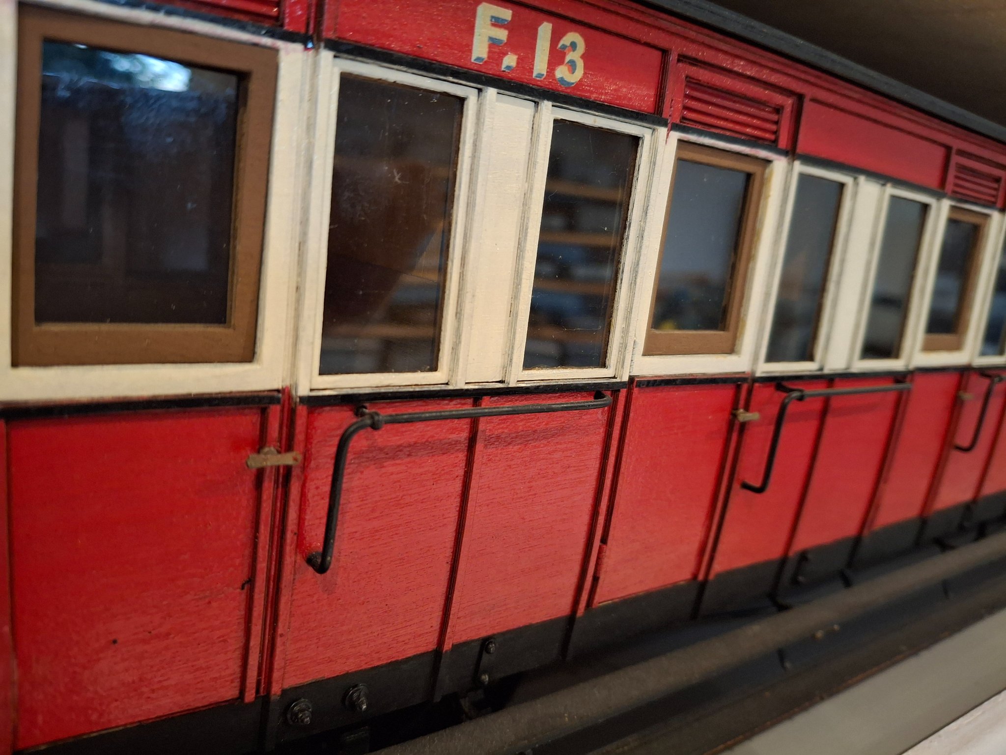

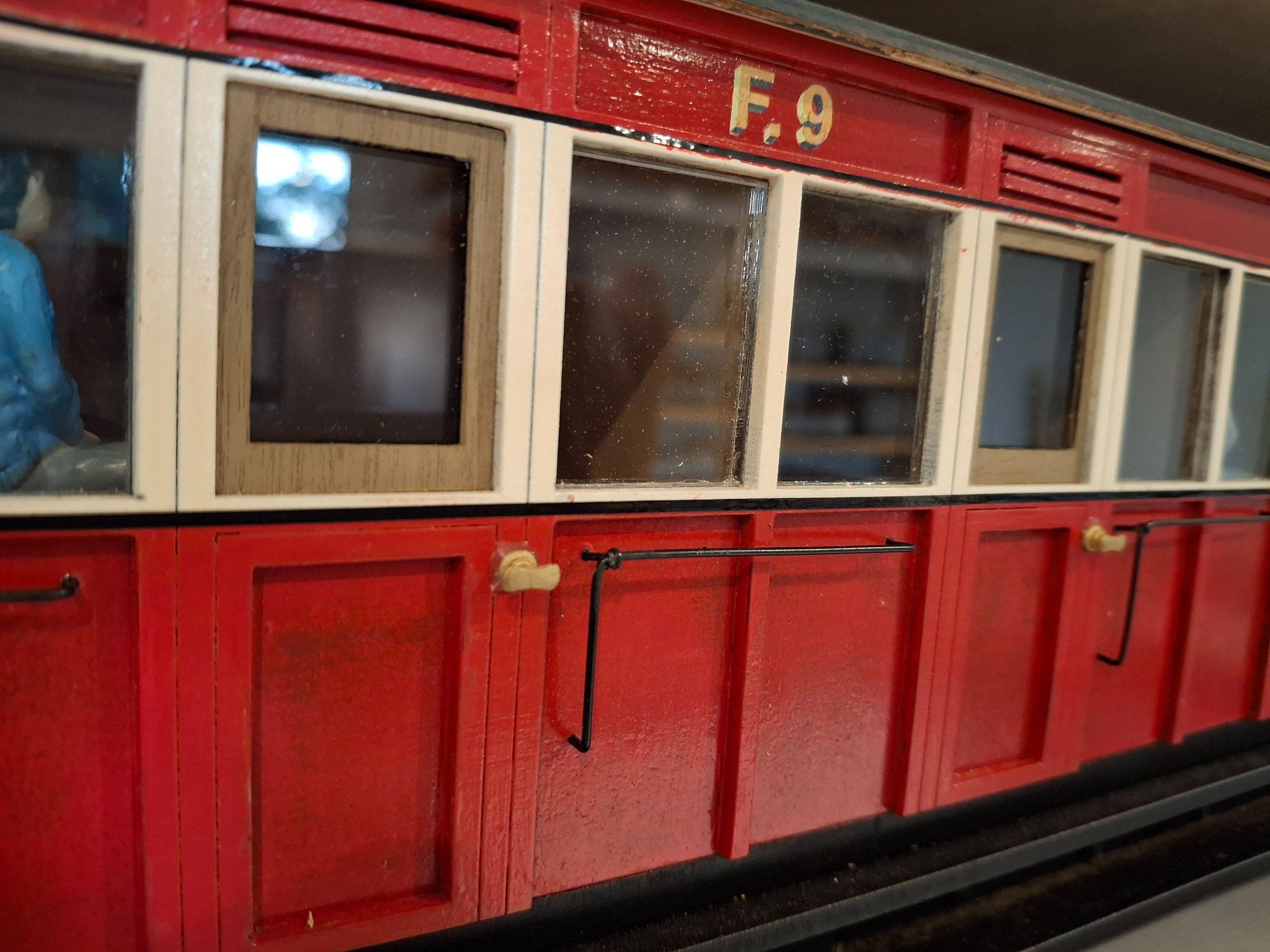

As Northsider Northsider says, I built an Isle of man Small F and found it it quite easy but modified the beading with plasticard, here's a link to the build on the IoM 15mm group website
Oops! Northsider, Fezwig, I mixed your nicknames sorry!
Thank you Fezwig for the build log!
The tip for making a removable roof is of great help!
