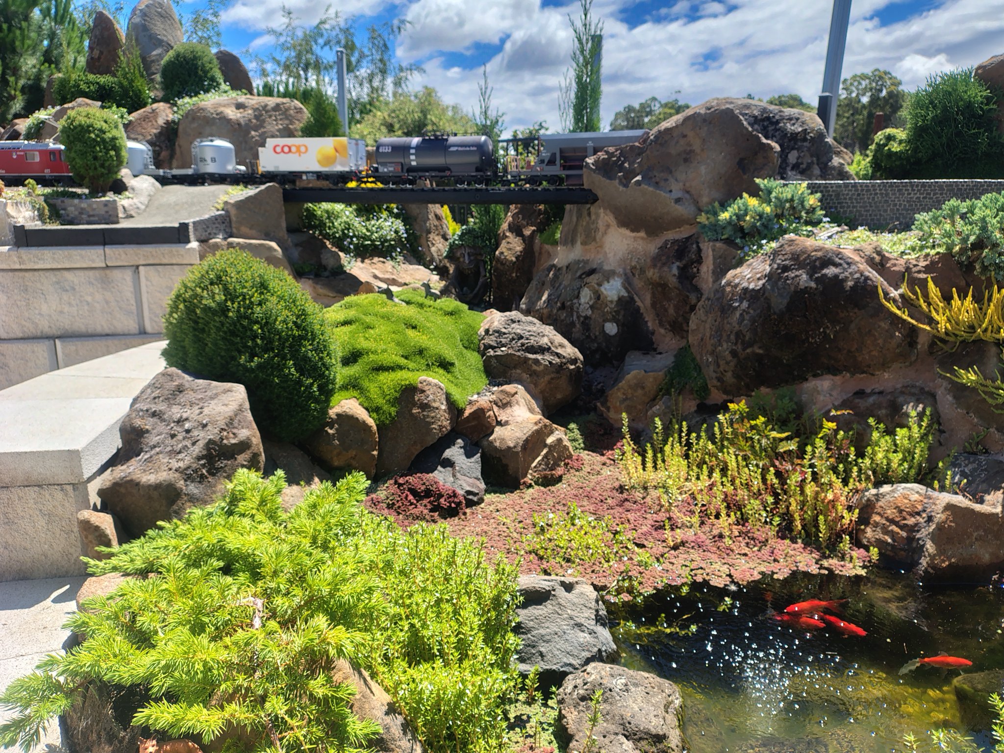

Took the day off today.
The view of todays freight train, from my favorite seat.
The comets are very active today, we started with 4 now there are 6 maybe there will be a few more soon :D .
I had a helper today, getting a well deserved ear scratch for his efforts and yes he has a bed for out here kept in the workshop.

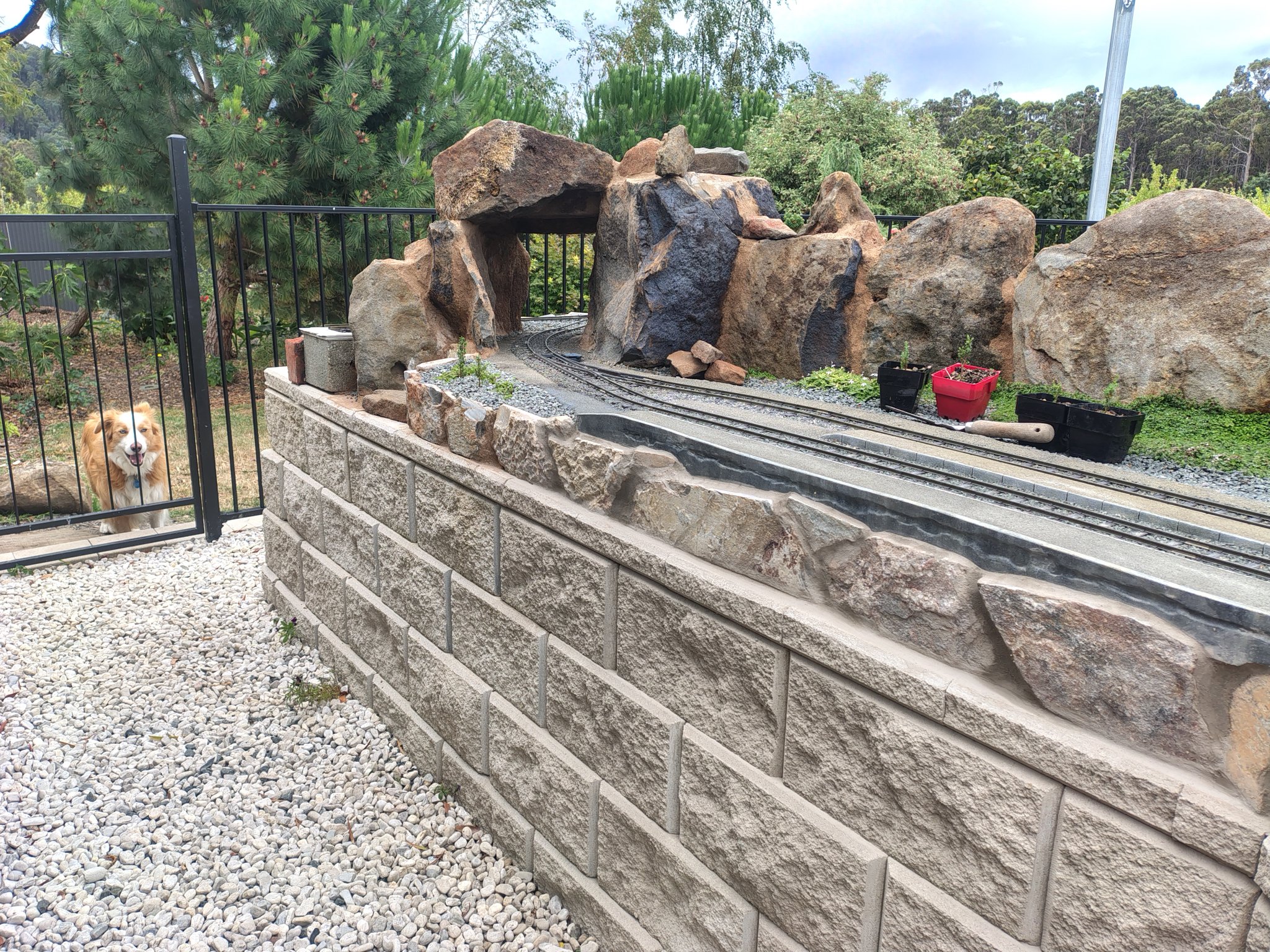

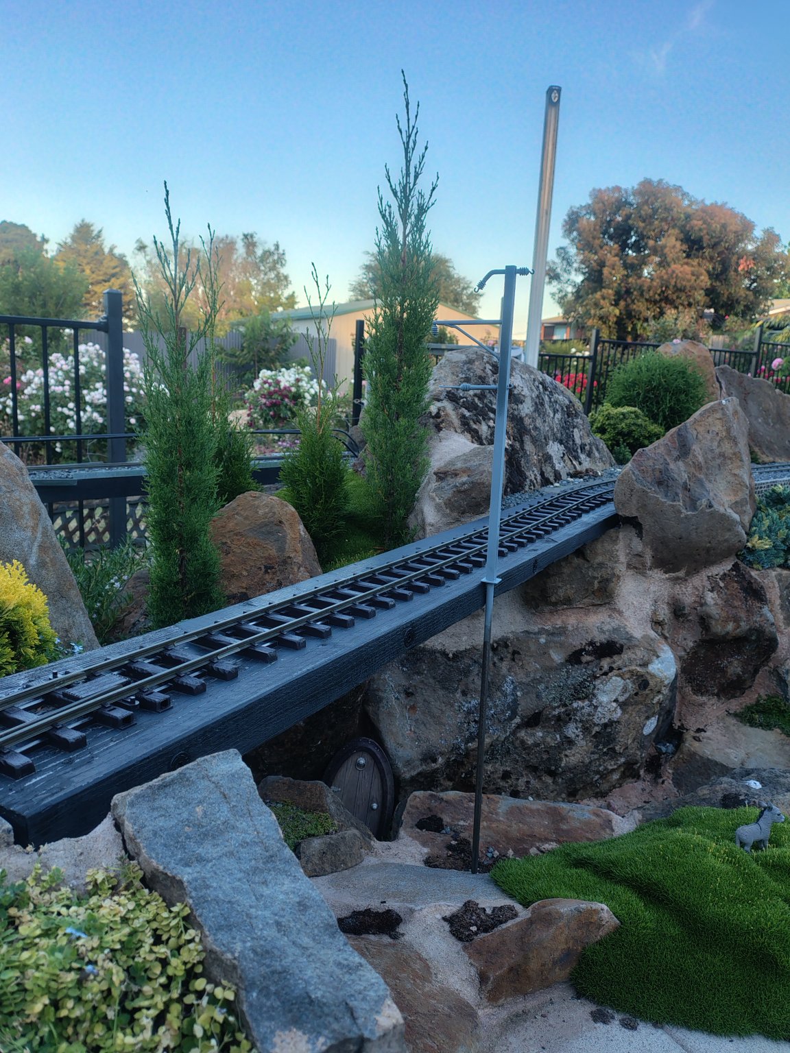

Got a little bit of work done this week, got some small rocks glued in around the bonsai yesterday. The bonsai can just lift out for maintenance.
Plus the grouting done in this bit today. So close to the end, but I run of grout. Oh well there's always next week.
A few dwarf pines, some baby tears and the bit of path from the platform in too, almost finished this corner. Not including signs, signals, catenary and ..... you get it :D
Next will be the tunnel entrance to neaten up and a fence to stop passengers on the platform from falling off the edge of the world.

Lovely to see Dogo.

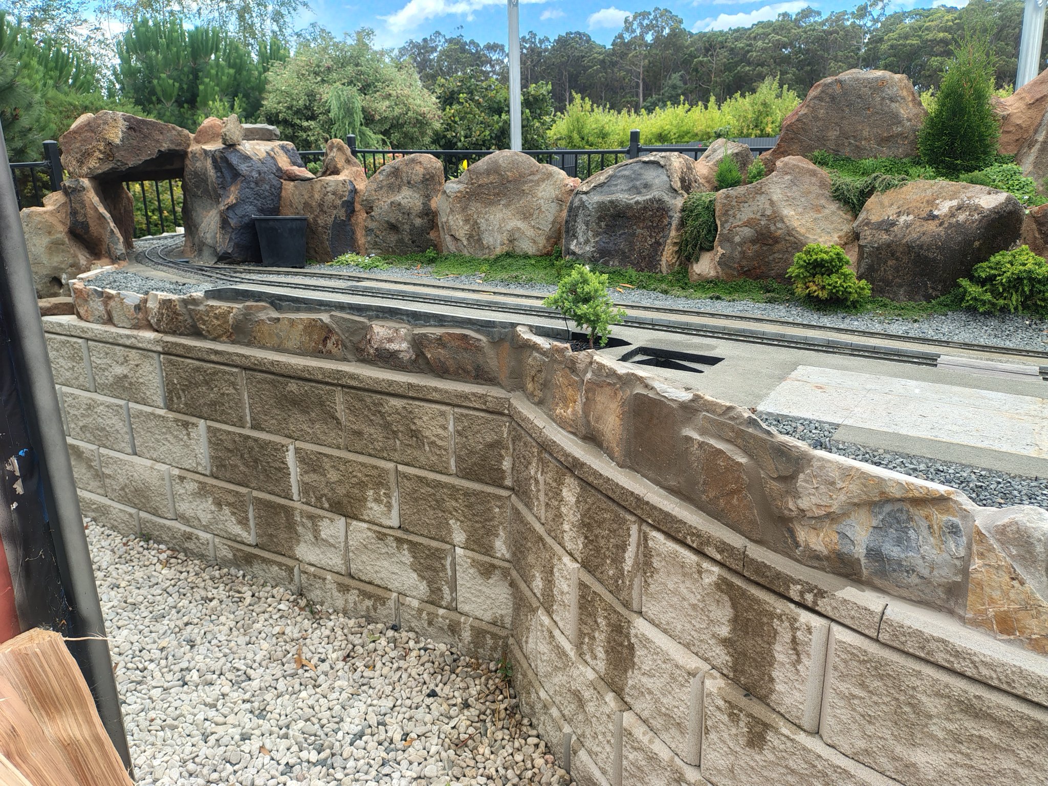

We had some issues with a tunnel mouth on the Ruschbahn. Andy in his wisdom had made it out of some old ply that was kicking about. Well I can guess you know what happened and who was detailed to fix it!
So muggins thought long and hard, solution was to put some protective plastic down on track and ballast, then spray wet the tunnel mouth ply and throw Postcrete at it (wearing neoprene protective gloves of course) another spray of water more Postcrete then leave for a few minutes to repeat the process till a natural ‘cut out of the rock’ tunnel emerged. Benefit of this process is that the concrete mouth will stay in place once the wood has rotted away. Thinking it out further from a build new perspective, some concrete mesh cut to a tunnel profile would make a stronger tunnel mouth using the same process, ply behind still. Seen here with the LLB train passing back to te garage after a days operation. The 2 mouths got the treatment.

Lovely to see Dogo.

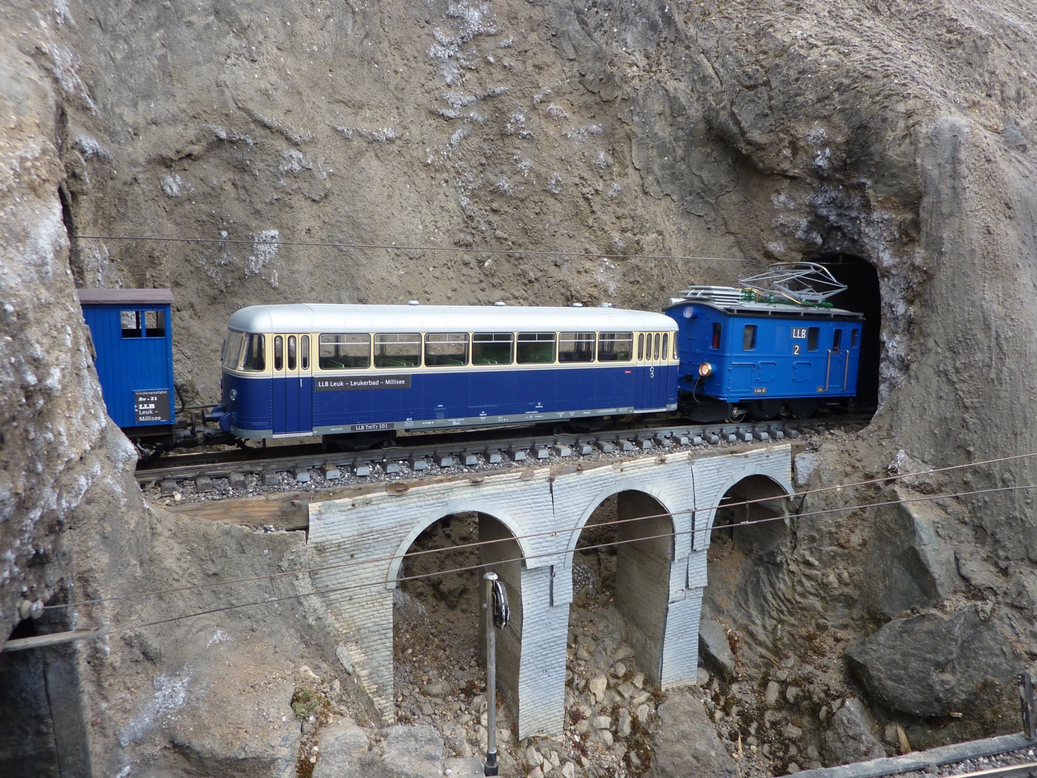

Looks great, shame the cladding was peeling off the viaduct. Otherwise there is some really great modeling there.
Sounds like I would maybe make a big mess trying that way. It does look good thou.
I was thinking of cutting a portal out of foam detailed like the retraining walls i have made. Cut to match the profile of the rockwork.
I still have a couple of rocks to cement in next to and above tunnel to make planting pockets for even more dwarf conifers.
I will give it some more thought before I proceed, thanks for the info.

Indeed tis a shame about the stonework, was Plastic Sheet stonework that did not last the test of time. The pic was taken within a year or so of Andy’s sad demise and closure of the Ruschbahn. Was likely on my list of fix jobs, would probably have got a similar treatment as the Tunnels but with just a splash of external PVA and one throw of sifted postcrete. Though with the benefit of knowledge your methods, had the Ruschbahn still been in existence we would likely have gone that way.

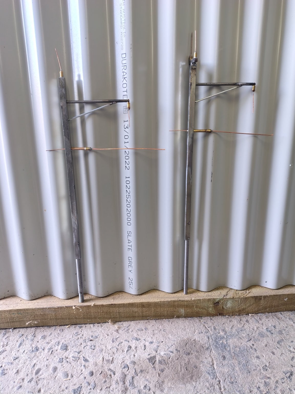

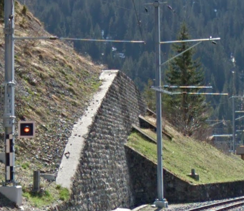

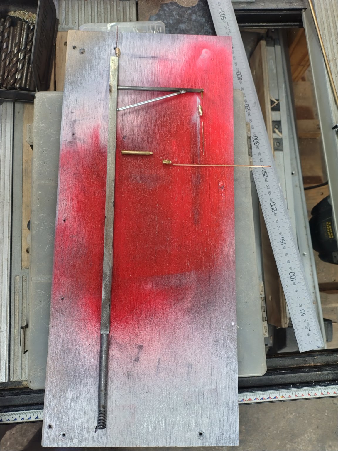

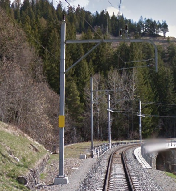

Looking at that picture again, I really like the catenary wires. The finer gauge droppers joining upper and lower wires looks great and very prototypical to my eyes.
Also I am guessing being soldered at the bottom only would make installation easier.
There seems to be a good tension on the catenary. Looking forward to learning how you tensioned them and allowed for expansion/contraction. How long a sections you worked with. Not having tried I was guessing 3-4m lengths might be manageable and not have too many joins? No idea till I tried thou. Plus how you joined sections of wires and branched off at junctions. Don't want much do I:rofl:.
I think I have a workable installation plan formulated.
I have watched the Ruschbahn video's on youtube many times looking at the fine overhead system. Gives me something useful to do when I can't do other stuff.
Oh much to go at there!
First a plan of how it was going to be done was created and poured over for many hours.
I made the lengths of wire as long as reasonably possible, on the main station the full length of that station no joints. Lots of bendy R1 curves will be tricky for you. That was from the yard by the viaduct to the tunnel the other end of the station. Luckily the plan for the station was quite precise with 2 wires the full lrpength the outer 2 ending at conveniently located poles.
Joins where we had curves involved ‘pull off’ sections where a shorter wire would have a new or existing pole to pass between. Note LGB pans cope happily with one wire over the other.
Tensioning was done with fence tensioners but this not the beast, I wanted to use hidden wires over a wheel at the ends with tins of weights to give a dynamic wire tension so that heat or cold would not make a difference, this rejected by the owner. The wire was in full sun all day in the summer and odd problems ensued, but nothing catastrofic.

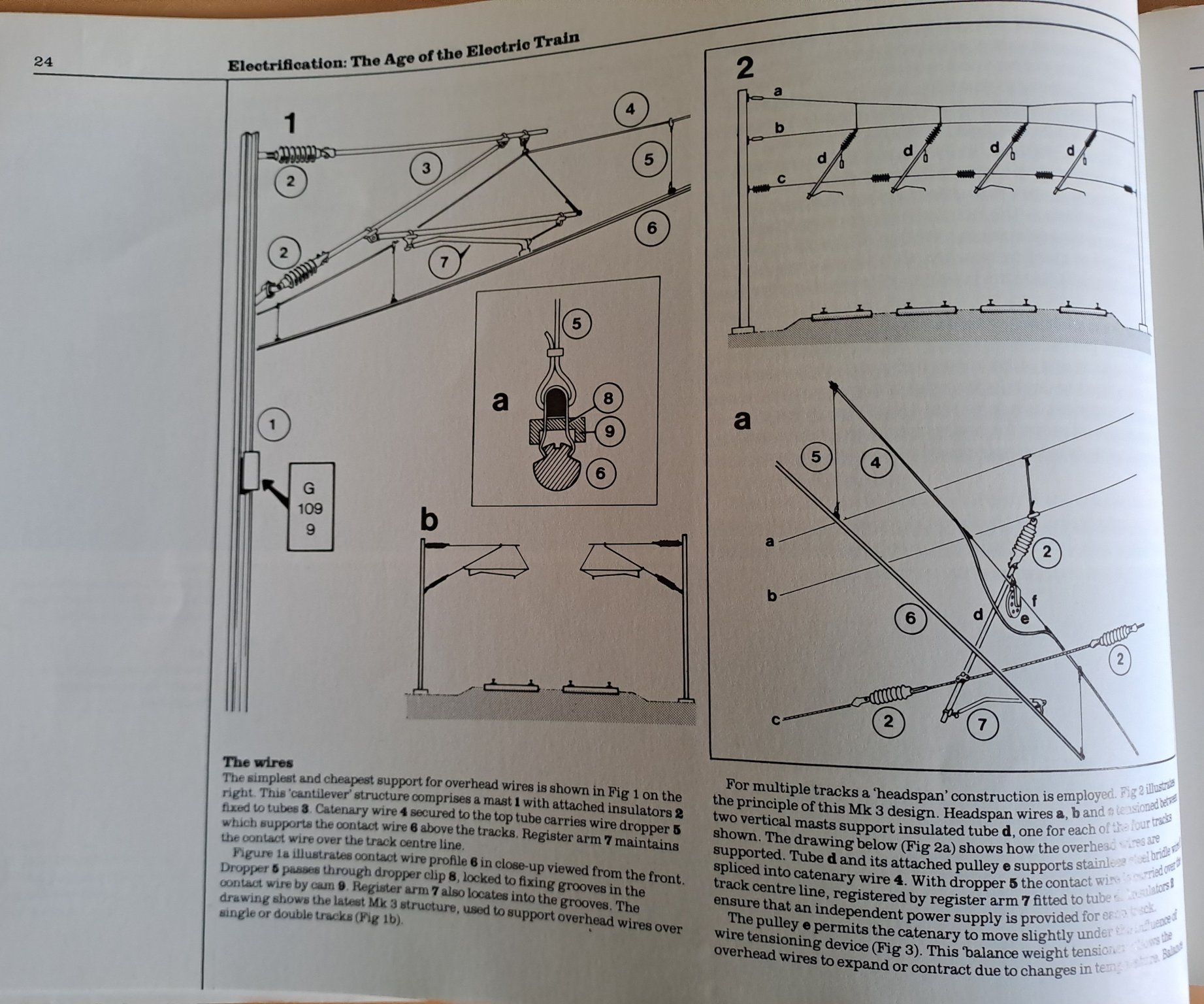

I have tried to give an idea how the system works below, the main wires are in red with mostly track below except where the odd cross wires (dotted) which mostly represent crossovers though in some cases link wires. At the bottom you can see how flexibility has been allowed by the small loop going over a cross wire and soldered to the contact wire. Sortybtis a bit messy, my house in uproar at the moment with the loft entered for a replacement set of roof tiles, Rushchbahn Manual cant be found! I have tried to represent the main station by the lake as well as I can remember.
