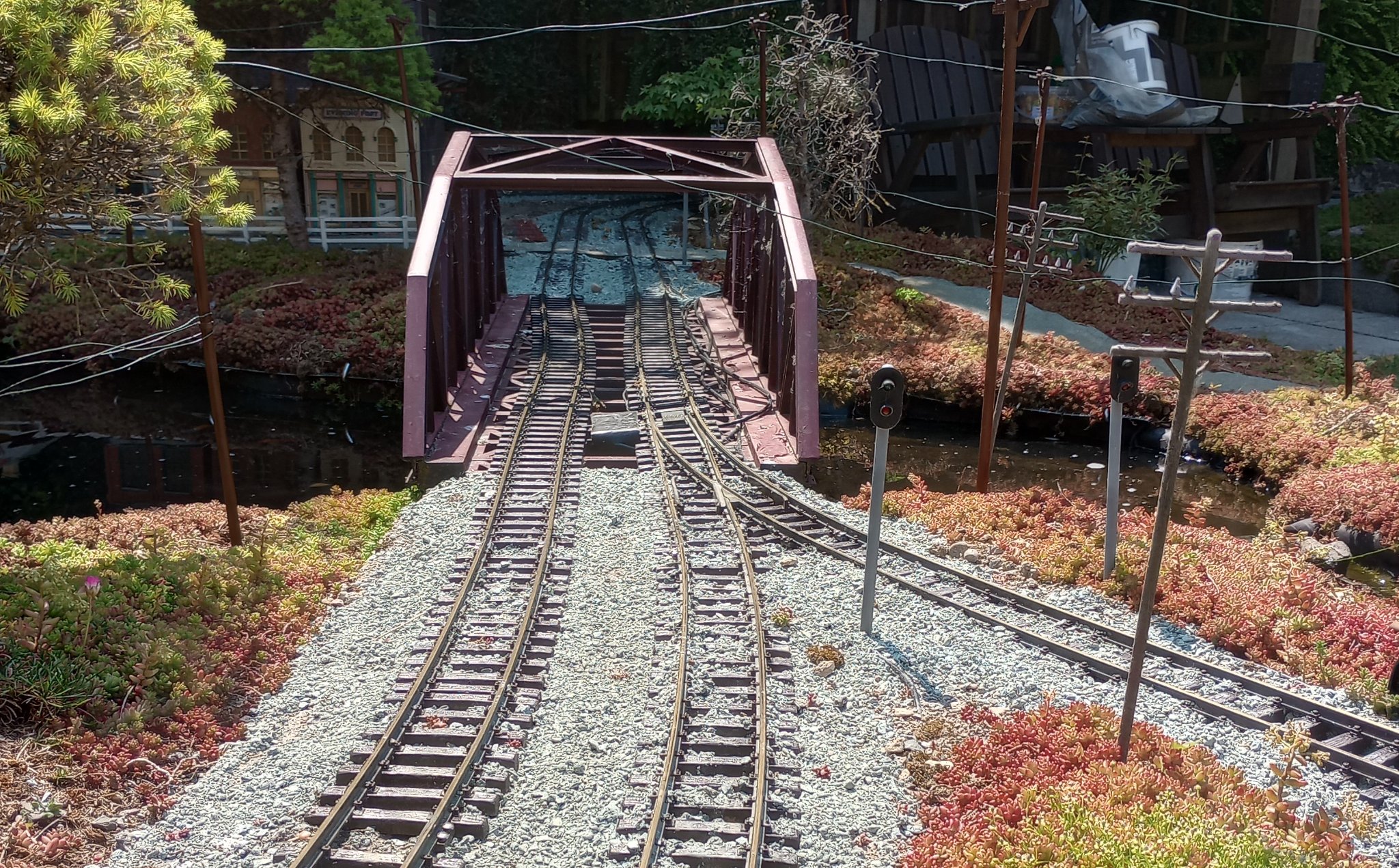

My expansion problem was because of the Massoth track clamps.
The expansion was concentrated where the track was not ballasted.
Photographic evidence of the distortion across the bridge doesn't lie but the trains still ran fine -

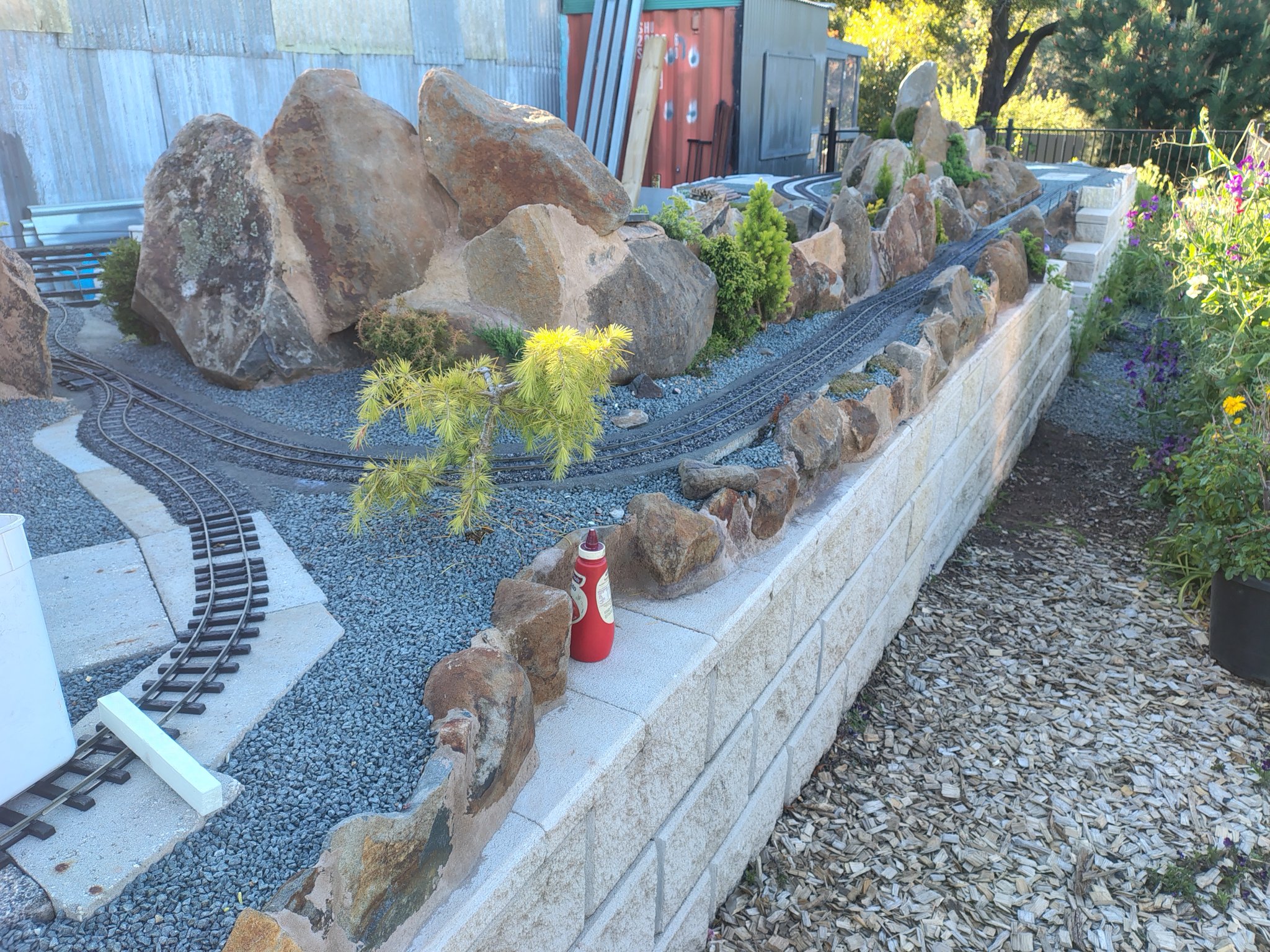

I decided to a bit more ballasting, so this section can be finished
I also chipped the rock wall off the track base here, so that I can fit a Foam retaining wall instead.

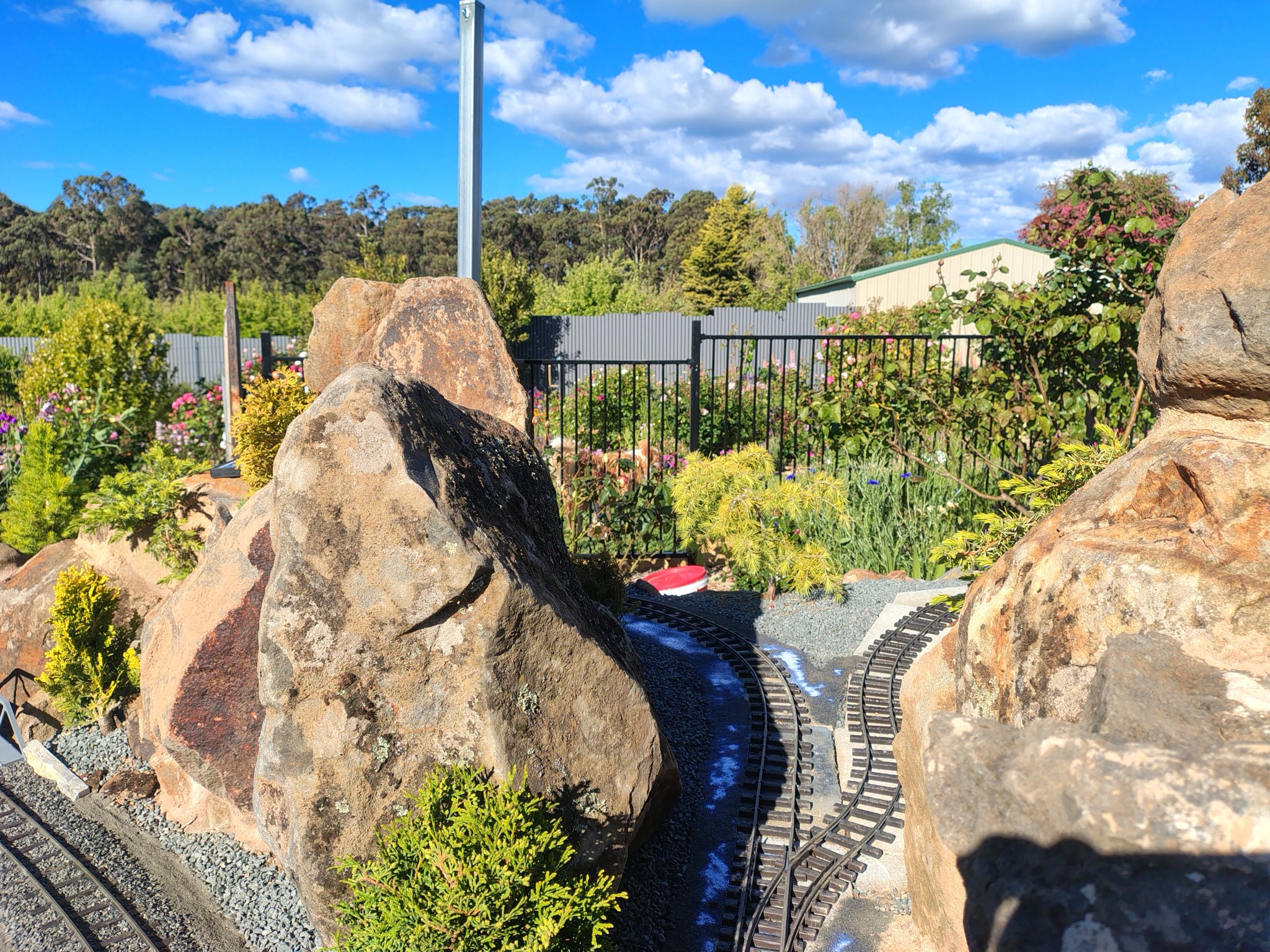

No work has been done in the last few weeks, but it was a nice afternoon to run a train.
Video pieced together of a lap around.

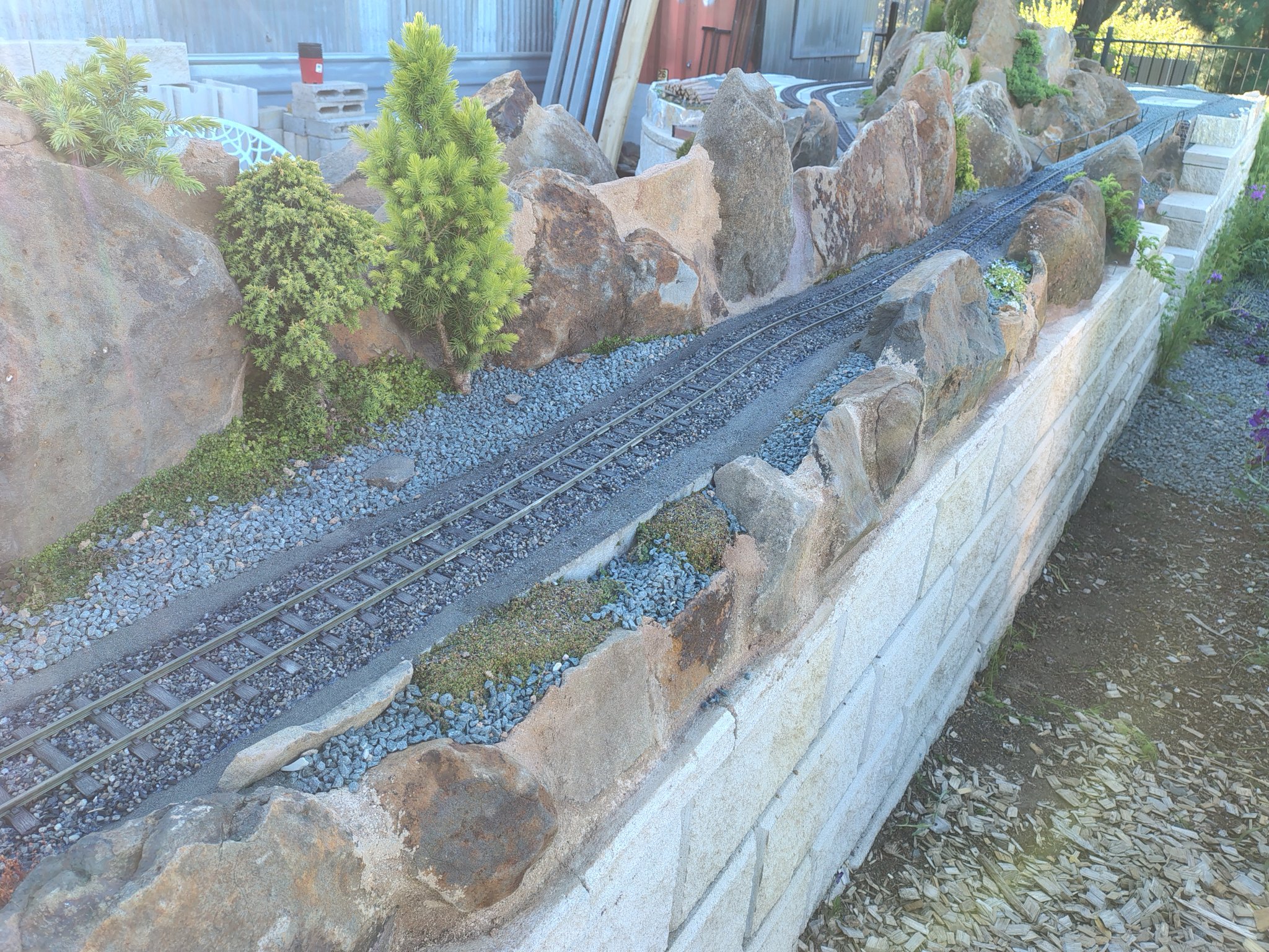

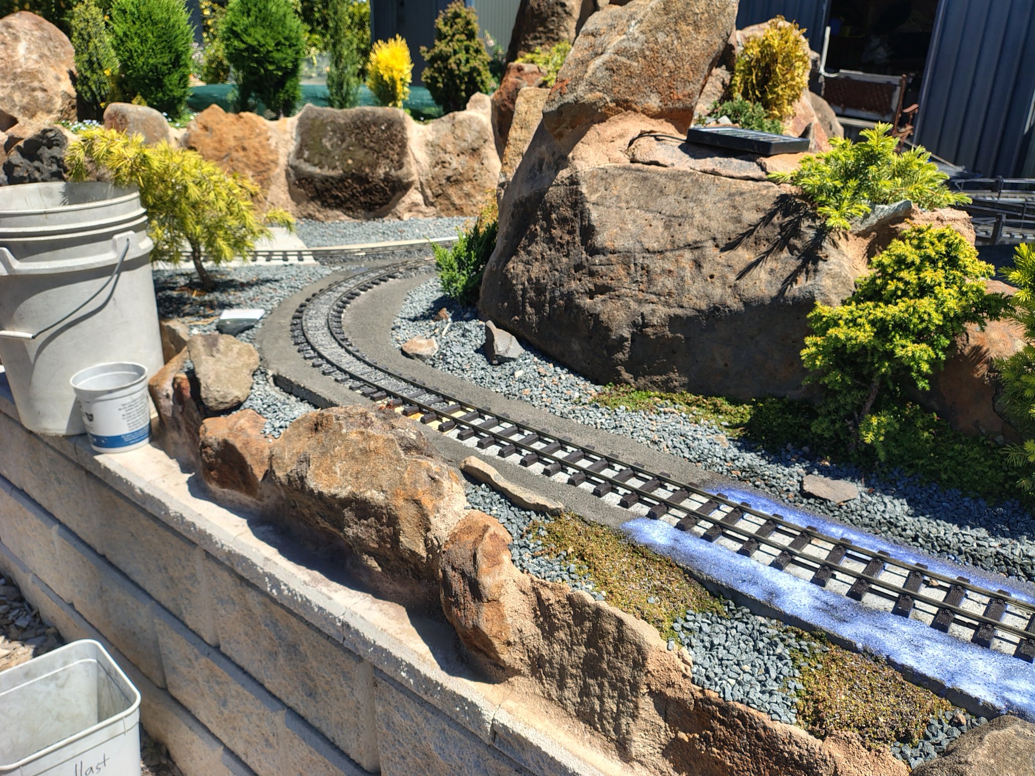

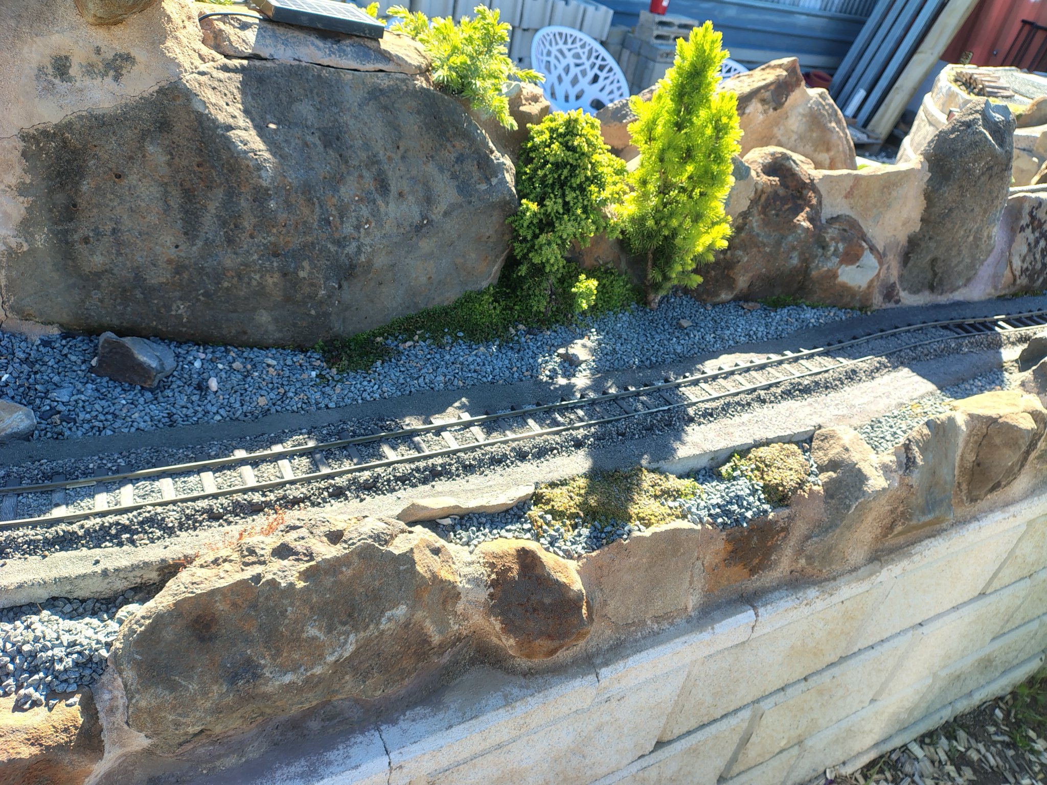

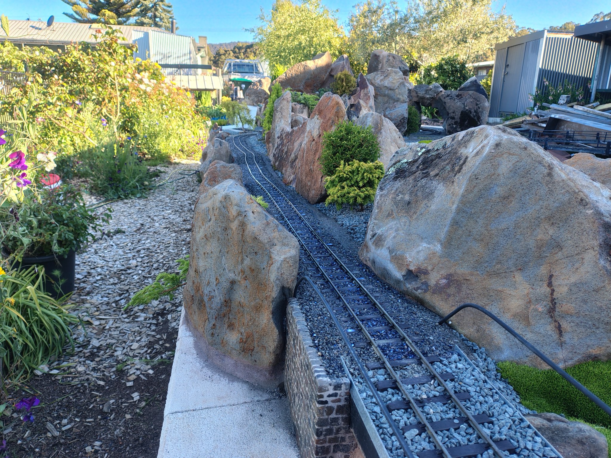

We finally got a few dry warm days, after what has been the coldest wettest end of spring we have had here in 17 years.
Perfect for ballasting which while slow to do, I found it quite enjoyable. Might of just been being out in the warm sunshine:).
I did a base layer of dust to cover the Besser blocks and get rid of the angular edges first.
I left a few straight edges for a few low retaining walls.
The join from permanent to temporary ballast.
As I was progressing along.

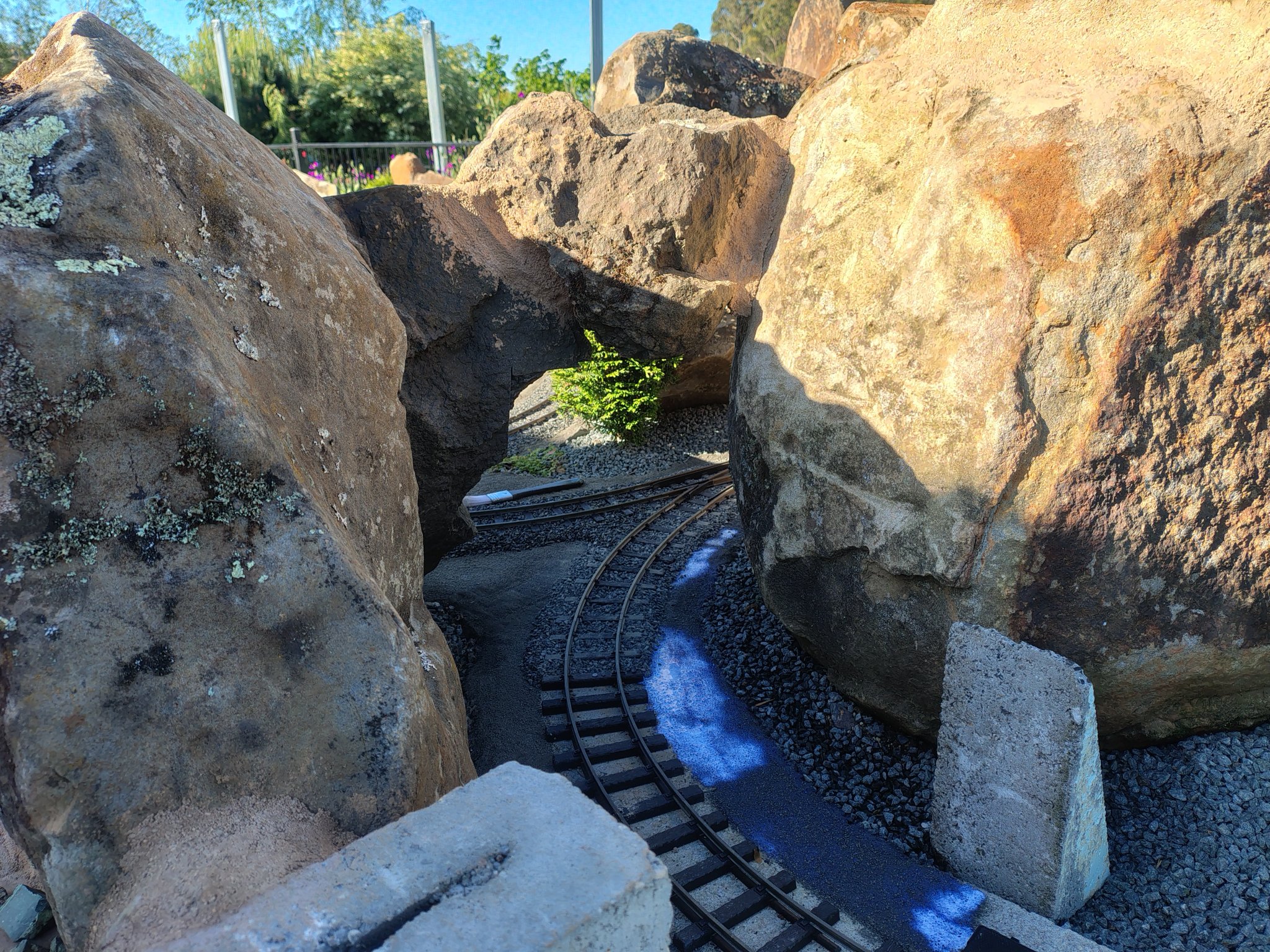

Walking Doggo at the beach today I found a section of beach that had the sizeable drifts of small rocks 2-4mm brown rocks. I will liberate a few buckets worth and soak the salt out. I will then remove the cheap grey pea gravel along the trackside and replace it with the beach rock over time, I think it will look much nicer.
I left the rest of the siding as I will do that after I have finished the cement plant and surrounding area.
Finished product, should be dry in a few days. Whilst probably not too prototypical I think it looks much better than the bare Besser blocks.:)
This section was done watering the glue down 50/50, I tried a small test section weeks ago which seems just as solid as the slightly watered down mix I had used on the other sections.
Time will tell if I have saved money or wasted time and money if it needs doing again
