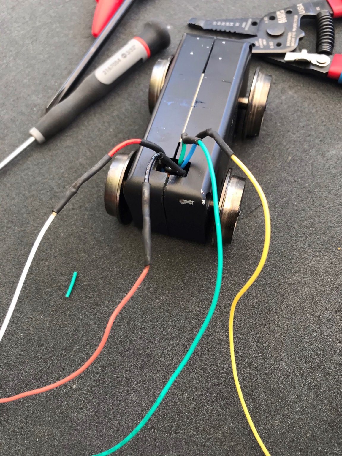

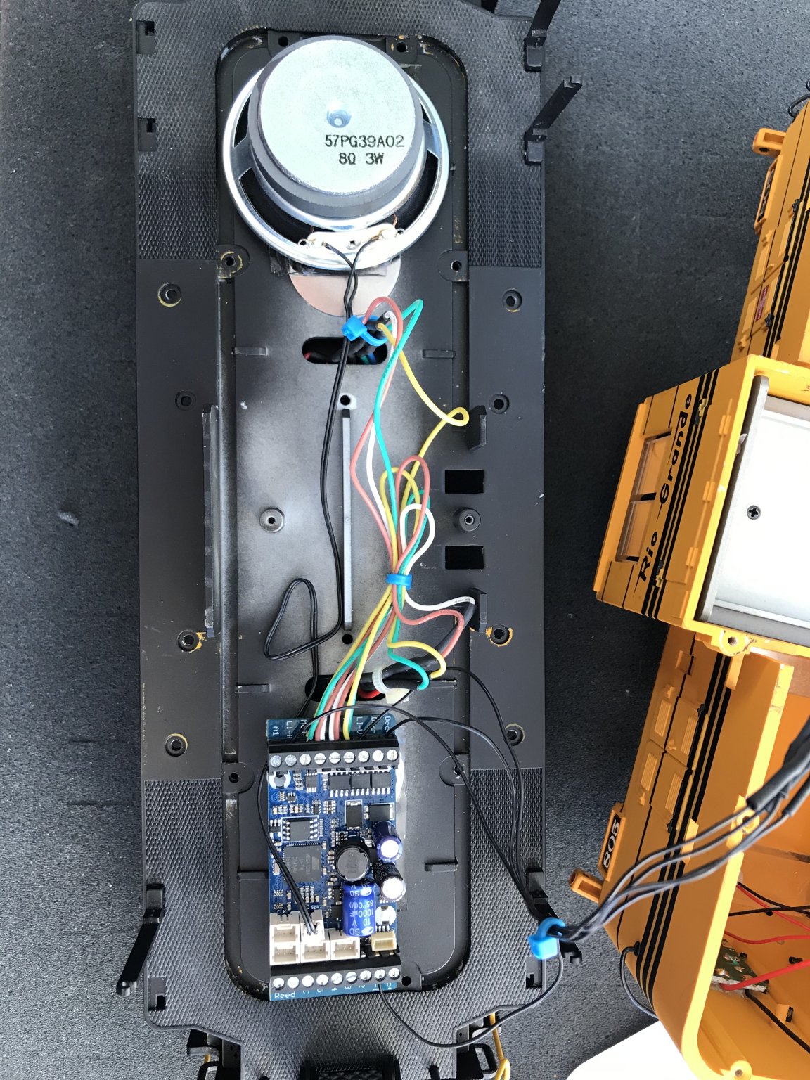

Hi,
I have a center cab that I wanted to convert to DCC using a massoth XLS decoder. When I dug into it I found that the motor and track wires seemed to be isolated. I used a jumper wire to connect the two blocks and was, I thought, careful to make sure that the motor and track leads were connected properly. When I did a continuity check of the now connected blocks the motor wires show continuity but the track contacts did not. I thought perhaps to complete the circuit it should be on the track. When I put it on the track the central station says there is a short on the track. So, does anyone know if the track wires and motor wires are actually isolated on this engine or am I completely overlooking something else? I found the girr.org site that had a lot of helpful information about this little engine but, I've still managed to muck it up somehow. This is my first attempt at anything this ambitious as up till now most of my mods were plug and play type projects. Thank you!
