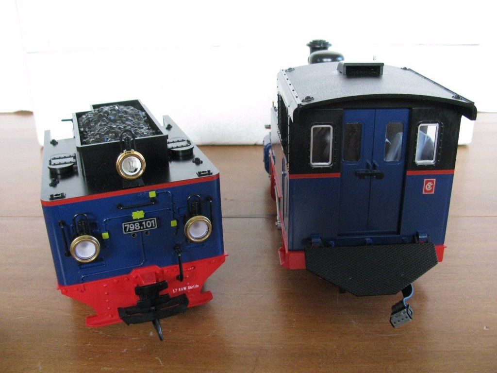

It's a question I want to ask at the moment. The plate that bridges the gap between tender and cab - drop plate - would that normally be hinged to the loco or would it be to the tender? I just need to know before I fix the floor in the cab.:wondering:

This suggests that it's hinged to the cab, but on a custom I'm working on very slowly, I'm going to have a drop plate fixed to the tender (which is, of course, an oxymoron).

Judging from this photo, the drop plate is hinged to the loco

Thank's Chris & Jon - it's amazing what I've never taken notice of before! I'm just on with the rear (draw) beam and needed to set the cab floor height to allow for the light connection plug (into to the PCB) - the beam needed to sit a little lower than the floor. I thought I'd disguise this incongruity with the fall plate.

I'm now thinking that I'll get away with a fixed drop plate if I alter the pivot point for the tender and taper the plate sides like your pic - although this will be a lot narrower of course.

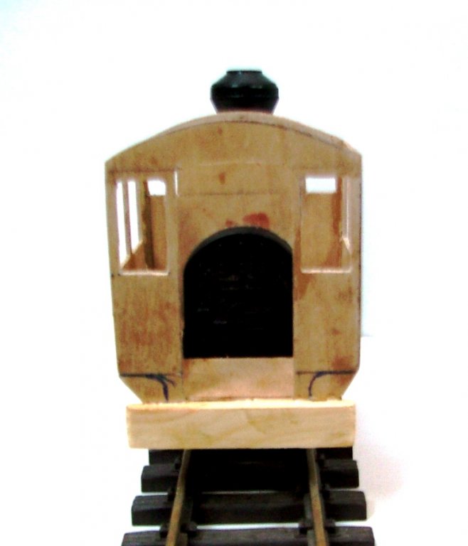

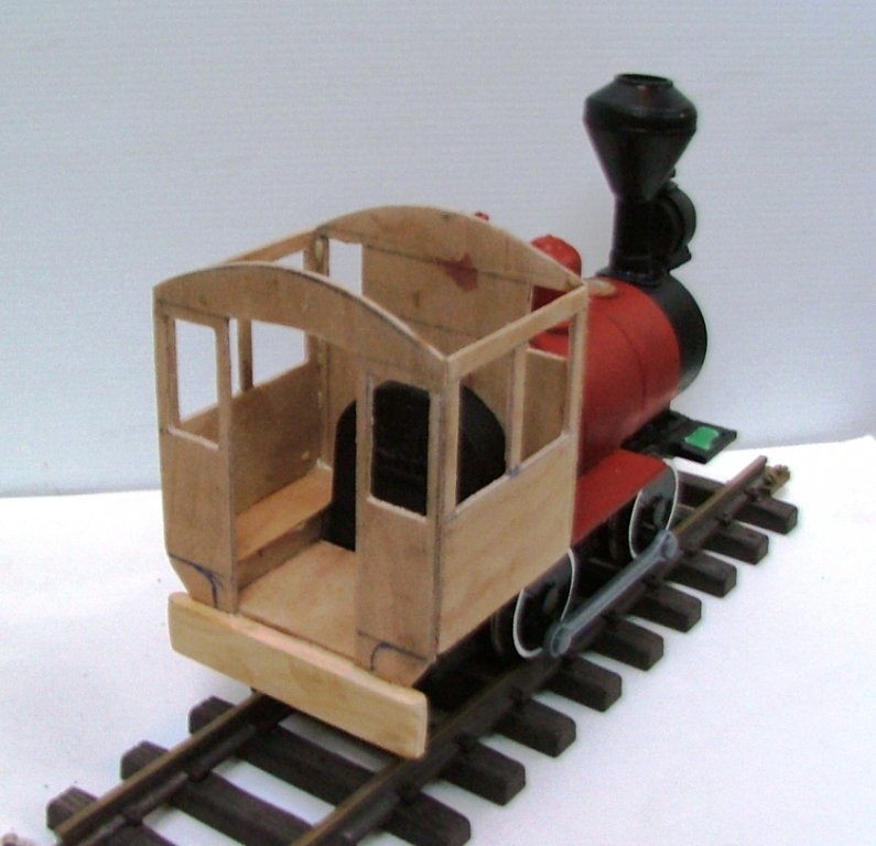

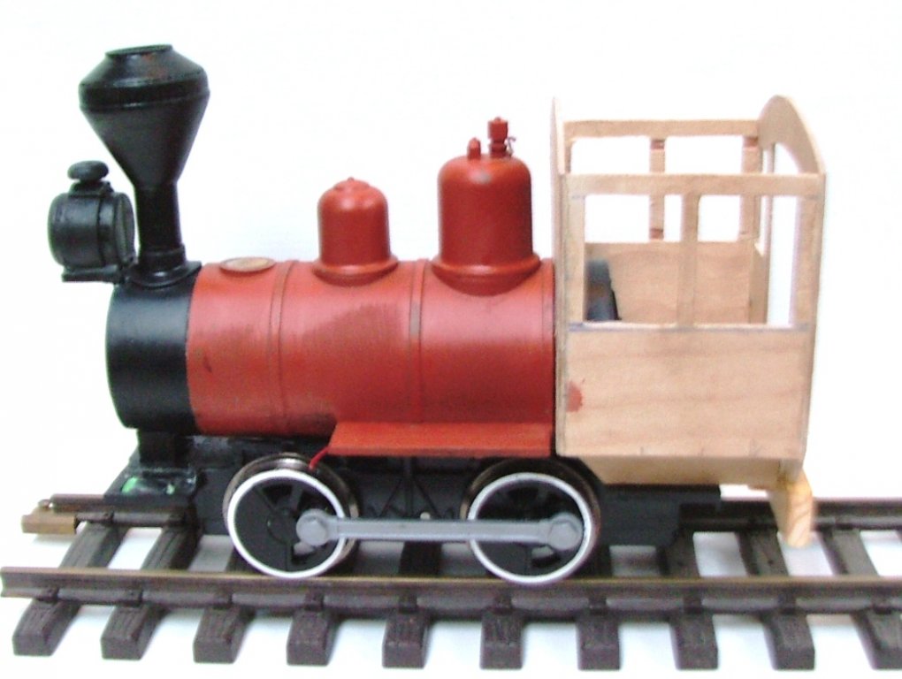

Well I seem to be getting somewhere at last - changed to wood for the cab. Pictures are of the carcase of the cab (towhich various strips of wood and beadings will be added.
The inside needs painting before I make and fit the roof.
The red colours on the wood are type O. The cab rear is only imagined - as there do not seem to be any other images of tiny loco - the doodling will go when painted:(

Phwaor, a lot of blood on the boiler as well :eek::eek::eek:

Ah, good, Mick's back into his stride and all looks good.

Way to go Mick;),any cab interior details going in before the roof goes on?
