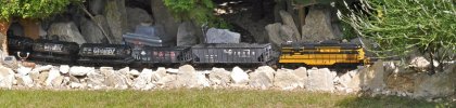

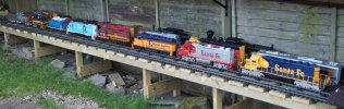

The USA Trains diesels are not DCC ready but are well detailed, run smoothly and pull well. I have not had any grief from my fleet at all. They have had plenty of running over the past 14 years since I started out. Some detail parts can fall off but are easily put back on. If something is completely lost spares are available from USA Trains.
I am not so keen on Aristo, especially after the gears stripped on my GP40, they are noisier, earlier models are not so well detailed and of course replacement parts are not available.
Some of the fleet
There are some replacements parts now from GLX in Ottawa, Canada More will follow I am sure.
