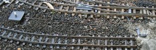

So when I built the new station building it went back to the back, with the same TT access problems. You can just see the TT in these two pics from opposite directions
But I finally decided the TT had to go and I just covered it up and built a goods shed on the site.

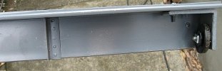

First, I built the TT bridge to determine the height from the TT base to rail (55mm -0/+3mm ). The TT bridge is a couple of bits of 2”x2” plastic angle and 50mm square wood, running on nylon wheels with a 3/8” pivot. Nothing fancy – just practical, and no track power needed
