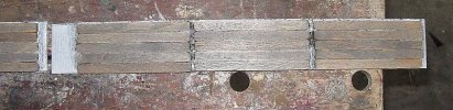

Most branchline station platform facings in Australia were constructed of timber, like this:

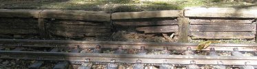

Later, in the 20th century, platforms were made from old rails mounted vertically, with precast concrete slabs slotted between – like this
I copied the timber method for my Melaleuca station, using treated pine timber, back in 2002.
Just like the real thing, mine is rotting away, and while it`s prototypical, the time has come to replace it.
The new (rear) platform face will represent the newer concrete type. I drilled holes in the baseboard and fitted pieces of plastic rail at approx 120mm spacing and 50mm high.
I then cut 3mm thick styrene into 15mm wide `slabs` and slid them between the rails
This should be rot-proof!

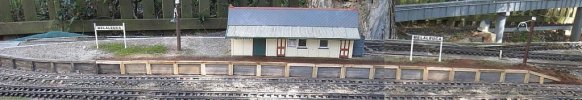

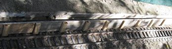

Next I used 20mm angle (some plastic and some aluminium), glued to the back of the facing, to give some strength to the overhanging capping.
Then 6mm thick plastic (cur from 50mm x 50mm plastic angle), 18mm wide to form the actual capping. This was glued into position after much checking for clearance to my longest wagons.
The glue I use for all this work is Fullers Ultra Clear Sealant. It`s not really a glue, but it`s like a very thick PVA glue – white to start, dries clear and is water washable.
I used styrofoam to fill part of the platform volume, some fibreglass flyscreen for reinforcing, then use concrete to fill up to 1cm of the top, then used a mixture of sand-cement and decomposed granite to fill, giving a rough surface. I `mashed` some moss I had recovered into the surface to hopefully cover the surface with `grass`.
