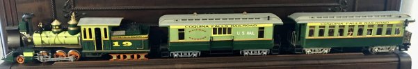

I used a LGB spreewald one for my Mason Bogie, and now fixing to build a 2-6-2 saddle tanker using a mallet 2085 motor block, and used a mogul one to build my prairie 2-6-2 out of a shortened big hauler2-6-2 prairie LH side w-tenter.JPGMB complete 2.jpgFS 2085 front motor block assy.JPGMB complete 2.jpg2-6-2T.jpg
