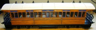

Have to say that I do like working with wood. Something satisfying about using the real thing to create the real Model. This coach was built when I had interest in Irish Narrow Gauge Railways, it is based in a Tralee and Dingle Coach. The LGB Bogies let it down some sadly leaving the Coach sitting a little high to my eye, but it runs and looks fine at the end of the TnD Cattle Train I have also built. Fairly thickish Ply was used for the Base with much thinner for the sides and end partitions. The Partitions do give a lot of internal Strength as does the varying uprights from Square Stock (Siding to our US Friends). Fine Veneer was cut up for much of the detail, this veneer is used by Aircraft Modellers’ to cover Wings.
4D220985-9265-43C8-827C-0595A554E850.jpegF5AF407A-2CB9-42E1-8C32-FCE737CAEB45.jpeg77861E33-699B-4A8F-B127-4F8F72ED2EFB.jpegAE5FAEB8-274A-479C-872F-83B6DF1609E2.jpeg
I even went mad to add Opening Doors, bit of a waste of time really but I probably needed to prove to myself that I could do it.

I've built several wooden coaches, and I must admit that Max's coach is one of the best I have seen. However, using a piece of wood that has been grooved/scribed to look like planks is likely to produce the grain effect:
The brake van was a Coloron wood dye with a satin varnish top coat. The final appearance of stained ply can be a bit hit and miss depending on the grain in the ply's surface.
That van shows the same effect - it's unlikely the railroad wanted matched wood panels! The only way around it is to use plastic/styrene or individual planks.
