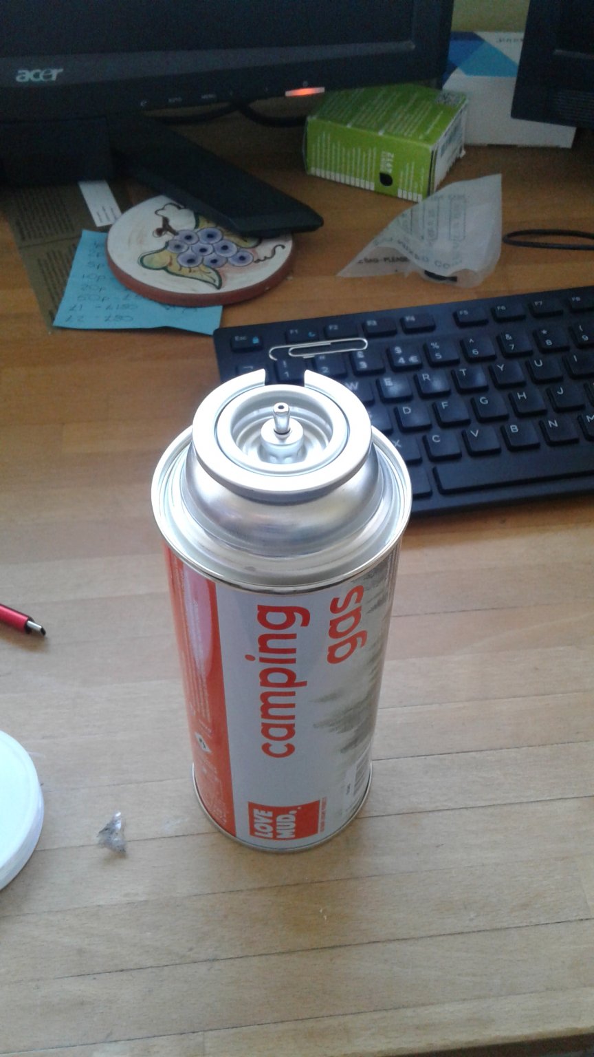

This is the sort of cartridge that will work with the above adapter, these are a lot cheaper than the screw jobbies, but may sure they are Butane as also mentioned by Maxi

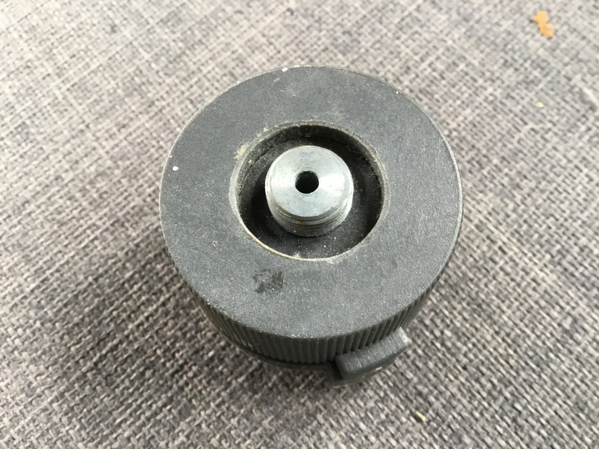

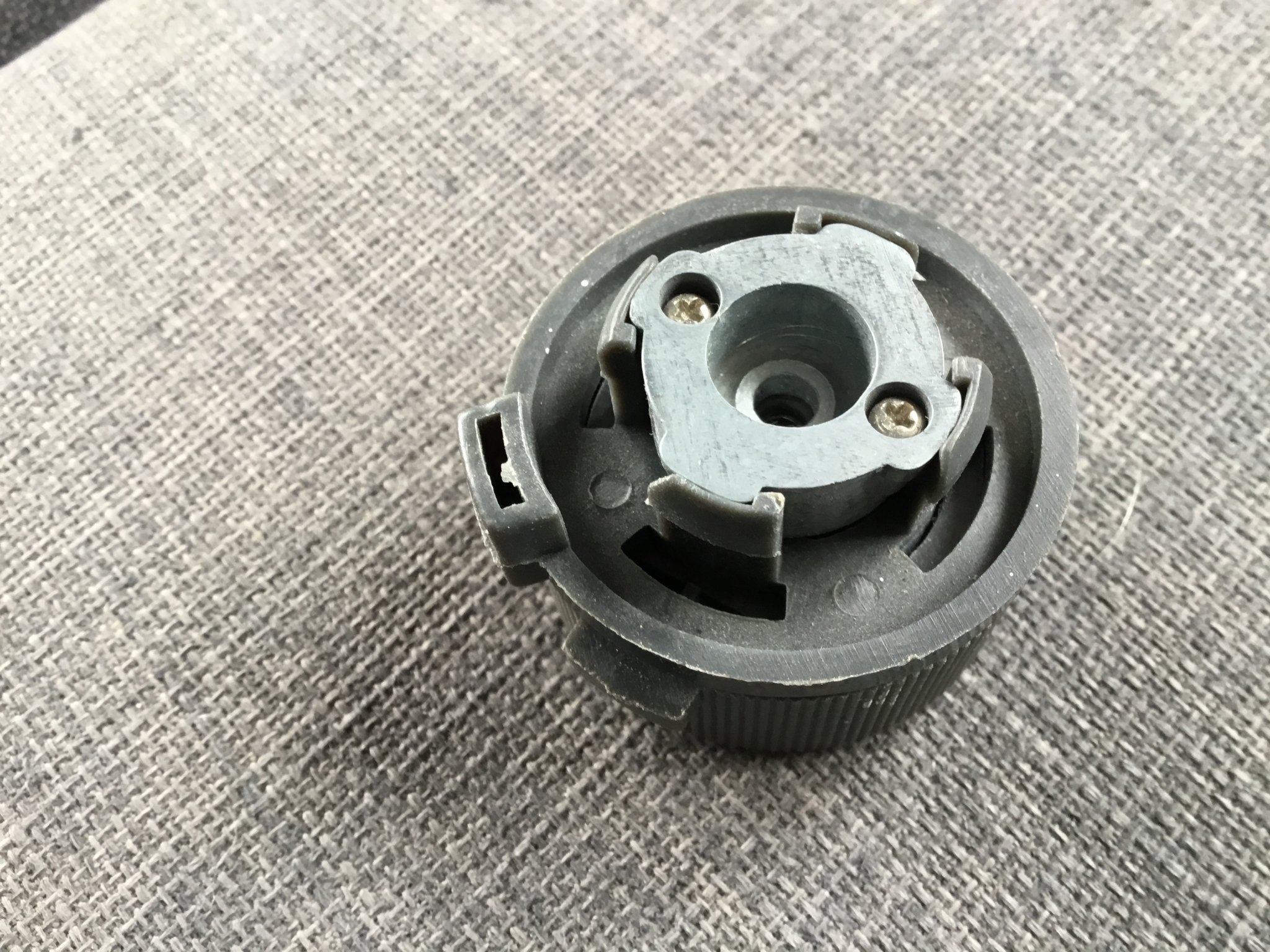

I have had this adapter for a few years now, someone told me it was what I needed for the non standard cans like you show.
How does it fix in place? Have just tested the thread on the Loco gassing pipe and that fits the ones I have that fit the conventional threaded gas canister.
F5D47673-3D7C-4D41-8C3B-6417B3298DE3.jpeg 5FFA55B1-8607-4FEC-AF90-31EA606220F9.jpeg
Alpineandy
Alpineandy
1,759
Alpennines
View attachment 269849 View attachment 269850
Fit to the can top by locating the lug so it fits flush, push down and turn the locking ring until it stops, this forces out the 4 expanding lugs and locks it to the can.
PS do it outside in a ventilated area as it will lose some gas.

I bought a couple of these from Amazon (shown in an earlier post), but i find they don't seal as well as they could do, and I can get a better fill from the can direct.
You do need to buy a good one, there's plenty of duff makes around. Mine came with adapter and pipe already combined and have had no problems
