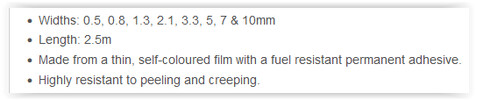

Looking very smart - I'm interested in the lining material is it self-adhesive on a roll or suchlike?Out with the trimline, which always tidies up the red/cream joint...
You're not treading on toes at all! Yes, that's the stuff. It's a bit of a luxury, as I can't see that I'll use the thicker lines, but it works well. @viaEstrecha I bought it from Cornwall Model Boats, although other suppliers are available.At the risk of "treading on toes" . . .
View attachment 336814View attachment 336815
Available in lots of other colours (and cheaper) too. See Trimline
