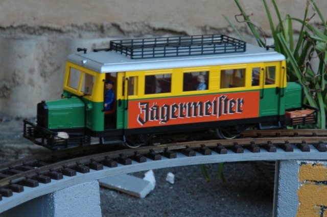

Love the LGB pig nose Railcars (Triebwagen to you?).Tram replacement service on the tram layout inside the tram Museum Wehmingen, near Hannover.
I was fortunate to be offered the chance to drive one for an hour or so on the Osthannoversche Eisenbahnen around 1982. I presume we had a big stretch of line to ourselves as at Mahlzeit, the supervising driver had us just stop the vehicle on the plain line next to a pub, leaving it unattended while we went inside for lunch. It also pulled a weighted trailer, to help trigger the track circuits and level crossing barriers.We call them "Schweineschnäuzchen:

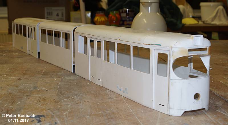

I'm sending you a link to the website where I started documenting the build. You might get a warning message. This site hasn't been upgraded to the https standard yet. Sadly, it's only in German.
Here is the website where you can find more information:
building report of tram 3818

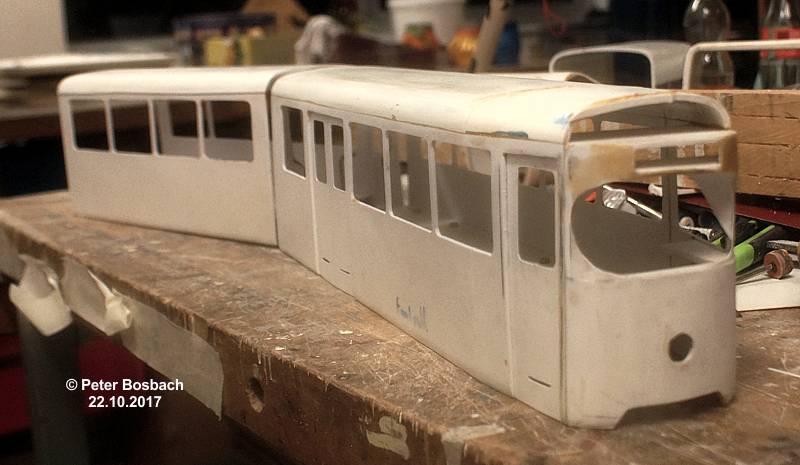

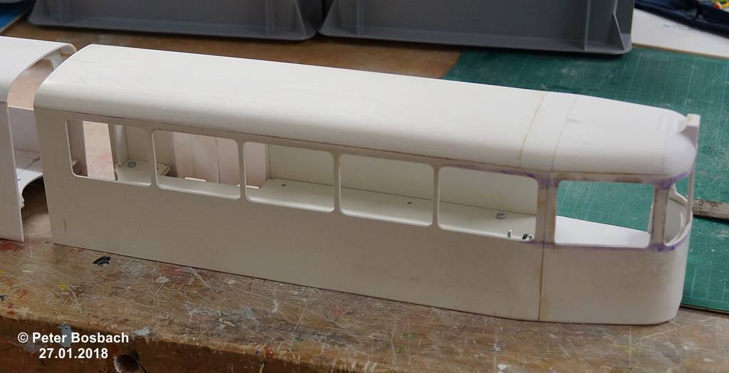

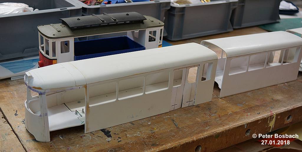

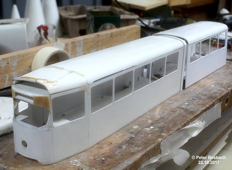

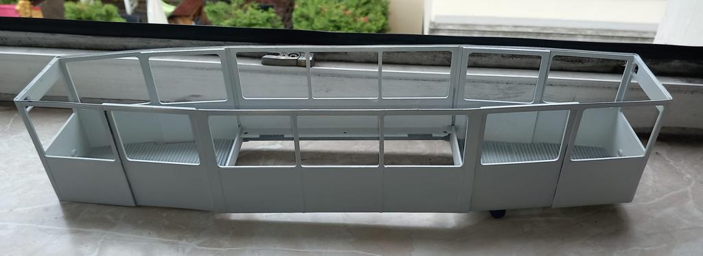

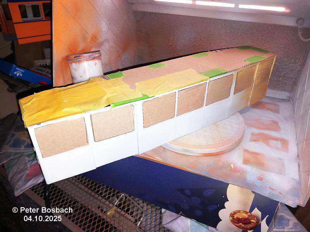

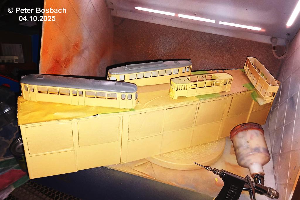

I have added the pictures of the roof again. The front and rear curves were made using 1mm plastic sheets and templates. To make it stable, I put these fronts on top of each other three times and glued them properly.

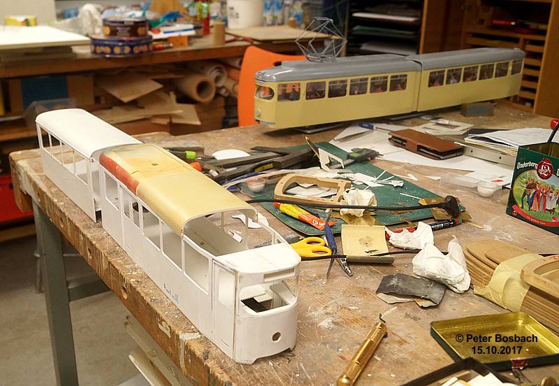

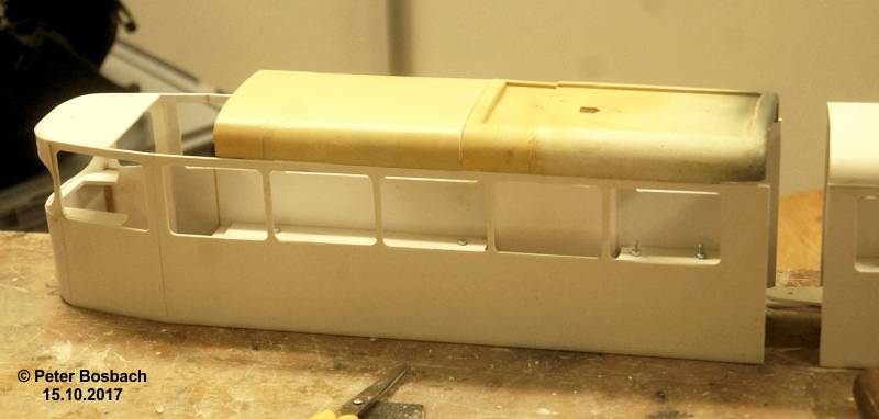

The roofs were made from old LCE roofs. These LCE roofs are the same size as my tram. The old LCE was in really bad condition and didn't work. I cut the roof at the ends so that I could use it to fill in the round parts, as it was 2.5 mm thick.
I will build it without the advertising.
The balsa wood is too soft, which is why there are sometimes dents in the roof.
The holes are filled with a two-component adhesive and the parts are glued together.
The roof was also installed in this way at the end.

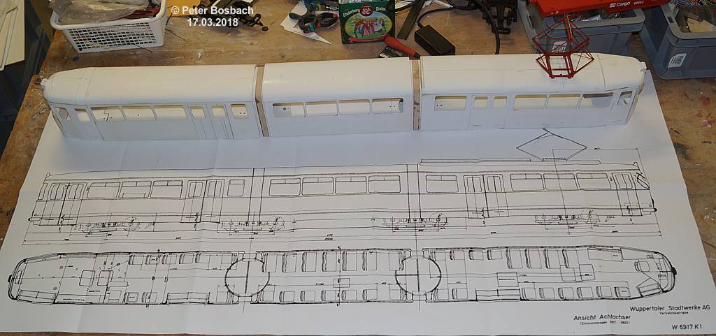

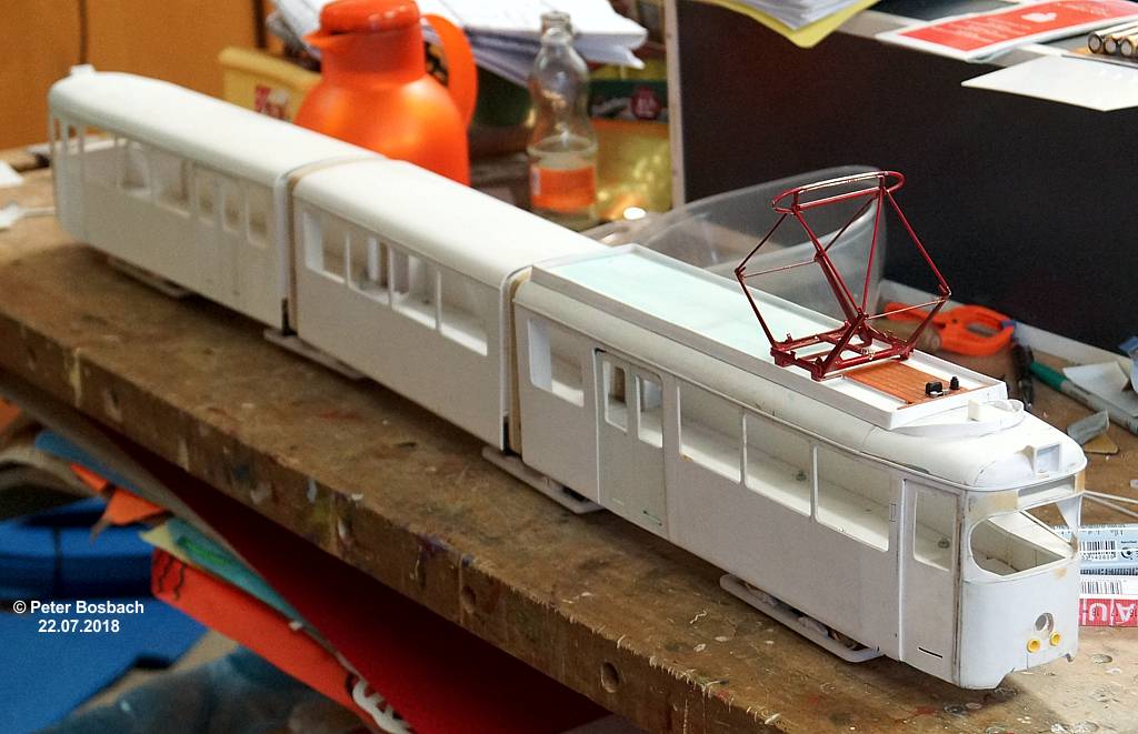

I have scaled a drawing in 1:20 to 1:22.5. This way the drawing fits the car and I can take the dimensions directly.
I will also build the roofs for theKSW trailer in the same way.

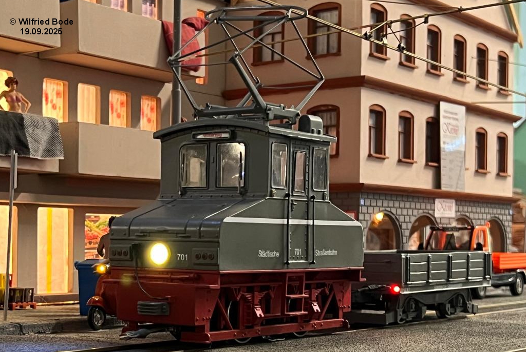

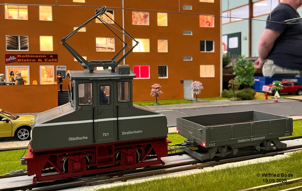

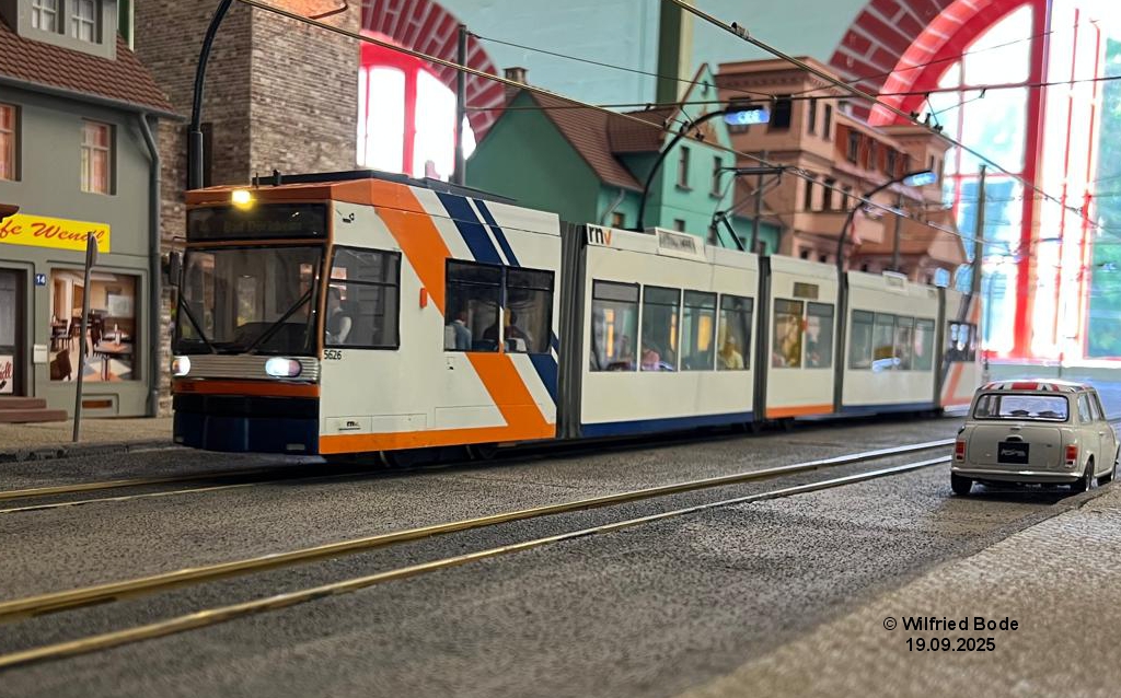

Not rallye. It is a freelance loco. My Friedrich said it looks like a Wuppertal ohne.
Not really. It is a freelance loco. My friend said it looks like a Wuppertal oneThis image strongly says pre-1980 Wuppertal.
