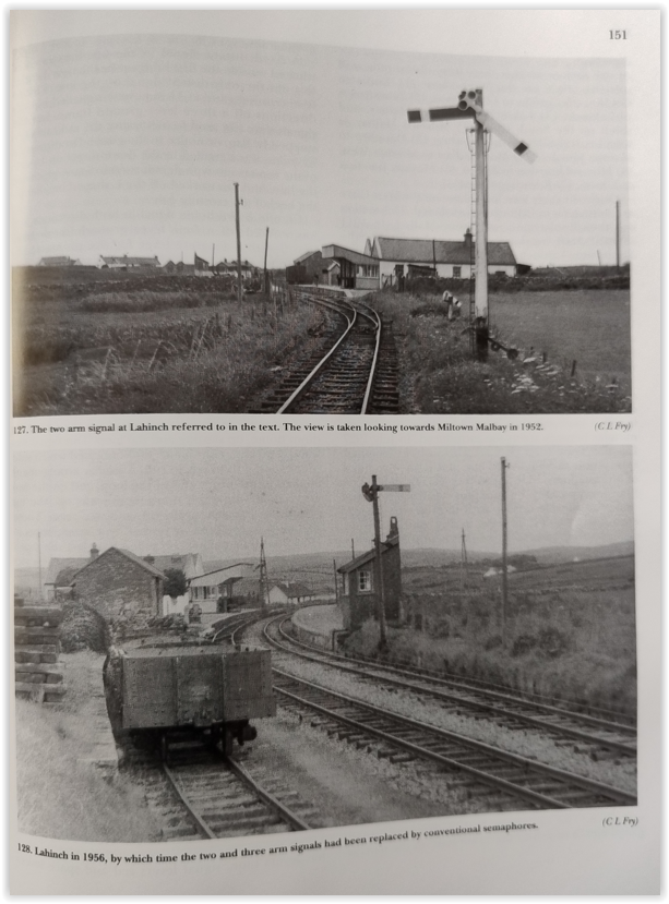

I think I recall you saying you were loosely basing your line on the West Clare Railway.
I have the Plateway Press "The West Clare Railway" book by Patrick Taylor and the two photographs in the "Permanent Way and Signalling" chapter, particular the upper one, suggest the answer to your question is "yes" . . .
(i.e. they do have to be to the right or left of the track!!!!)
Hope this helps
That first photo could only be in Ireland :clap::clap::clap::clap:

As a rule signals would be to the drivers side of the line but clearly with that double arm there are exceptions, in this case the fireman would be asked to confirm the signals aspect. I believe in any case fireman can be expected to assist with signal setting. Arm would generally be pointing away from the track with the post nearest. But again some exceptions.
Probably correct for BR mainline; however, photographic evidence for Irish narrow gauge suggests .................... that anything goes :rofl::rofl::rofl:
