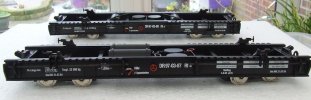

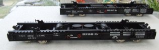

To cover the rollwagens themselves first: they are all hand-built in mixed materials to what i would consider a very high standard. Some parts are heavy gauge CNC-cut plastic (such as the main long girder frames on which the loaded wagon sits), others are metal castings (most of the cross-frames and braces, the wheel chocks for the load and all the fine detail work). I asked for two different wagon numbers, and got not only that but actually two slightly different models (which was fine by me because I like the variety, but others might choose to specify which type(s) they wanted); the two differ in the placement of the air brake tanks within the rollwagen frame, with one having the tanks sideways across the frame and the other mounting them longitudinally. The cast metal wheel chocks "work", in that you can swing them outward and slide them along the metal rod to the desired position, then swing them up to lock them in position.
Both rollwagens came with very nice free-running metal wheelsets, which I had specified as an extra - the basic default is plastic wheels, but I would say that the extra cost for metal ones is well justified. Do be aware that you CAN'T easily swap the wheelsets around, as they are built into the bogie frames - so if you think you might want metal wheels then order them at the time, don't expect to be able to swap them over later!
The wheels are quite small - around 20mm tyre diameter, even smaller than LGB Feldbahn sets - but with LGB-style deep flanges so they should run happily on most Code 332 track (or anything that standard LGB wheels are happy on).

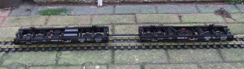

Having waffled on a bit in the last two posts, this one is mainly going to be a load of pictures - the weather was nice enough today to snap these outside, with the rollwagens connected by the "short" coupling bar and then loaded up with the two standard gauge wagons:
Overall opinions? Very pleased with these, and I'd say that they come highly recommended; it would be nice if Uwe changed the markings on the van body to proper decals like the rest of the range, because it would make a big difference to the appearance of that piece of stock - but it's a small point when all the rest looks so good.
