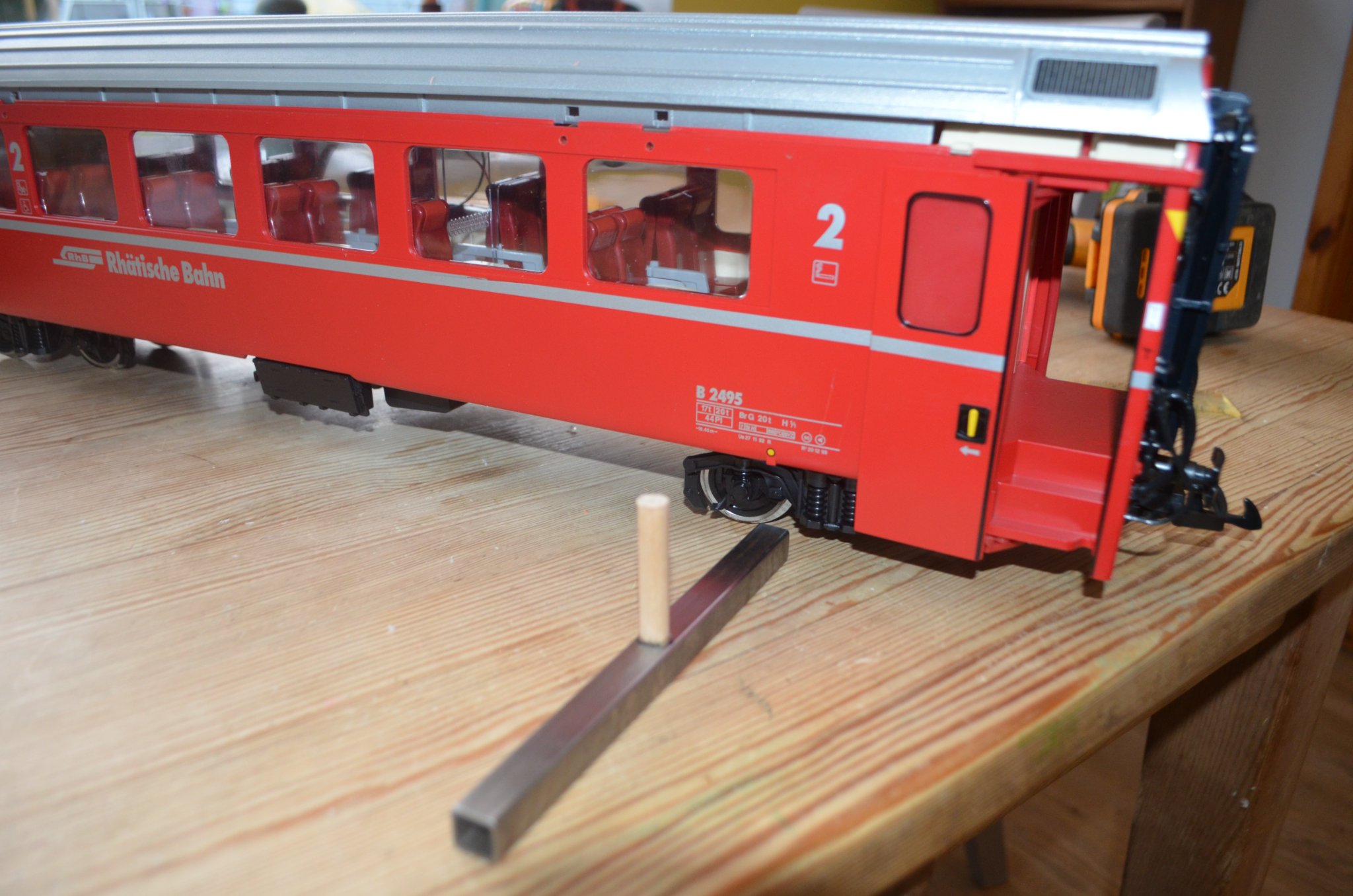

Hi folks, I've previously posted about my inability to remove the roofs of two RhB passenger coaches (LGB 30510 & 30512). Well I've finally solved this with minimal damage by drilling out the four pairs of tabs holding the tabs to the body and pushing up from the vestibules using the DIY tool in the photo. This, of course, has left eight small holes in the body just below the roof line. However, four of these are now used to screw the roof back down with self-tappers and the remaining four patched up and coloured. I can now install LED lighting and passenger figures.
