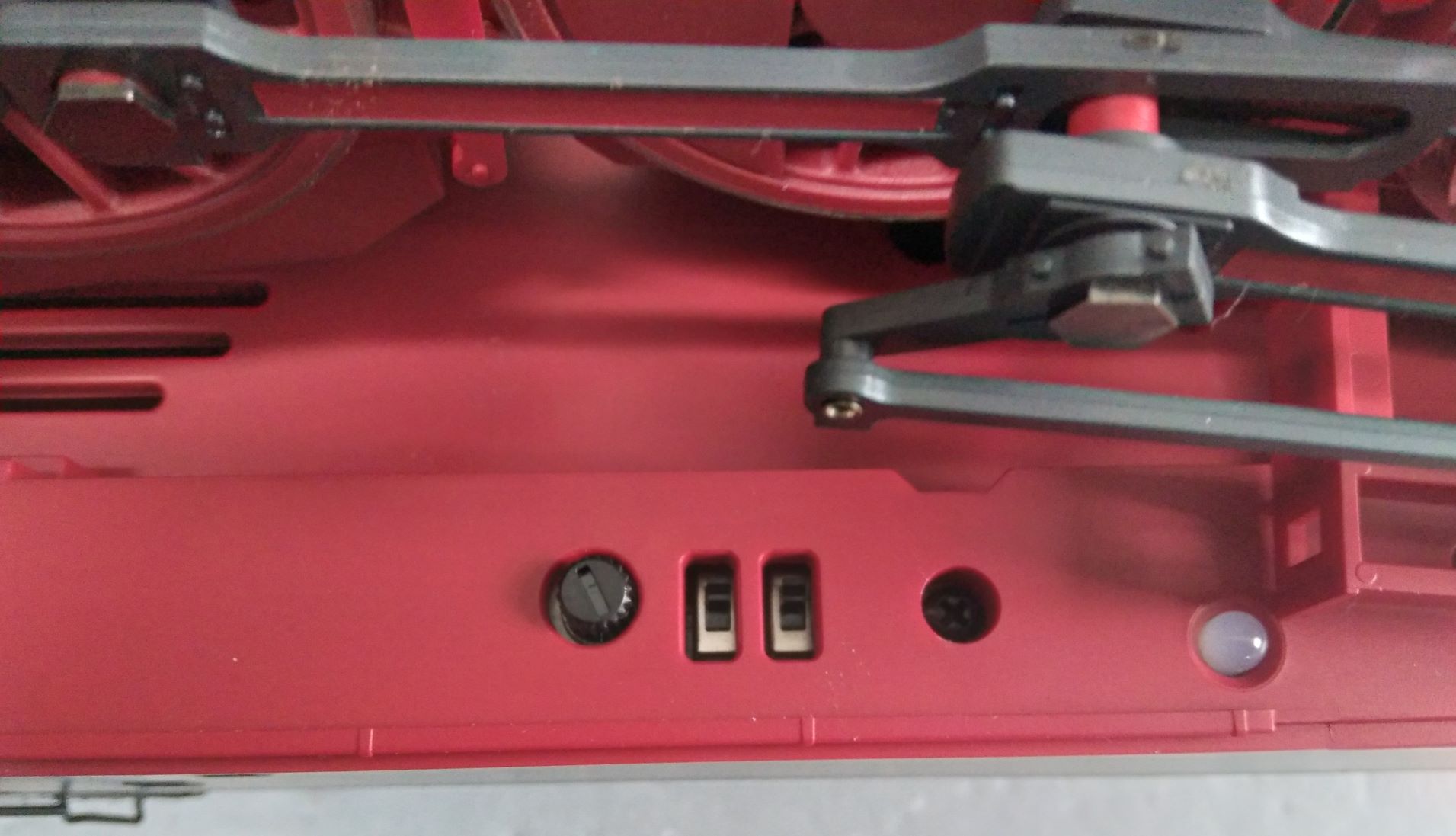

Whilst we're underneath, the bulge on the rear motor block houses the two reed switches which can be used to trigger sounds.
