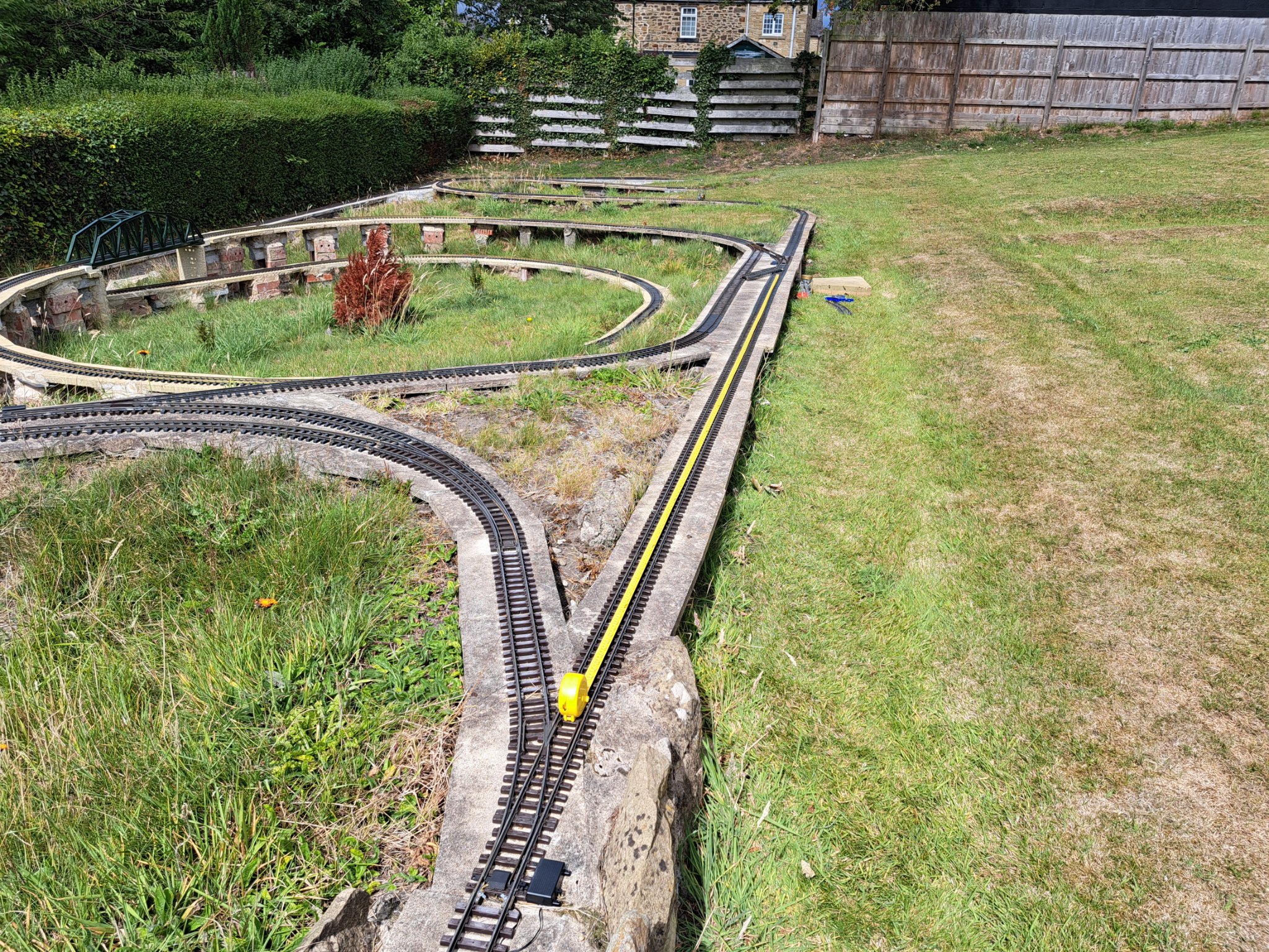

You can add the opposite crossover without causing any problems, providing that the yellow reversing section is extended to accomodate your trains.

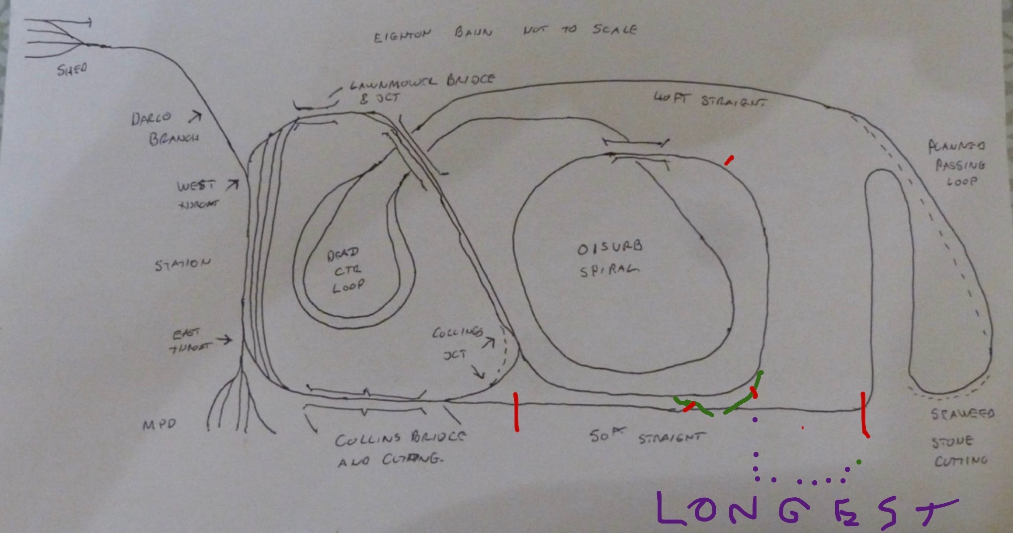

I am considering all options, including not doing anything at all, if that is how it turns out. It initally looked so simple, basically make a couple of diagonal loops in an oval, but I guess I was wrong. :(

Dir the penny has dropped, you have a loop and an extension to that loop. Where the triangle or reversing needs apply is where you make any joint along the 50ft straight. This effectively creates the triangle.
If you were to put your crossovers as near to the end of the loop you would need to use the loop module in one of the leads to those points and just beyond one if them at the longest length of your longest train. Thus this will work for you. Green new points, red isolations both rails blue length of longest train. Isolations at points where points join each other I think the track leading to and with what is left of the 50ft after points fitted should be long enough for your longest train. Something a,ong these lines has already been suggested. IMG_8686.jpeg
You would not be able to have a set of points on the straight closer to Collings Jcn as there needs to be at least a full train length within changeover section, that being the bit between the isolation sections.

Reverse loops CAN be quite simple in DCC, but also not depending on the circumstances. There are rules that need to be taken into account. If you dont have metal wheels or lights in coaches then it can be quite short and only the length of the locos, but if you do have lights and metal wheels it needs to be the length of the train otherwise it will not work properly. There's no way around that.
The 50ft straight with 2 crossovers is your best place for it observing the above requirements. @dunnyrail 's suggestion allows reversing in both directions, which is ideal. It requires 4 switches, 2 of which will be in the reversing circuit. A single Massoth module with short circuit mode will handle it just fine.
@dunnyrail is that red mark next to the bridge on the spriral an additional isolation point?

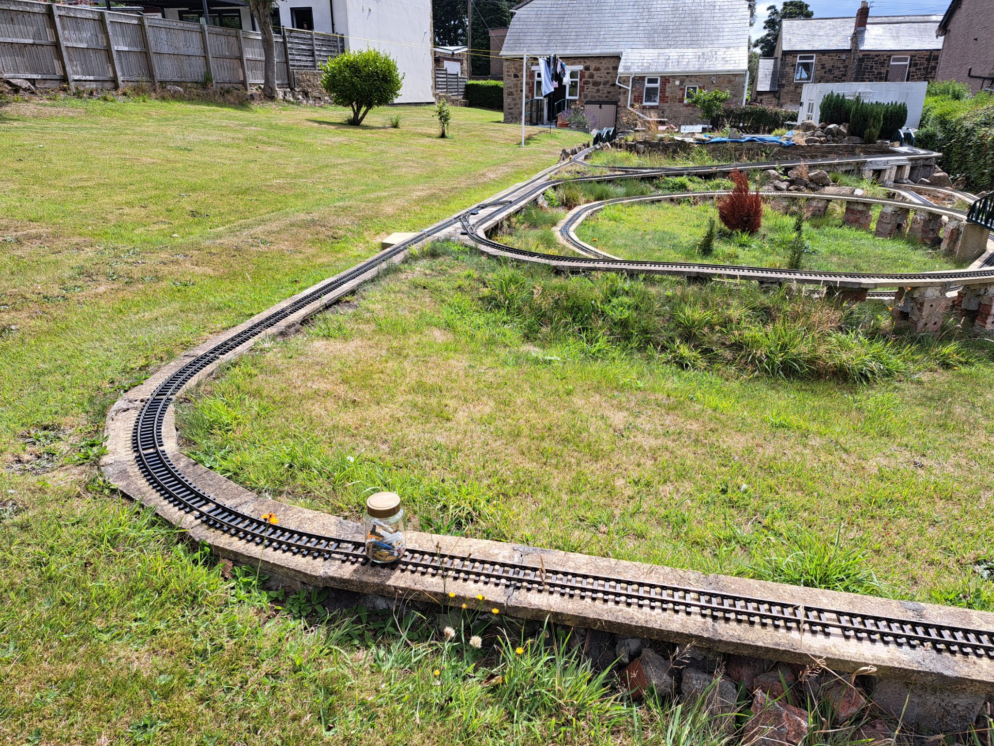

I have made 2 additional sensor track sections, but the re-install has reached the following...

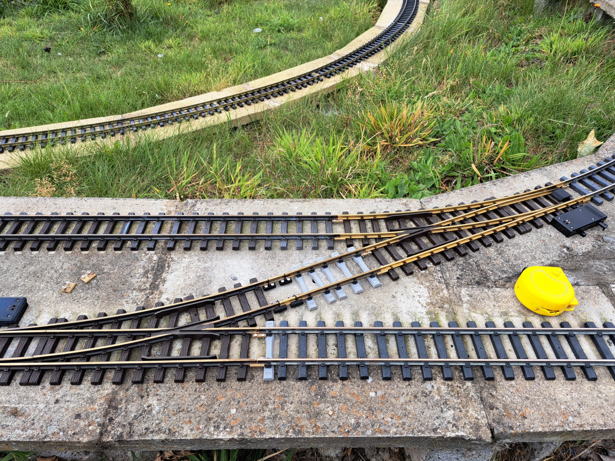

So if I have got my head around this the following will apply track breaks/sensor tracks at glass jar (Picture 1) tape measure (Picture 2). There is only one pair of points installed at present, as that's all I have for now. So a dummy straight is positioned to give me and idea of where the second pair they will fit.
So Picture three will be were I put the main + - in/out and a sensor, if I am correct. Then just a case of figuring out what to do when the second pair of points are installed a full parallel in out or just a sensor.

  • SENSOR IN 1/2 = Cross connect Sensors at Picture 1 Coffee Jar & Picture 2 Expanded measuring tape main body
  • SENSOR IN 3/4 = Cross connect Sensors at picture 3 minimised measuring tape and pretend track junction.

Nodrog1826, with your second crossover, have you considered installing it at the left hand side of your inner loop in the same way as your right hand crossover?
It would look a lot better than having a reverse curve crossover, especially on a main line and it will match the other crossover.
There is no reason to have the crossovers close together, it will make no difference.
Your plans for the isolating positions could accomodate 2 long trains!
It is the only the distance between the isolators on the main straight that is relevant

Ok, we have success...
...that was inspite of the instructions and the illustration not in agreement with each other. So one part down, then work started on fitting the point module.

Yes it is. Done there so that your longest train will fit in what is the reversing section.
Apologies that is incorrect. I should have said it is the length of each crossover route that is relevant.
Are you sure about that? It is not in the reversing section.
The isolator towards the bridge on the spiral will do nothing because the track each side of your proposed isolator never changes polarity and no short cicuits will occur.
The reversing section is completely between the 4 isolators, 2 on the crossovers and 2 on the main 50 ft straight and it is the routes through these that should be long enough to accomodate the longest and even possibly any future longer trains.
Glad to see that your first crossover is working fine.

So I did take out the jumper cable on the curve to the bridge and isolate on the lower end of the spiral bridge, but I removed/reinstated it all when I took the crossover out.
Now having put the crossover back, without the bridge isolating section,it appears to have no diverse effect. As for the length of the isolating sections, was tested with a 7 coach, Crok hauled train, plus a coach length spare. In theory whilst that is the longest train length that will fit into all the passing loops and manage the spiral. The station will idealy manage a 5 coach train, 6 at push, but it's very tight for clearance. So in the main 5 coaches and a loco is the rule.

Bit of a learning curve but glad to see that you got there in the and that your trains can return from there :D :D :D :D
