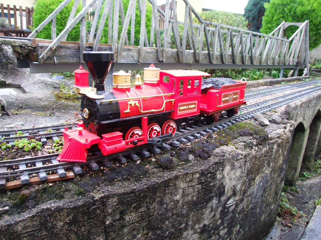

I just wondered if someone could provide a link to, or recommend, someone who sells R/C for battery powered locos.

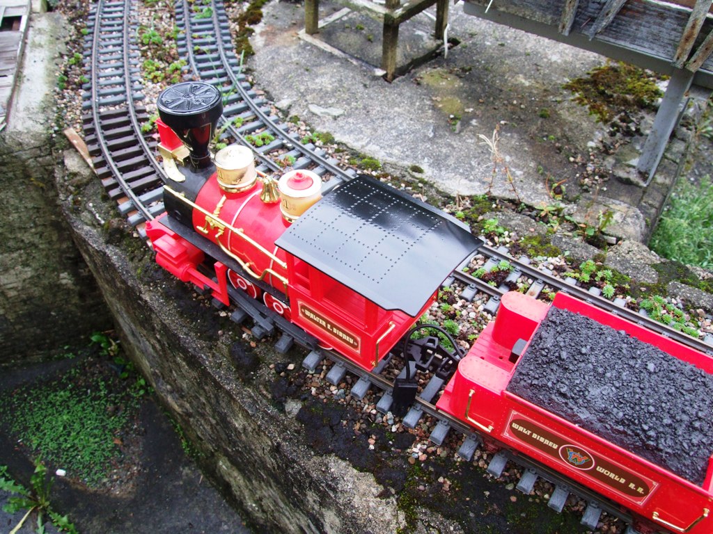

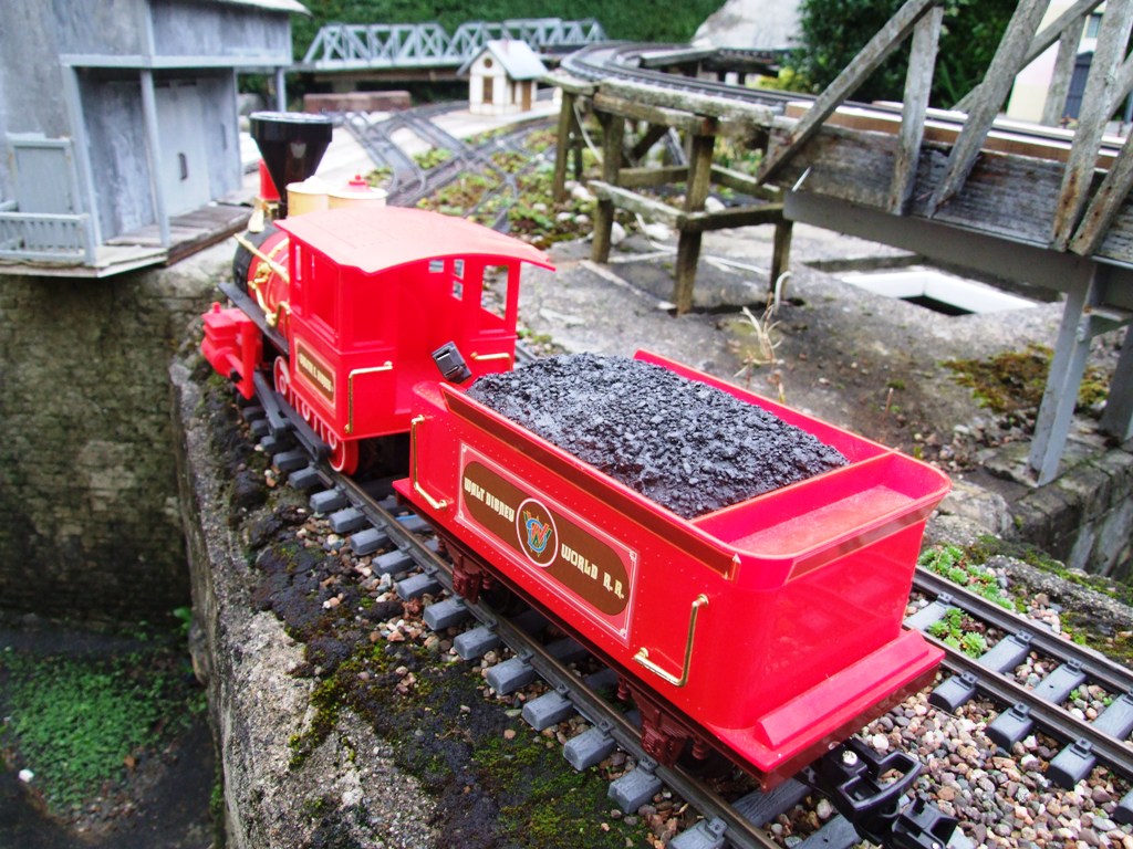

The loco in question that I would like to be remotely controlled (stop & start - and forward or reverse) is pictured below. It is a Scientific Toys model and I am hoping someone I know would be able to use it on a simple garden layout I will be helping to design and construct with him....

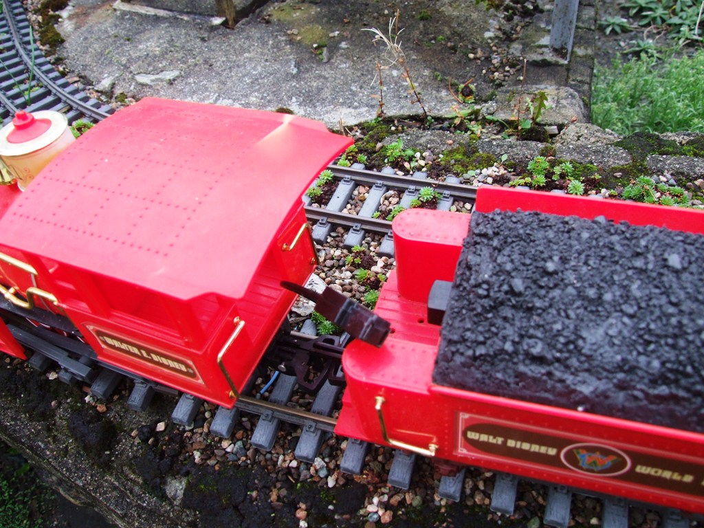

As can be seen, in the last picture, their is a plug from the tender. I just thought I could simply insert the receiver into the plug wires for the output to the loco - the interupted plug wires would feed the receiver.
Oh, and another pic -
I just spray painted the cab roof before I came into to download the pics from my camera!
Thanks in anticipation! The work on the new garden line will be posted in my Ox Mountain thread when it commences!
Lots out there, Deltang (Via RC trains or Micron) Fosworks, Loco Remote, Crest Train Engineer (Revolution) Brian Jones, and I am sure I may have missed a few.

Thanks Jimmy - I'll trawl through those names! It might not be an economical proposition - I just bought the loco for use in the trailer if ever I got a power failure in the track!

I think I understand what you mean by economically viable. Already mentioned Loco Remote Wifi control for Garden Railways would seem to offer the most cost effective, assuming you own a smart phone or tablet. Otherwise how about a manual speed controller, like the Fosworks ESC-180 ? Fosworks Max

Thanks Max. Trouble is the loco itself is really only worth a fraction of the cost of RC equipment. Looking at the links, most of the stuff is beyond my comprehension!

For me, the loco pictured below is my back-up in case I lose track power and it came with a remote. My two Bachmann battery locos are not working for some reason :banghead:

I use Locoremote for my trams, I'm not sure if you've read up on the system. I don't have any experience of R/C, this information is just how I have found the locoremote system.
The maxi which I use creates it's own stand alone wifi signal, it doesn't need to connect to any other wifi system.
All you need is a phone or tablet to connect with the locoremote, the phone or tablet doesn't need to be working as a phone, I have two old phones that aren't used as phones anymore they are just used for the trams.
I use 8 rechargeable AA batteries, a days running uses about 50% of the batteries power, a loco hauling a train would use more power.
Connecting a phone or tablet to the locoremote really couldn't be easier, simply type www.locoremote.co.uk/v1 in the web browser and your connected, you can also have 2 or 3 phones or tablets connected to the same locoremote unit at the same time.
What I would say is read through some of the threads here and see what others do and what functions peoples models have, then think about what you would like from the model you are fitting out, I think quite a bit depends on what functions you may want the model to have.

Not quite right. From their website :-
"The Loco Remote module creates its own unique, password protected, long range Wi-Fi access point.
This is completely independent of other Wi-Fi networks such as your home Wi-Fi network and so can be used anywhere."
The unit generates its own web page so only a web browser is required to control the loco. Has a much longer range than Bluetooth.

The locoremote creates its own wifi signal, a locoremote would work in the middle of an open field.
My garden is 20m long, I have found the locoremote wifi signal is fine over 15m, I've not yet tried it over the full 20m.

The Piko keyfob system, might be cost effective for you?
The receiver board is a little bit bigger. Depends on the space in the tender.

Thanks for the clarification. I misunderstood Loco Remote site's analogy, "think connecting to wi-fi in a coffee shop". It's only when I looked at one of their You Tube videos, after your comment, that the penny finally dropped - the Loco Remote appears as a separate device on ones wi-fi enabled device listings. Perhaps they need to make that clearer on the website, i.e. You do not need to connect to any other independent wi-service provider, Loco Remote creates its own network to communicate with your phone/tablet directly. Might save old fuddy duddies like me dismissing the product. I think I have a couple of locos that could use this. Max

If you just need some think basic and not too expensive, take a look at lococontrol.co.uk
I met the guy behind this yesterday at a G Scale Scotland meet, it seems a good system.

I have a train with one of these in and just converted a 16mm loco for a friend. Odd posts about the Forum on the system, I think I did a review a while back and will try to link it. Meanwhile here is a link to Topslots site that have them.
EDIT
If you need any other help just ask, I mounted the RX board (you only need the larger one) in the cab roof. However you may need the size so that could be added and a battery pack may need the tender to be rebuilt to take mor AAA. I fitted 9 in the IP diesel.

Thanks Jon - I'll be taking the track and loco up my friends in 45 minutes - I'll mention it. Looking at Moonraker's diagram, I will need help/advice if we go down that road.
