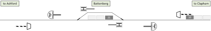

When trains have to "passing siding" in a station, it is pre-defined which of the two trains is allowed to run first into the Station, usually with a timetable entry for the engine driver .
(please don't mind the fictious station names). Train 21 from Ashford to Clapham runs into station Battenberg. All switches are in default position (straight).

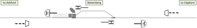

After train 21 stopped precisely at the H-Tafel, the conductor turns the switches. Meanwhile, Train 10 from Clapham to Ashford arrives, has to stop at the Trapeztafel, and gives a short whistle (also known as wake-up call). When everything is fine, the conductor of train 21 allows his engine driver to give the so called “coming” whistle signal (ZP11 long-short-long).

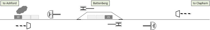

Train 10 in front of the Trapeztafel acknowledges this with a short toot, rolls into the Station and stops at the H-Tafel.

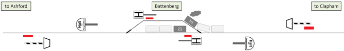

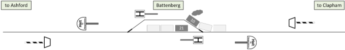

Once the loading / unloading is done, train 10 leaves the Station. The conductor of train 21 turns all switches back into default position (straight), so train 21 can leave Battenberg Station.
Important: Passenger Trains usually run only into tracks with H-Tafel that indicates the proper Train position/clearance.
