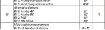

Here are the CV50 bit values from the 28446 decoder manual

Thanks! I assume MM means Motorola Mode ?
So CV 50 = 15 seems to be all bits on which would enable everything... I'm a bit confused...
That's what worked? if so, that is plenty weird... (perhaps factory testing was only in that mode(s)?)

Correct, CV50=15 is the default value, which is all protocols enabled. In my initial configuration I was setting CV50=0, which is all modes except DCC disabled. Interim values of 2,3,7 all produced a popping/crackling noise when operating sounds are turned on. Only with all protocols enabled does it go away.
