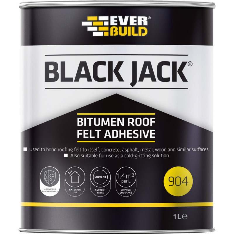

Vinyl tile perhaps? I use matt-finish ceramic tiles for mine, bit that's over a more substantial base. You could put masonry paint on top. Felt would work too, fixed down with 'Black Jack' - I've used that method for a yard surface on a wooden base, so there is nothing to penetrate the materials and compromise the waterproofing quality.

What is this Black Jack? I asked Google but it only gives me card games.

Felt adhesive - as they say on the TV, other brands are available >:) Brushed on cold, you have a few minutes before it starts to harden, and your brush is a gonna, so use an old one! I also use that with felt for platform surfaces.
