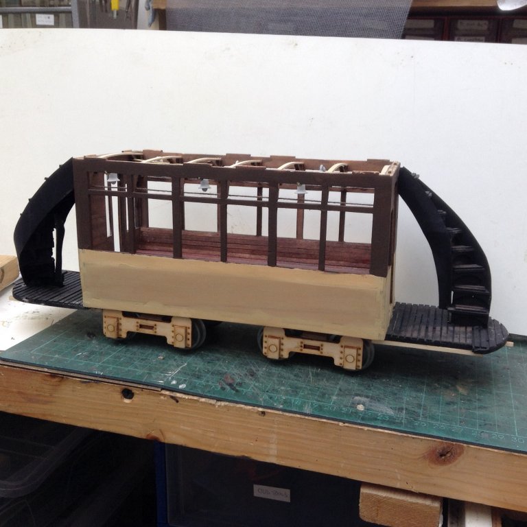

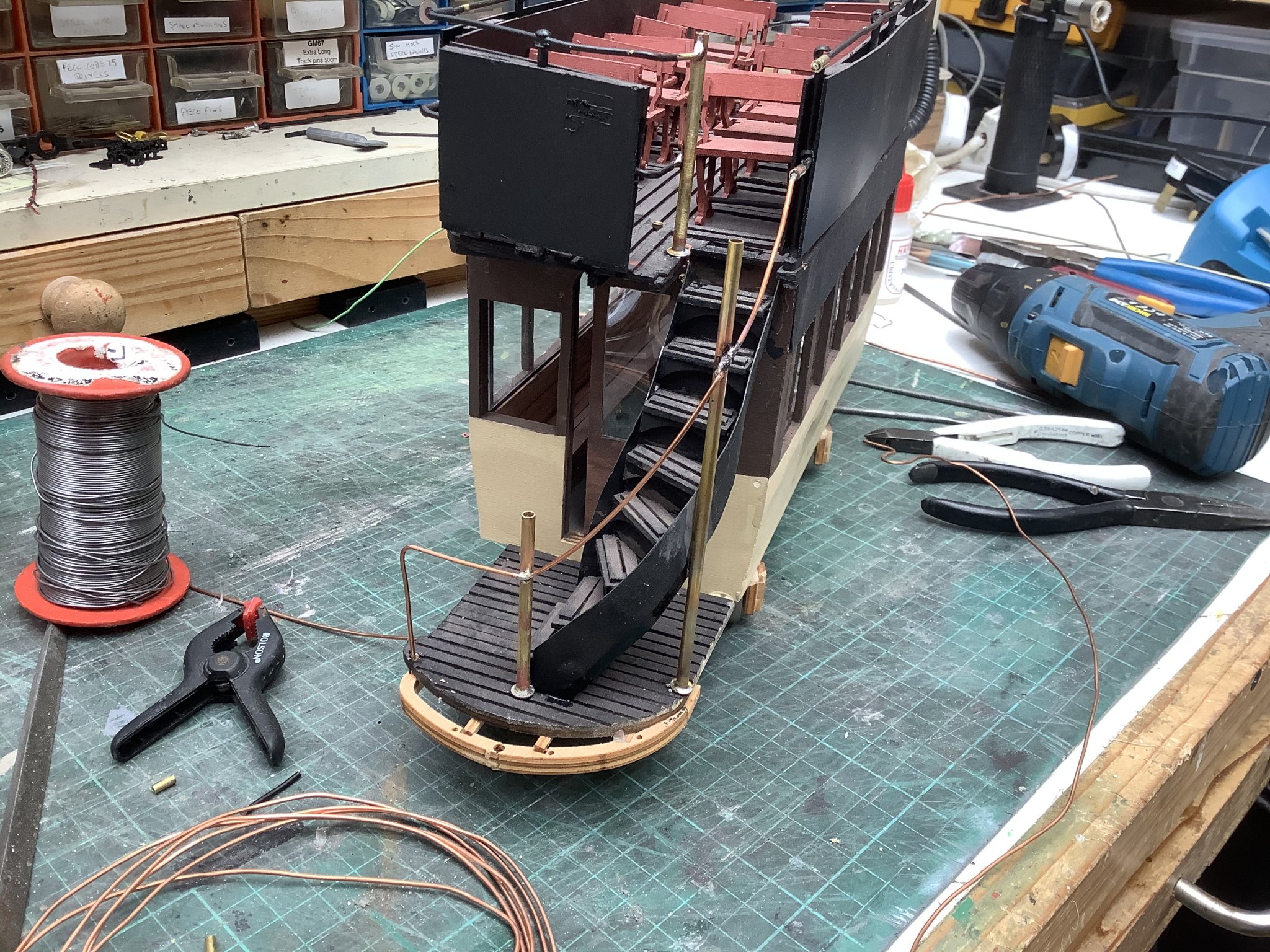

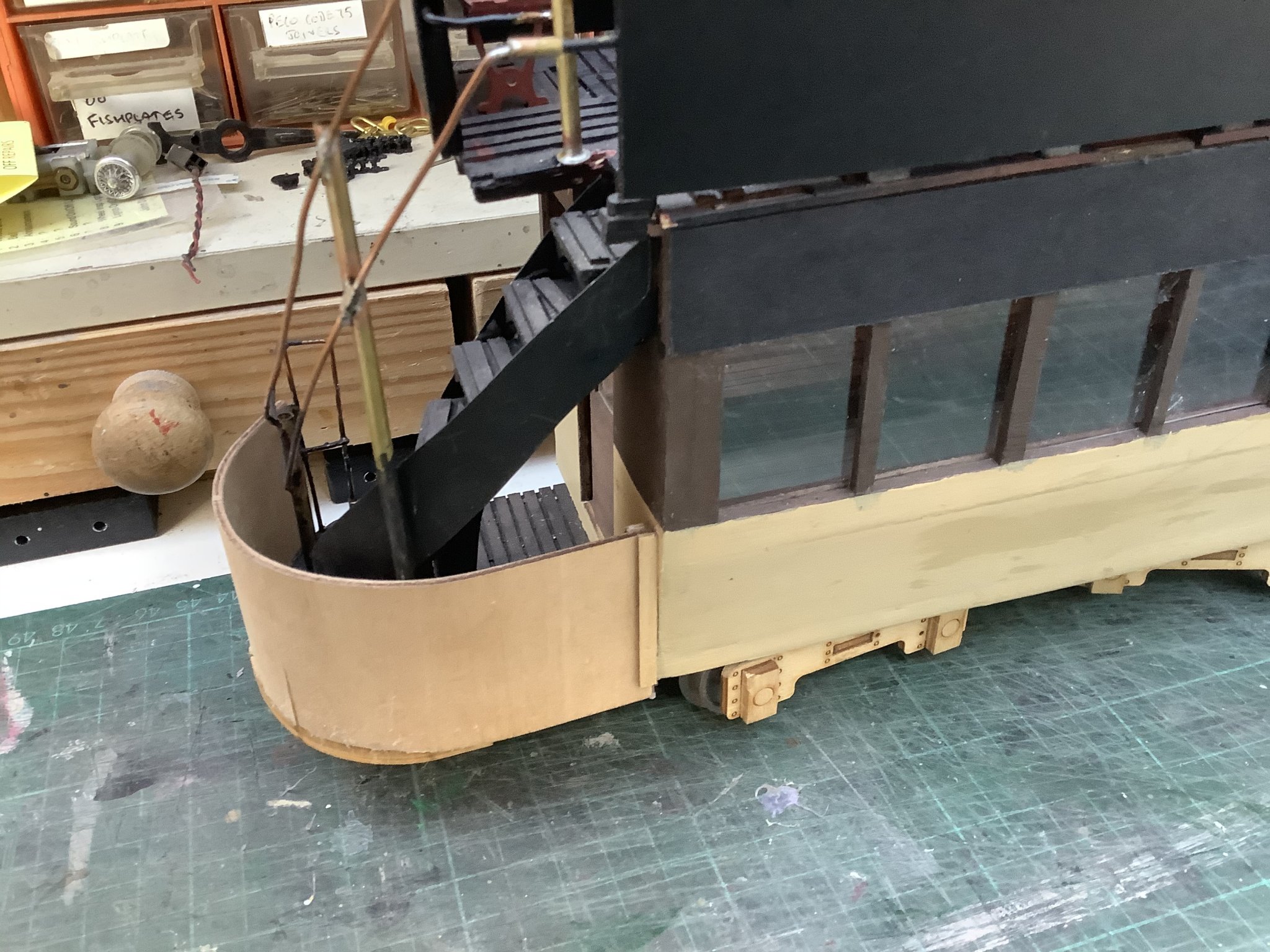

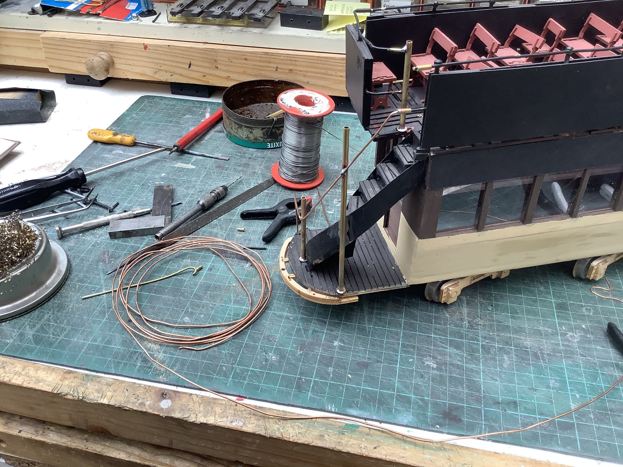

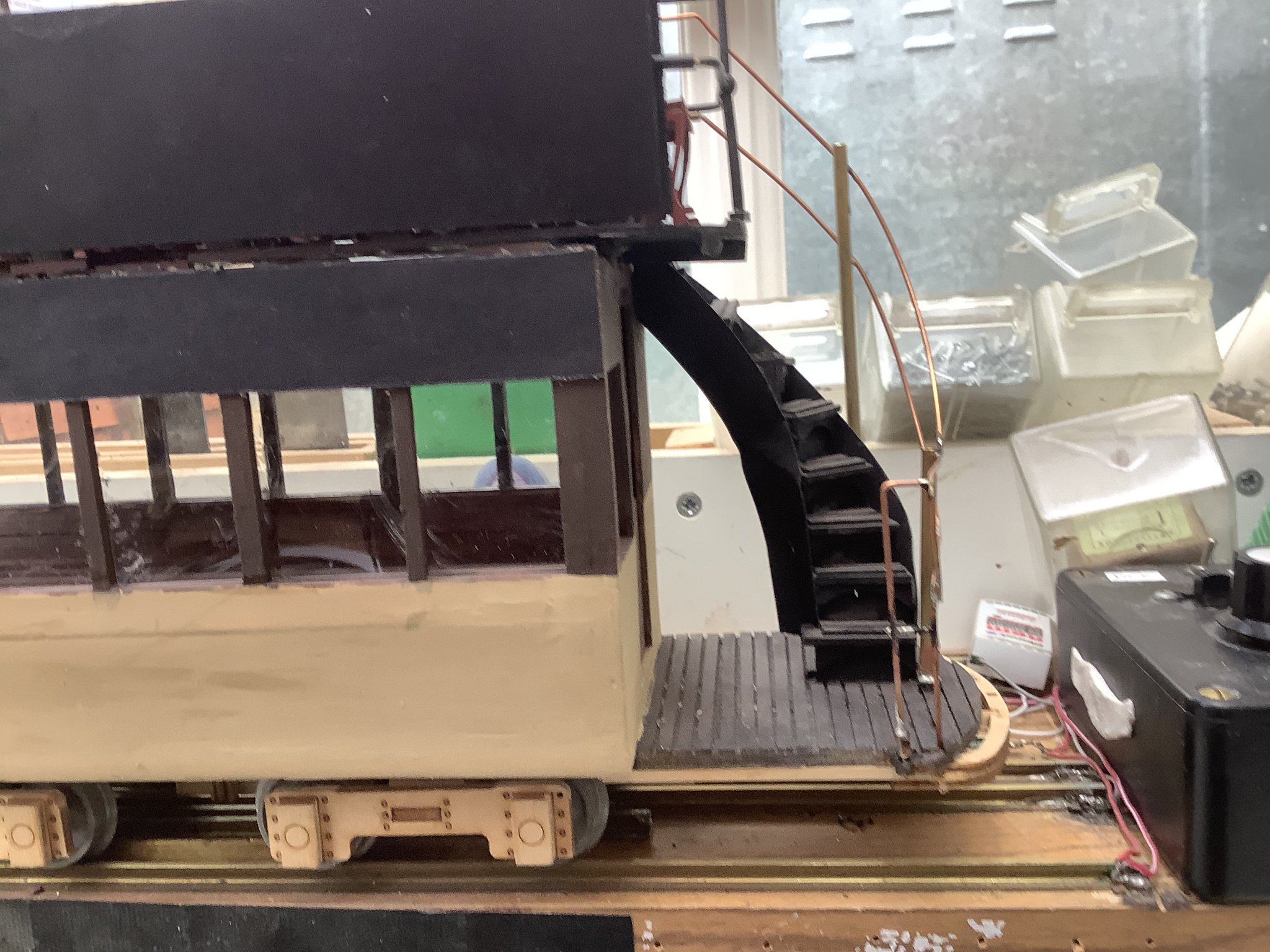

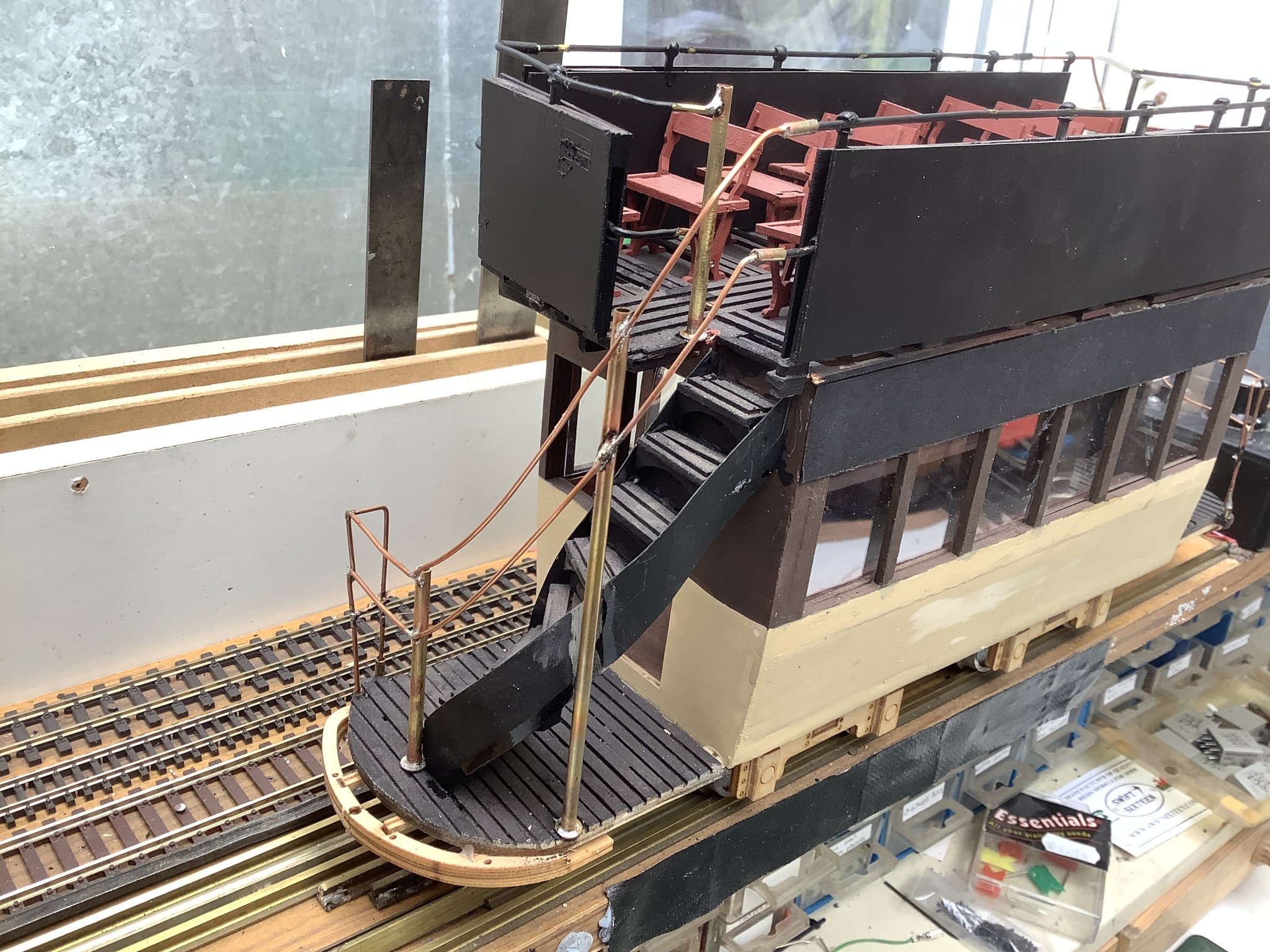

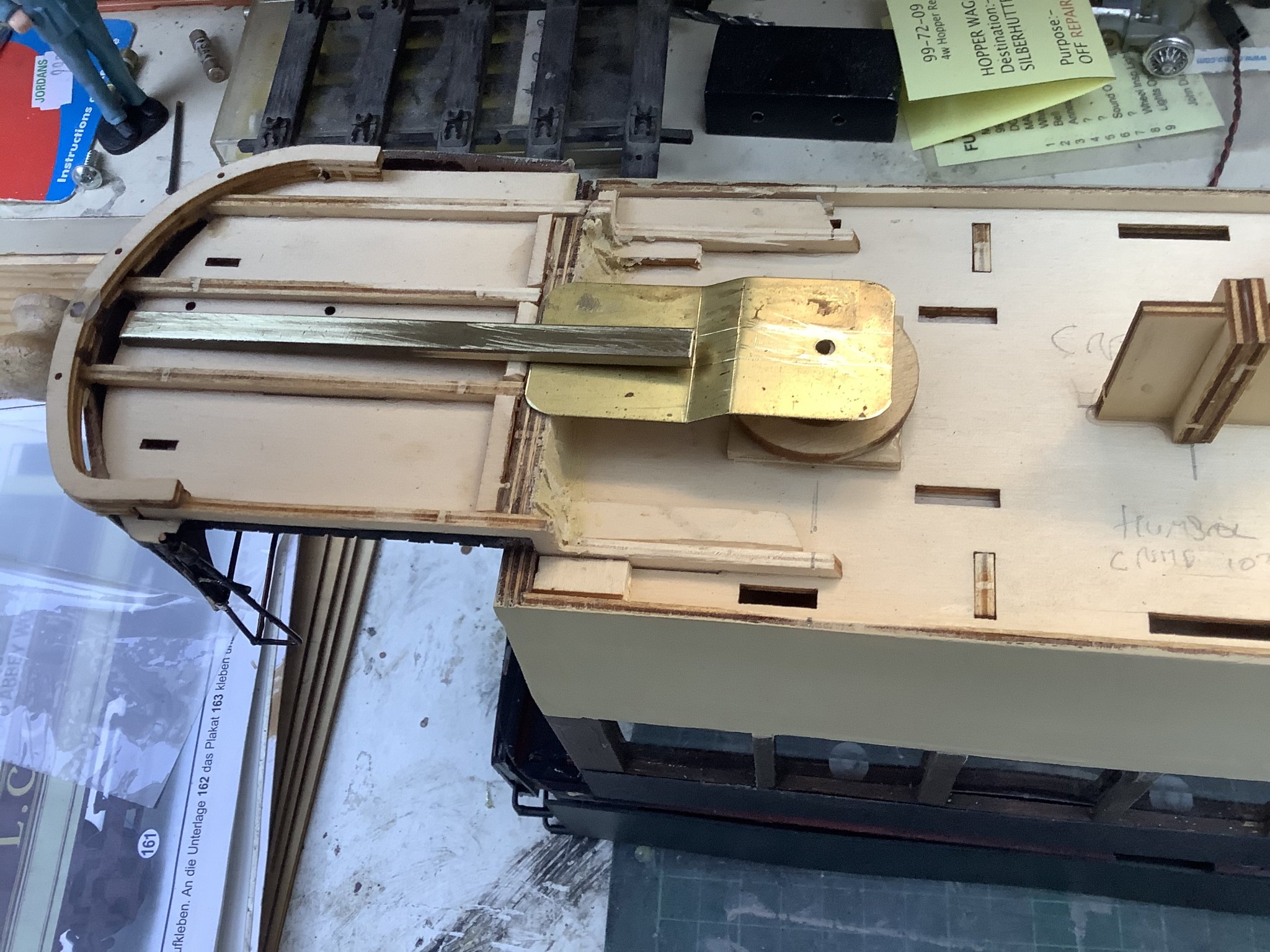

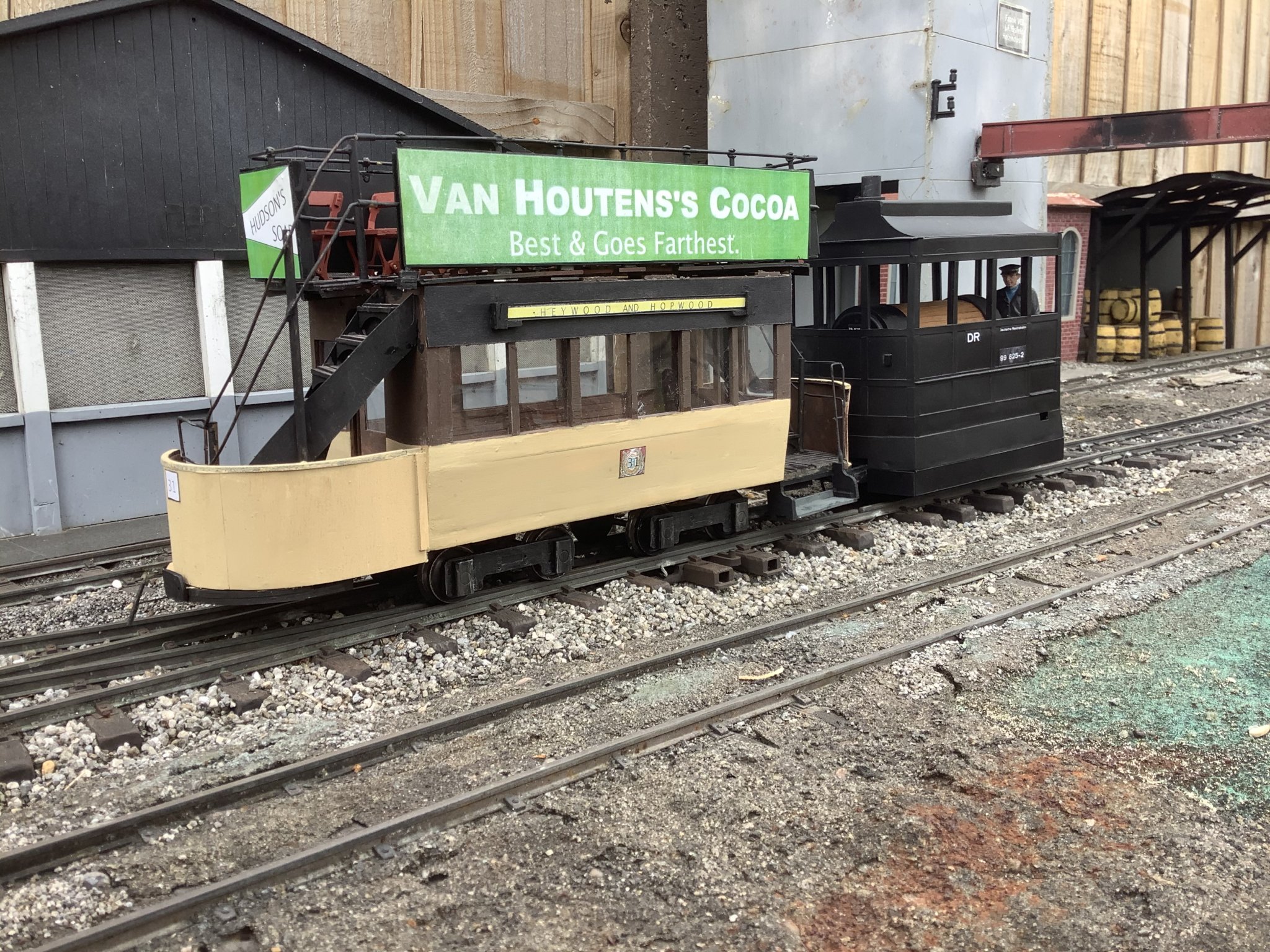

I bought my Tram from Glendale in December that year, opened the box cogitated some then started pondering some more. A big start was made and a great deal of work was done then it has sat moribund for a year or two having a few showings on here. It had sat waiting for inspiration as other projects appeared more important, but I needed to sort out how the top would be removable and also the stair handrails were causing me problems as being whitemetal were not very robust. So the lockdown has pushed it to the fore and serious progress has occurred over the last few days.

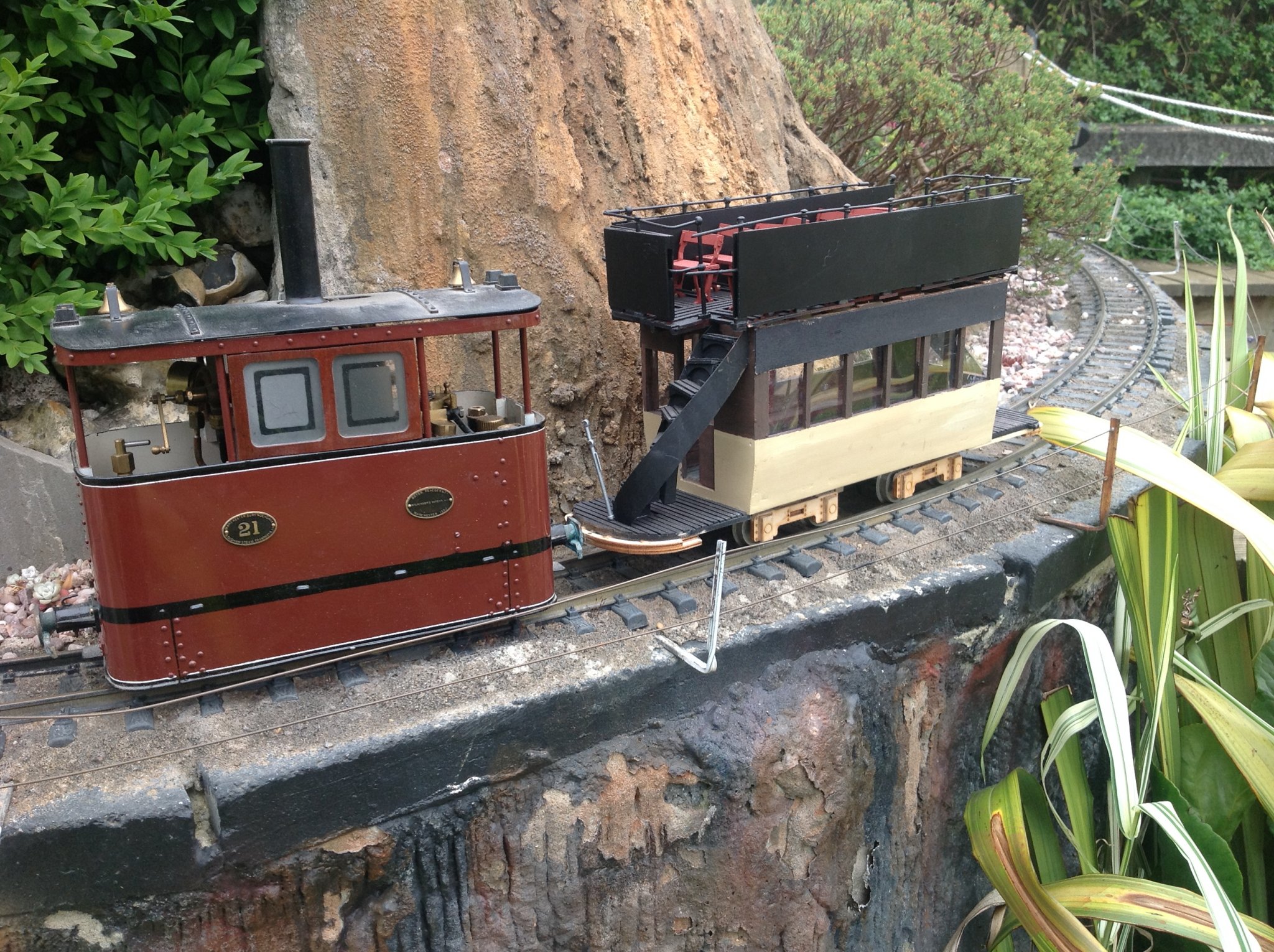

This is what I was looking to build.

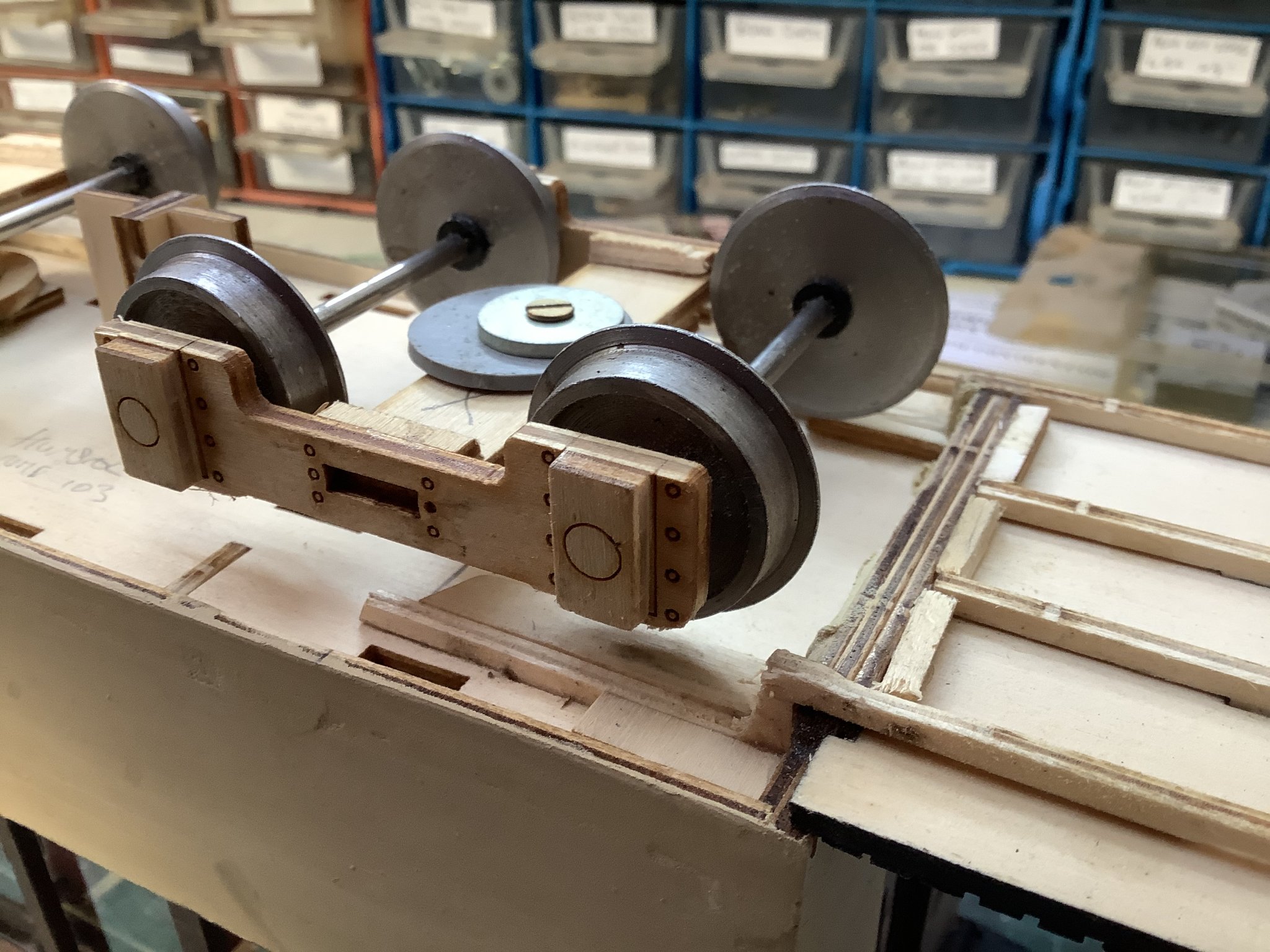

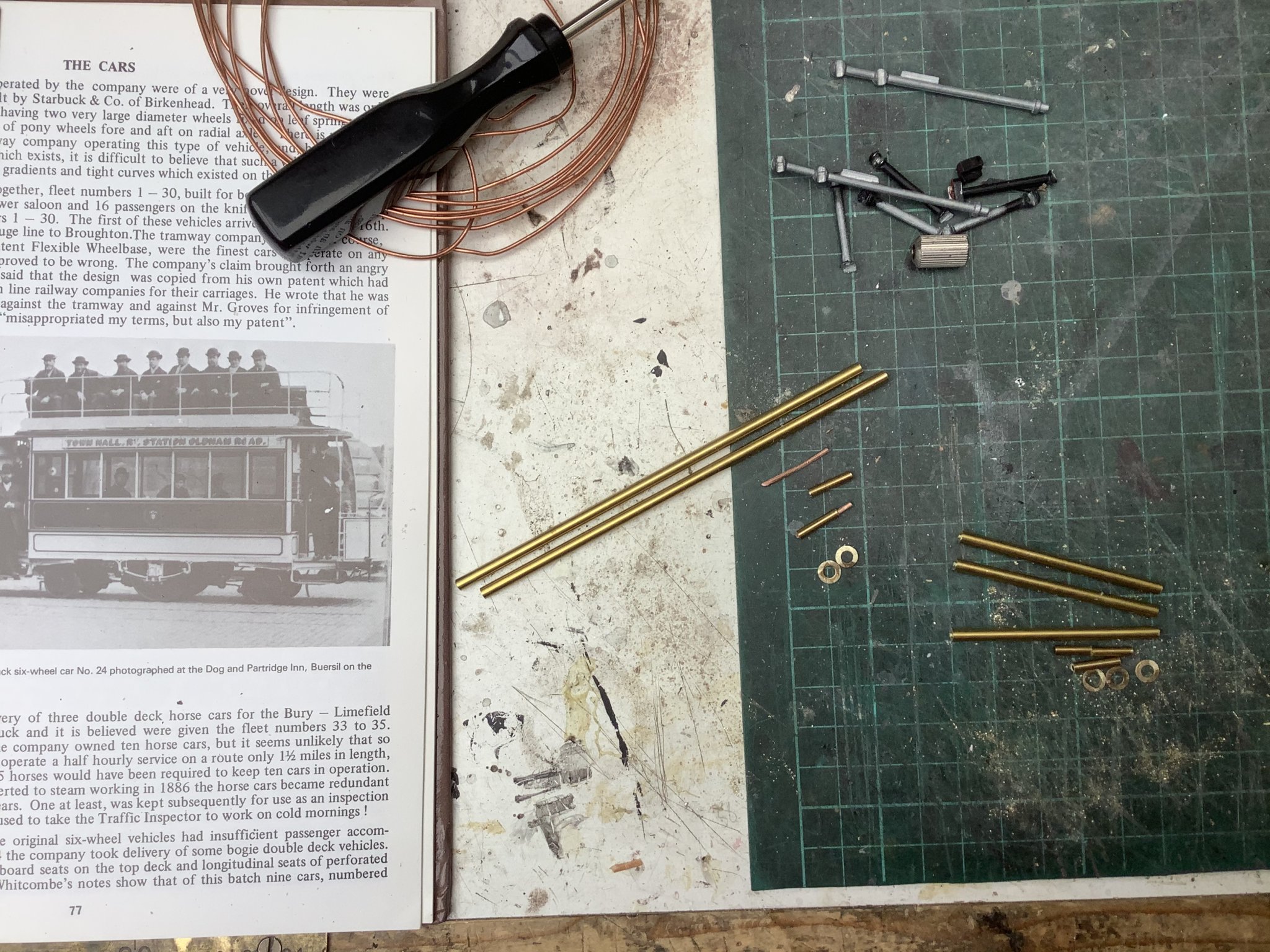

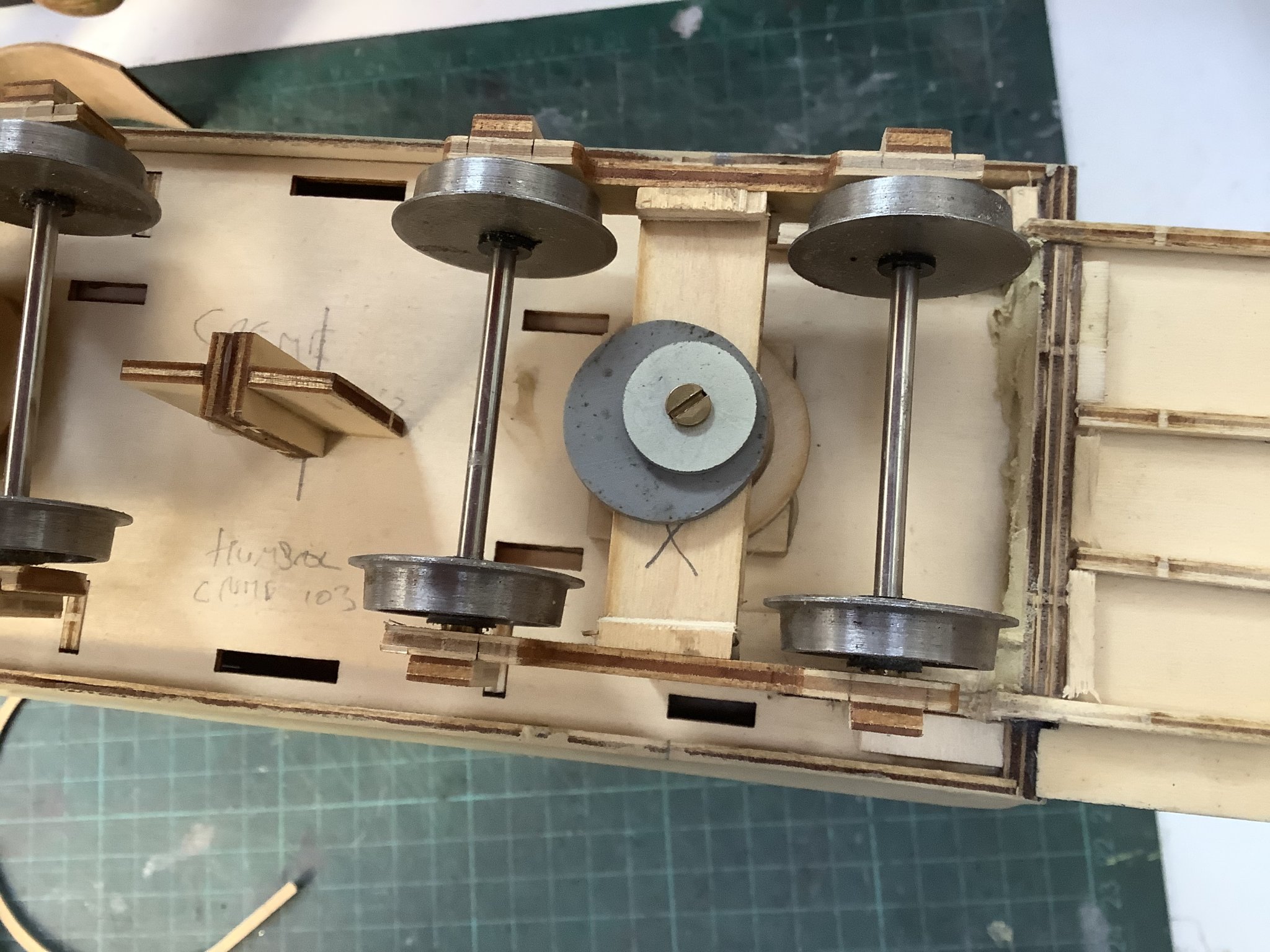

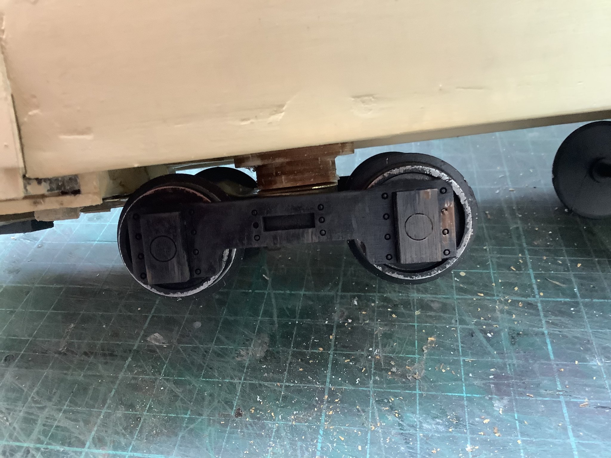

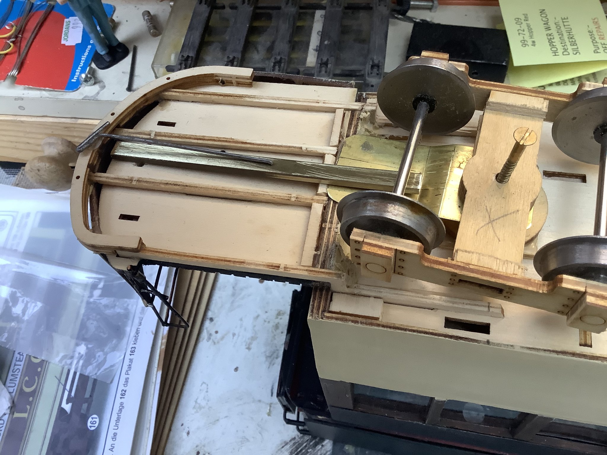

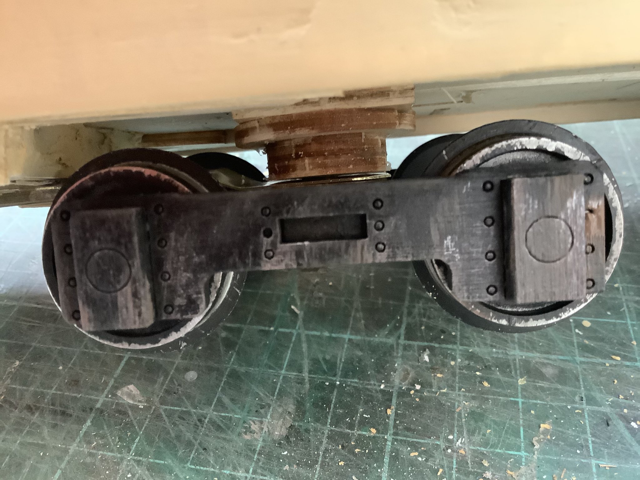

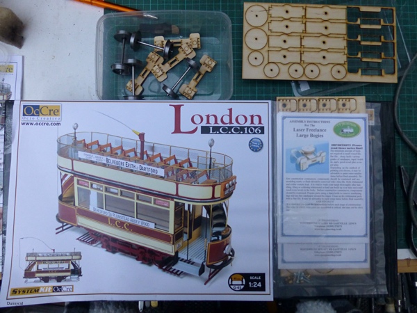

First I needed to source some G scale Fox Bogies, wish I could remember where I got these from but they fitted the bill perfectly. The wheels are IP Engineering 24mm insulated steel. You can see the parts for the bogie in the first pic so someone should recognize the supplier on the instructions, Swift 16?

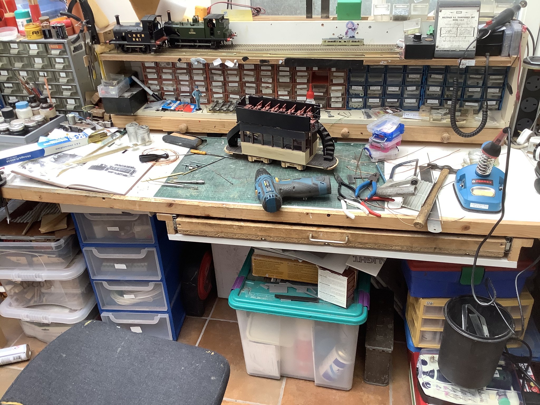

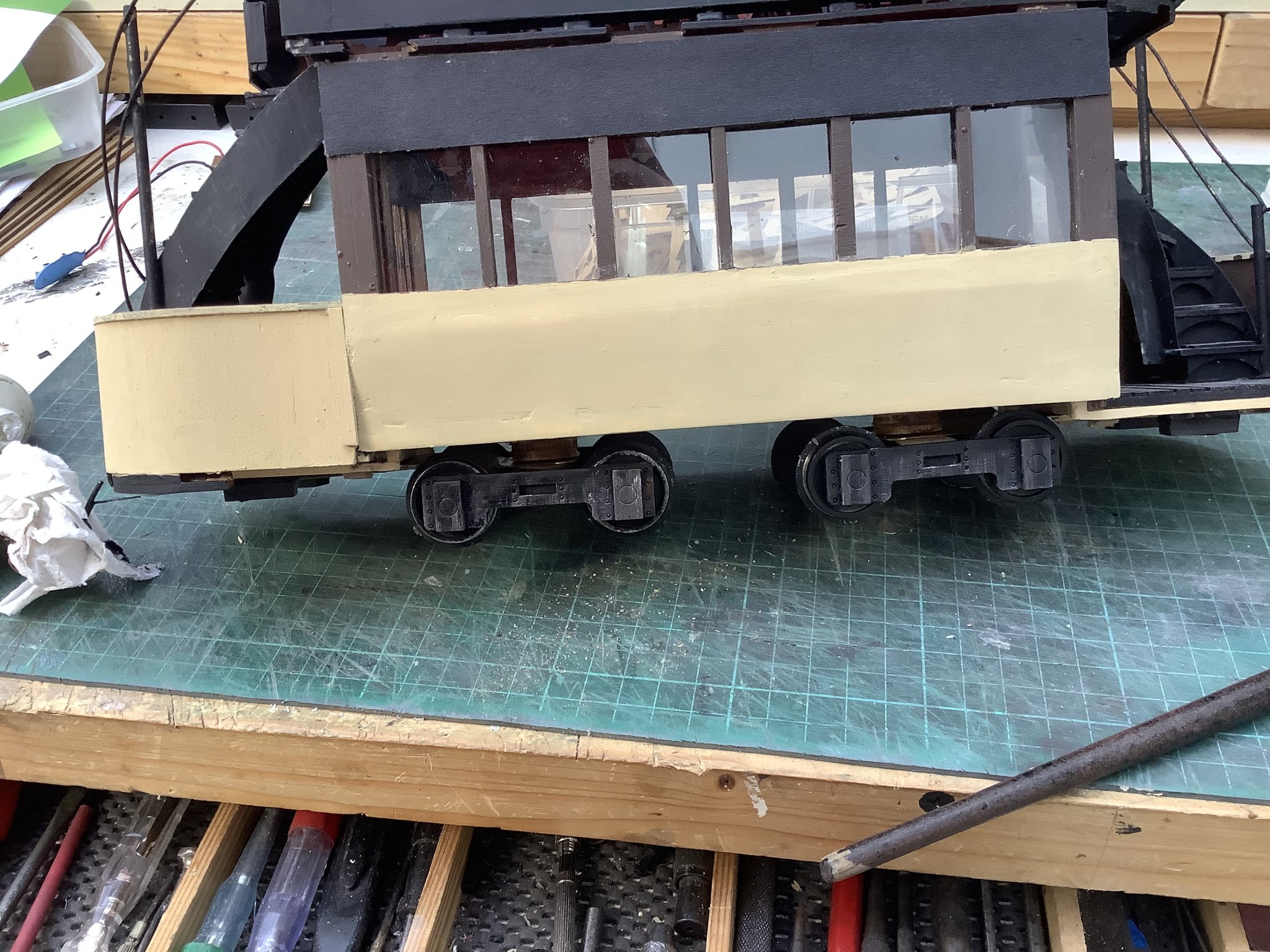

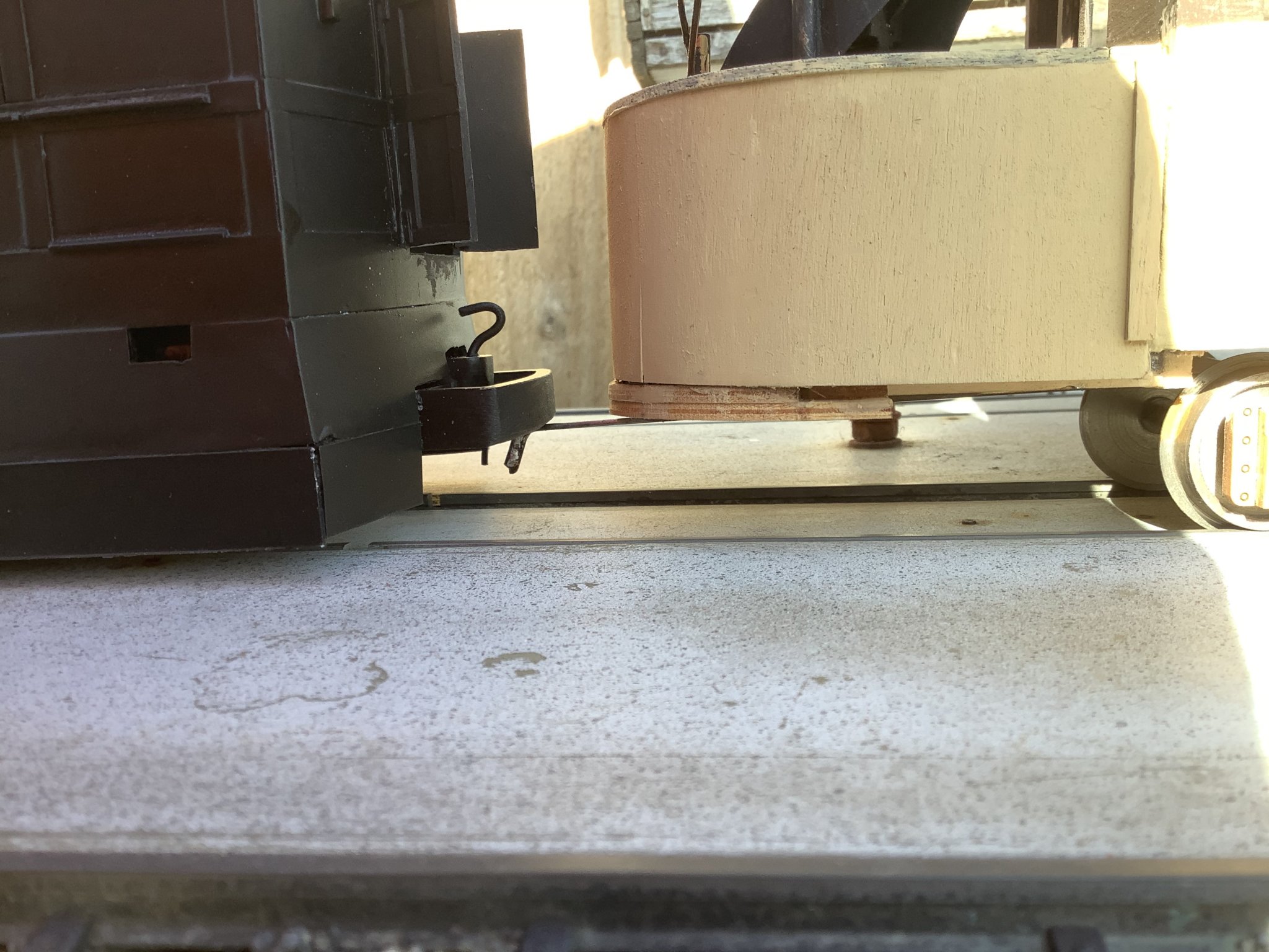

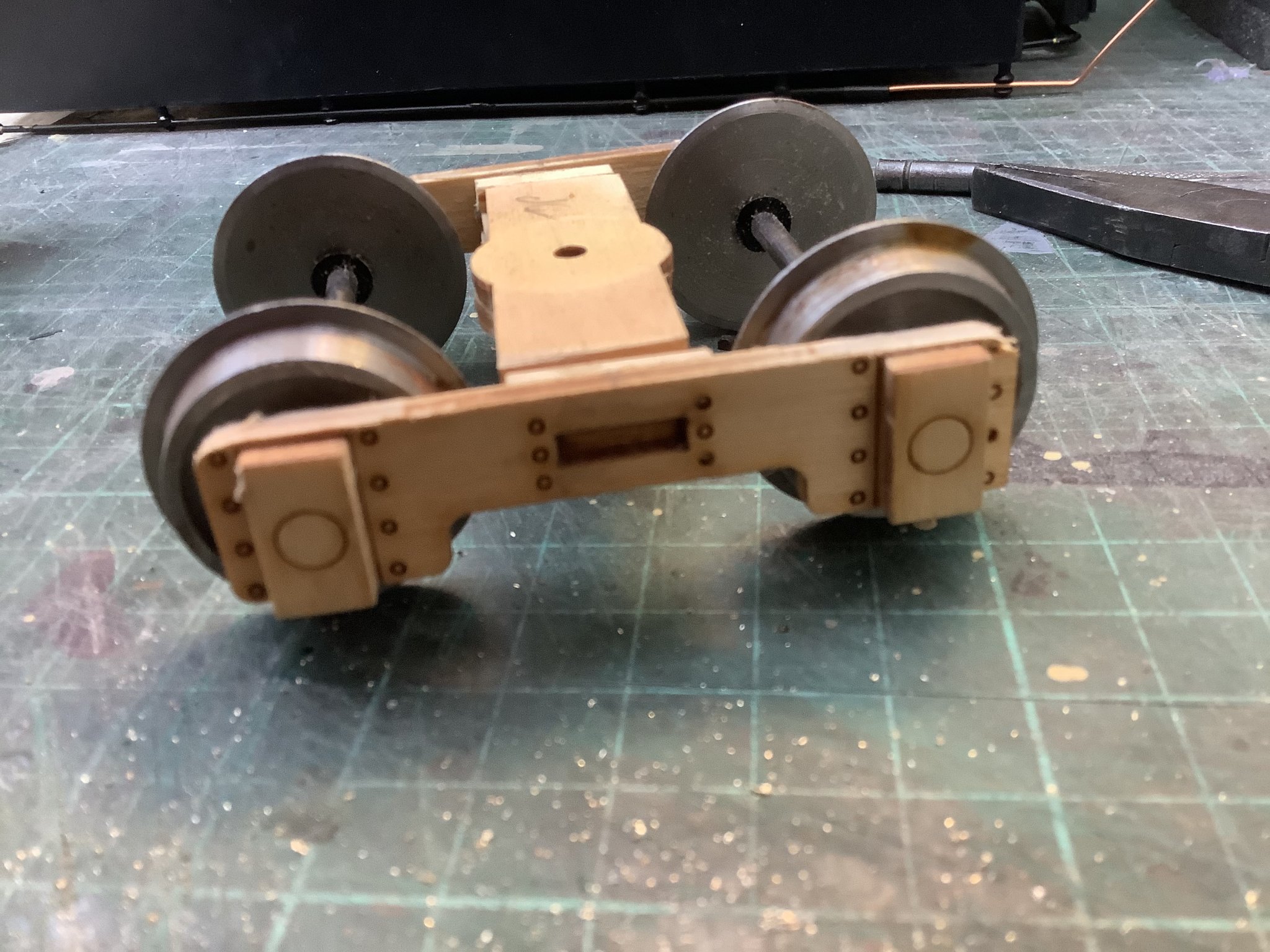

The tram was build up mostly following the instructions then the front of the top deck was hacked off to follow my chosen prototype, below you can see the bogies mounted on the base. The X construction is to limit the swing of the bogies, not that I have track that tight but it stops them flopping around during handling of the car. You can also see that I have noted the colours used underneath the Tram. A useful reminder for the future should any touch ups be required.

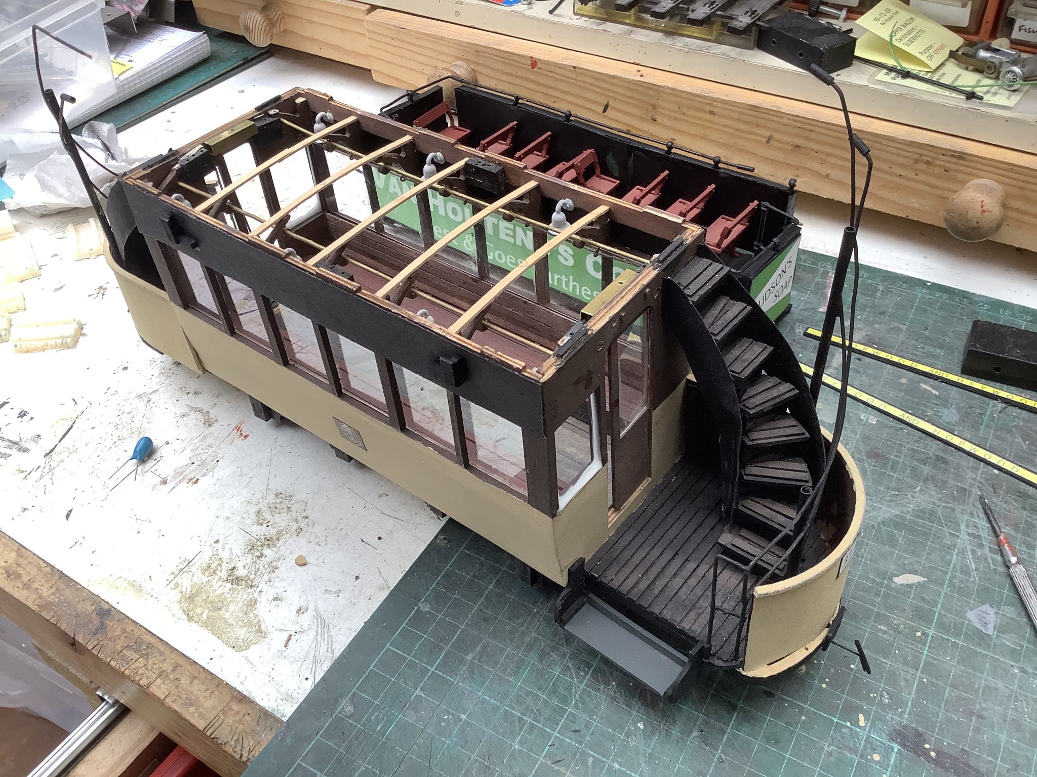

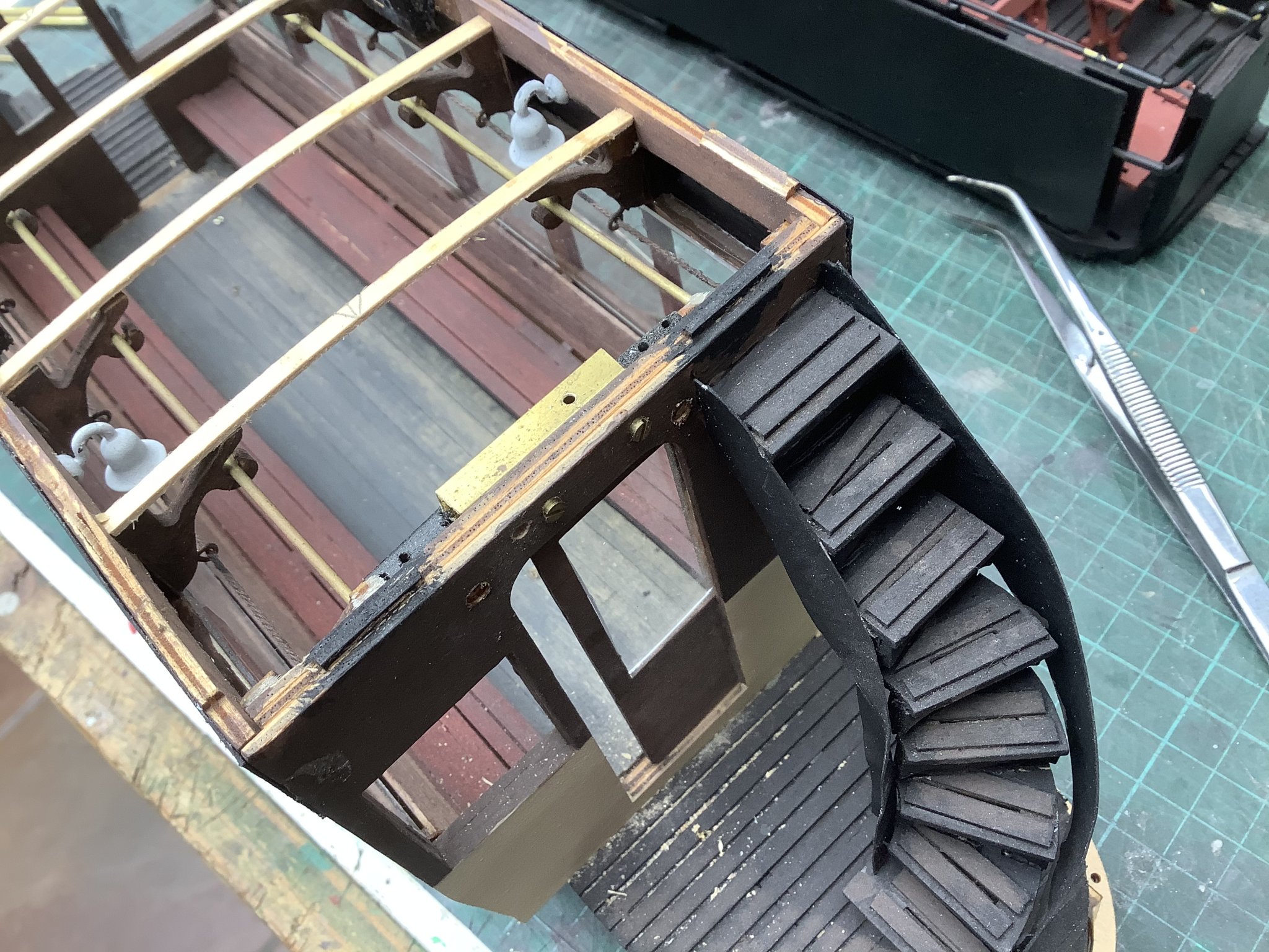

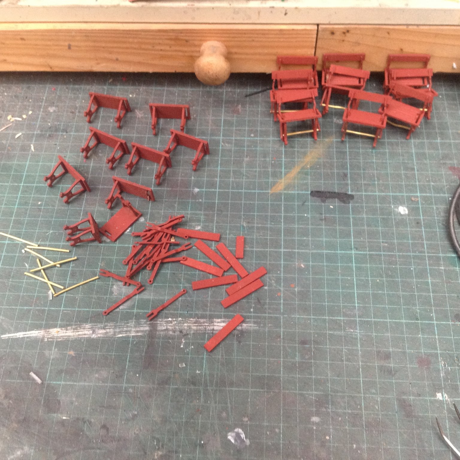

Making the top deck seats was a long drawn out job.

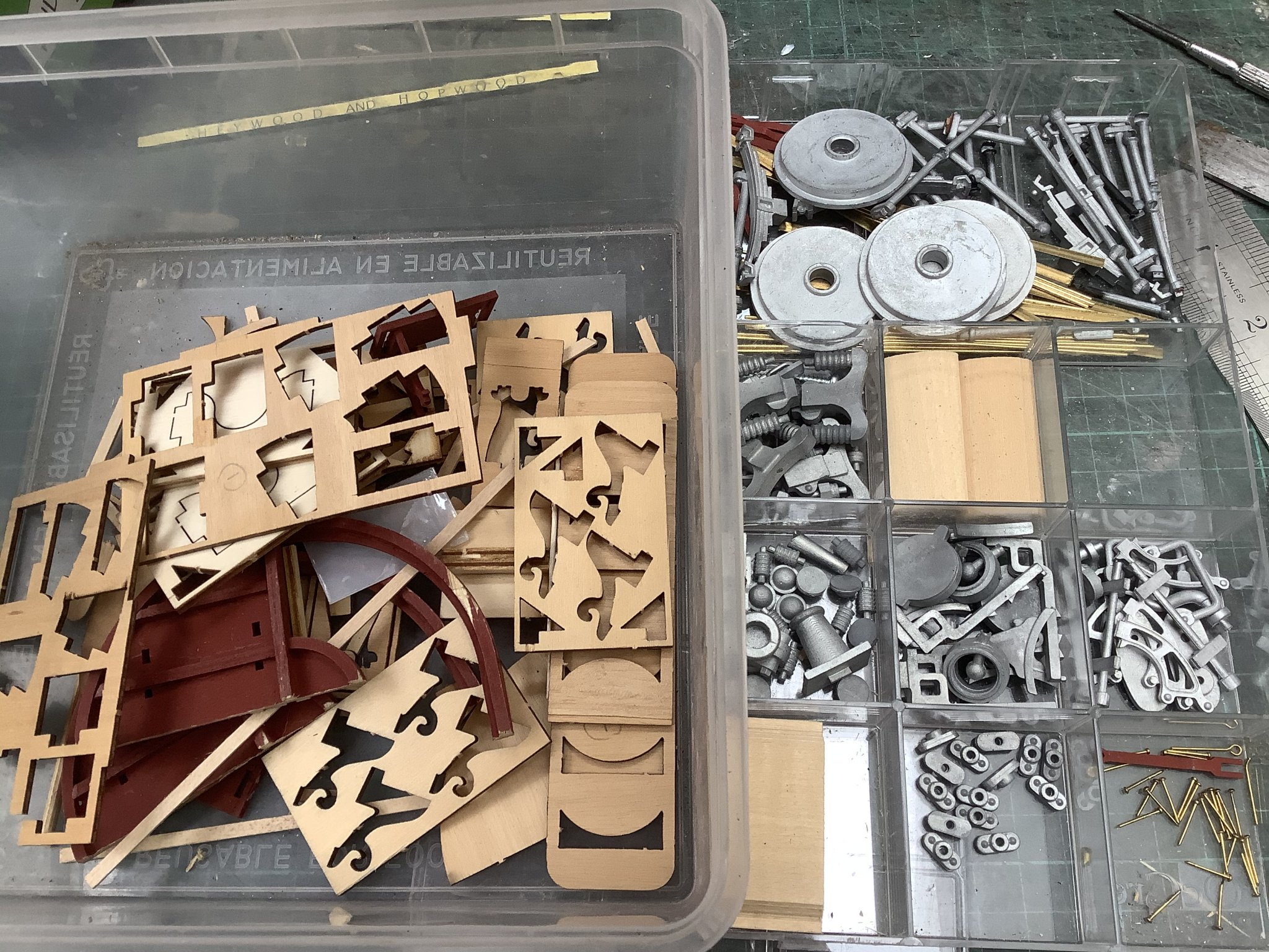

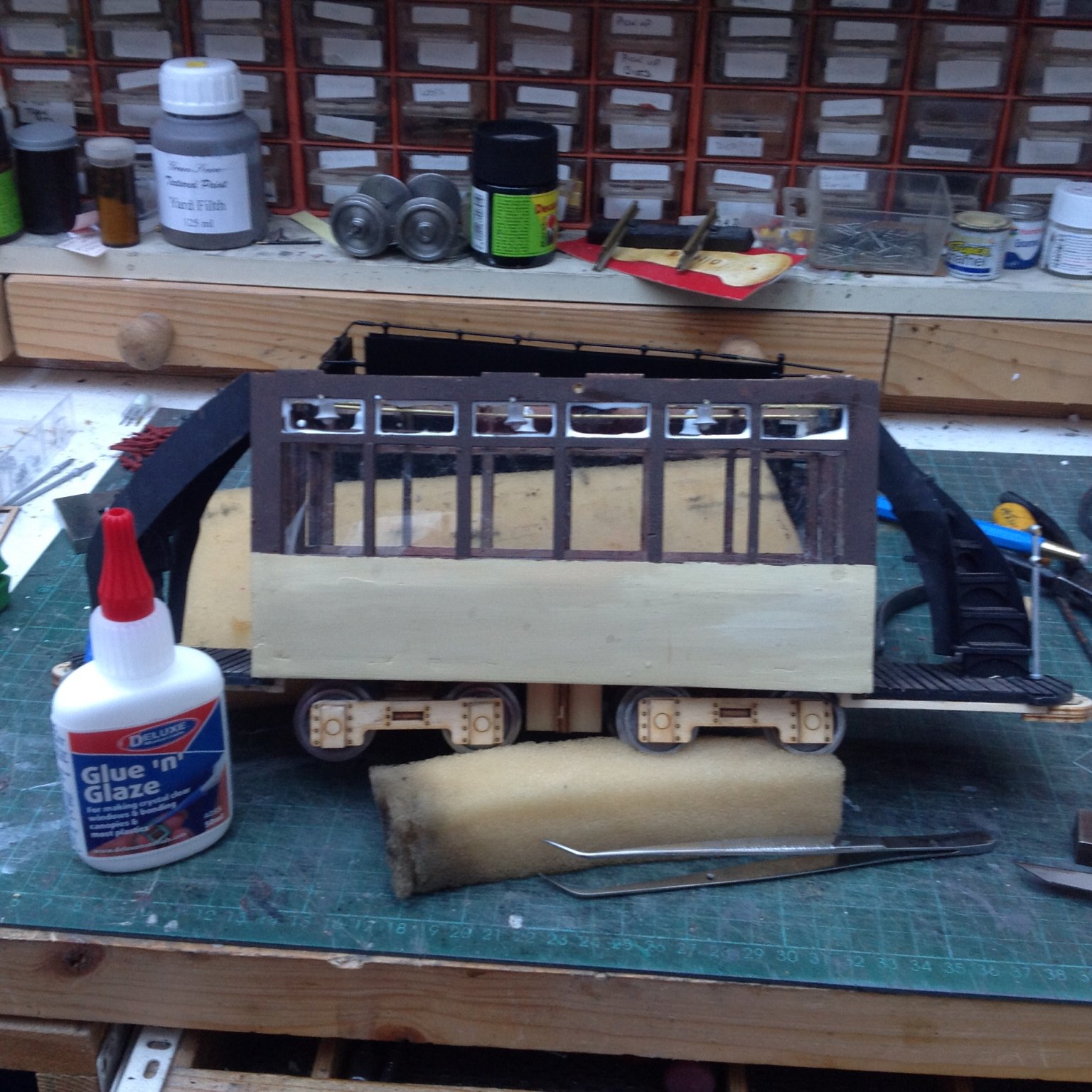

But the single deck was not much quicker either, it may seam that the job is tedious. Not a bit of it but not a kit for the impatient beginner! Glazing was inserted after much careful cutting using Glue ‘n’ Glaze to fill in the poor joints.

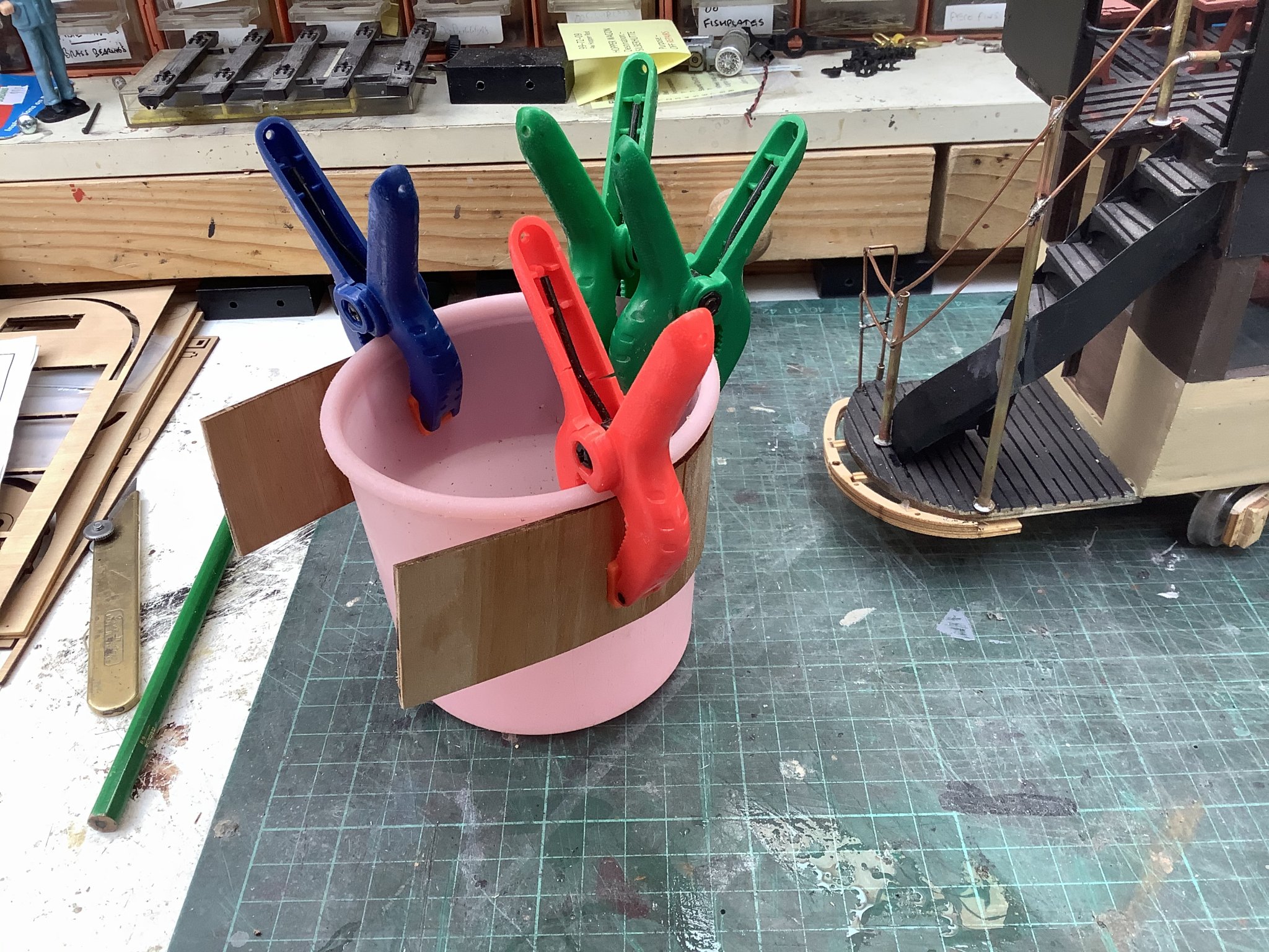

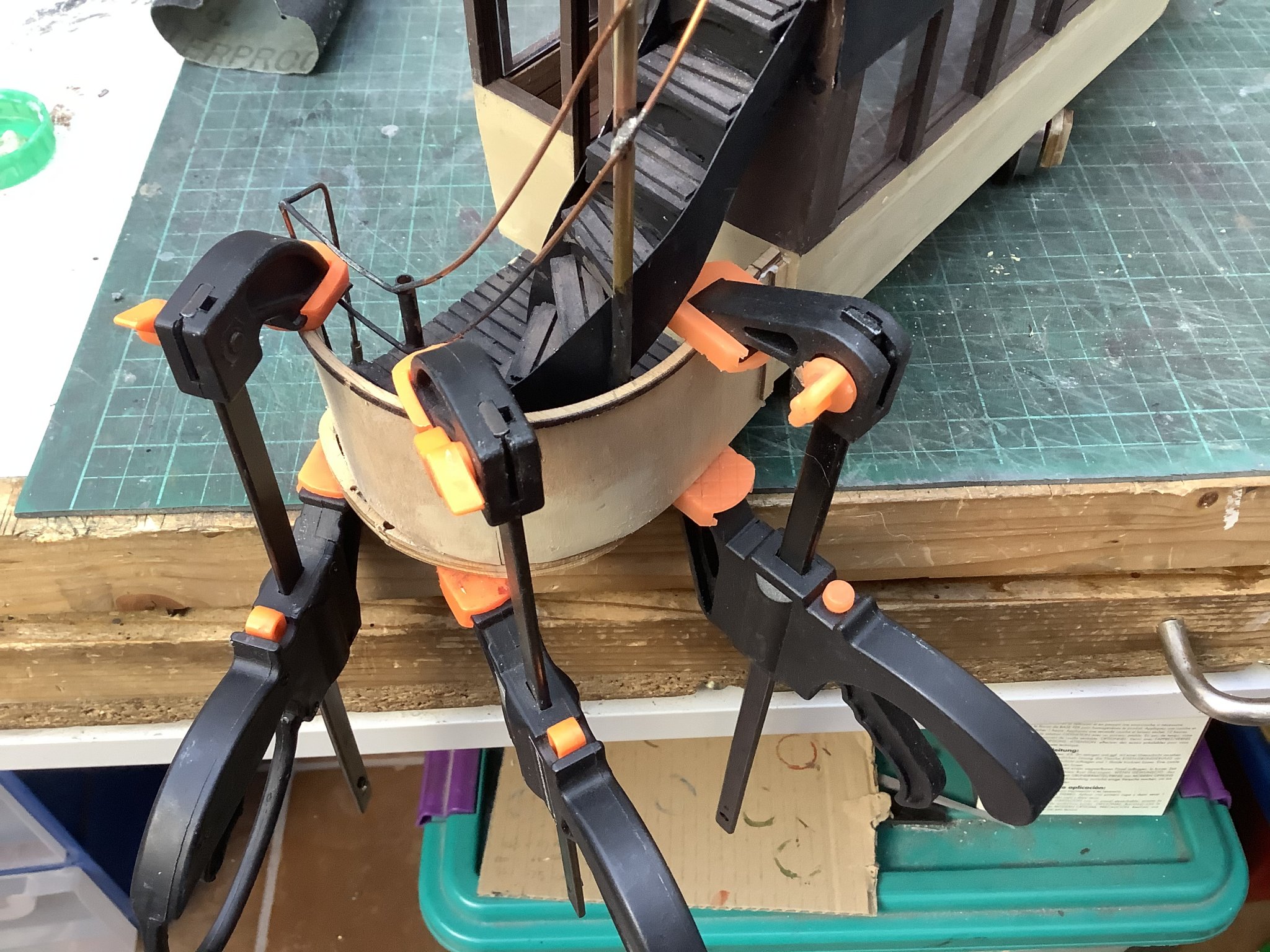

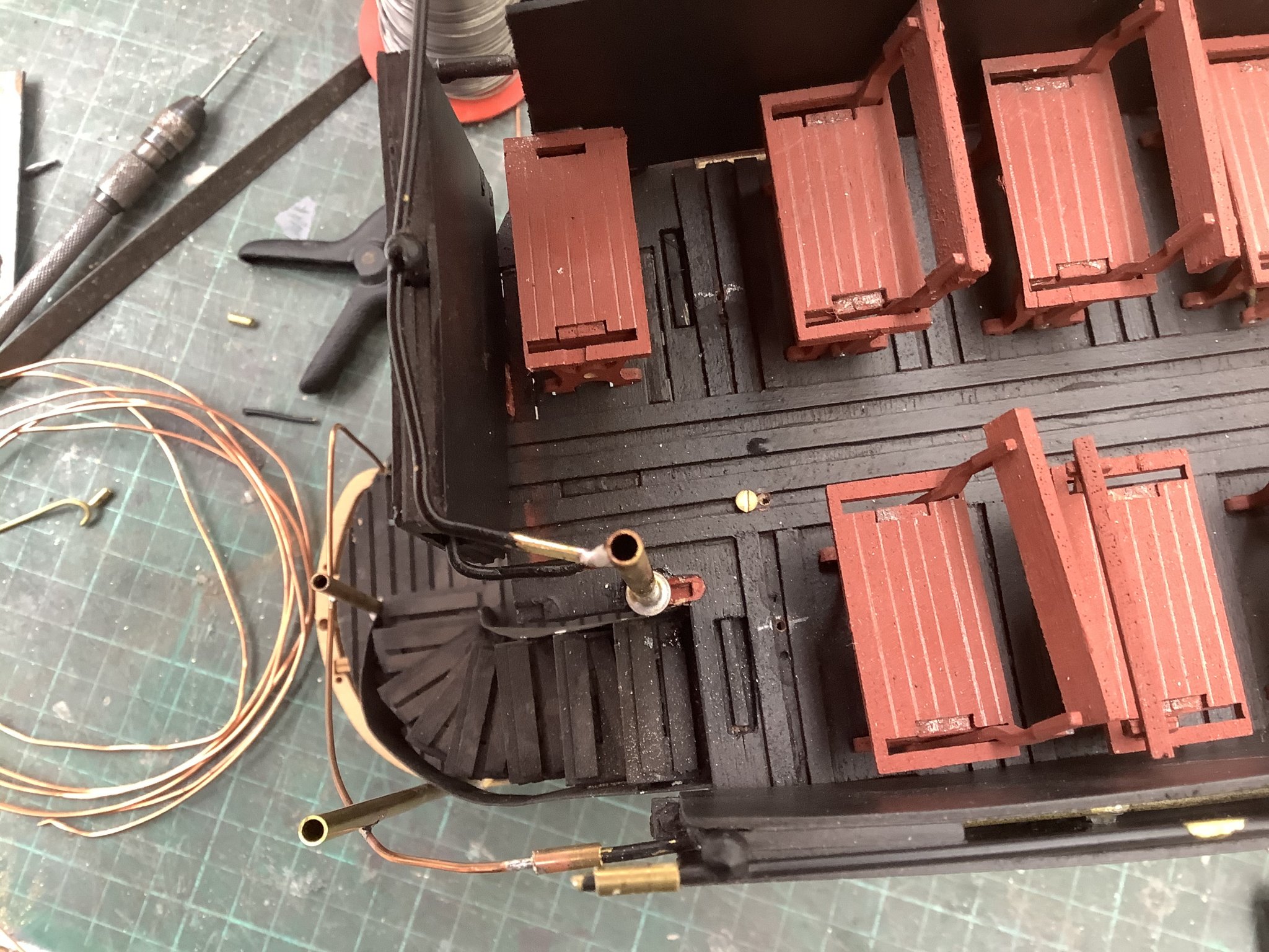

Curving the metal for the step sides was not the easiest of processes either.

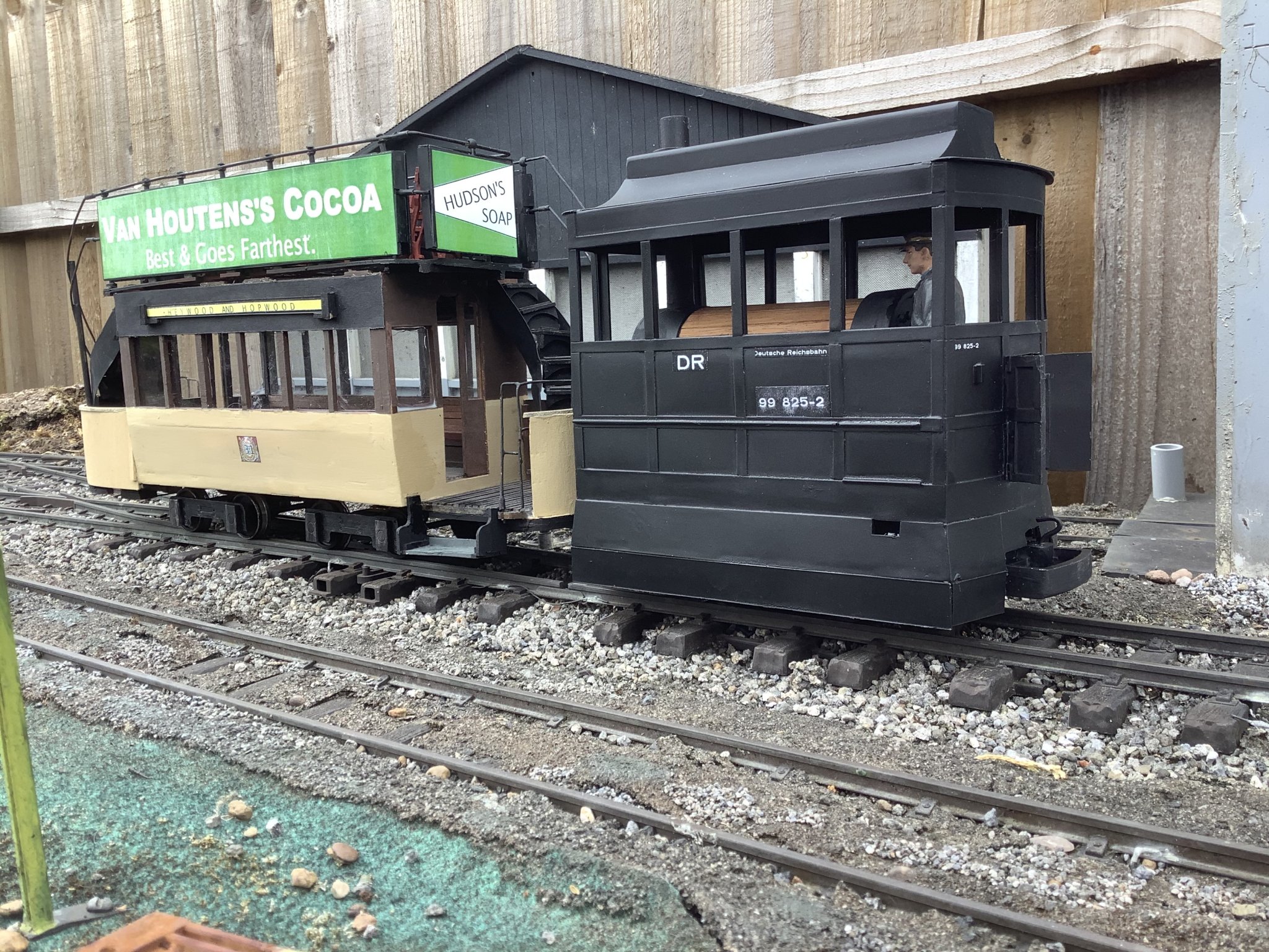

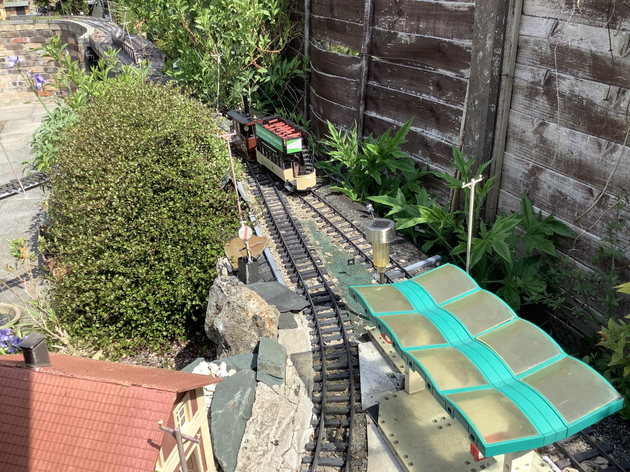

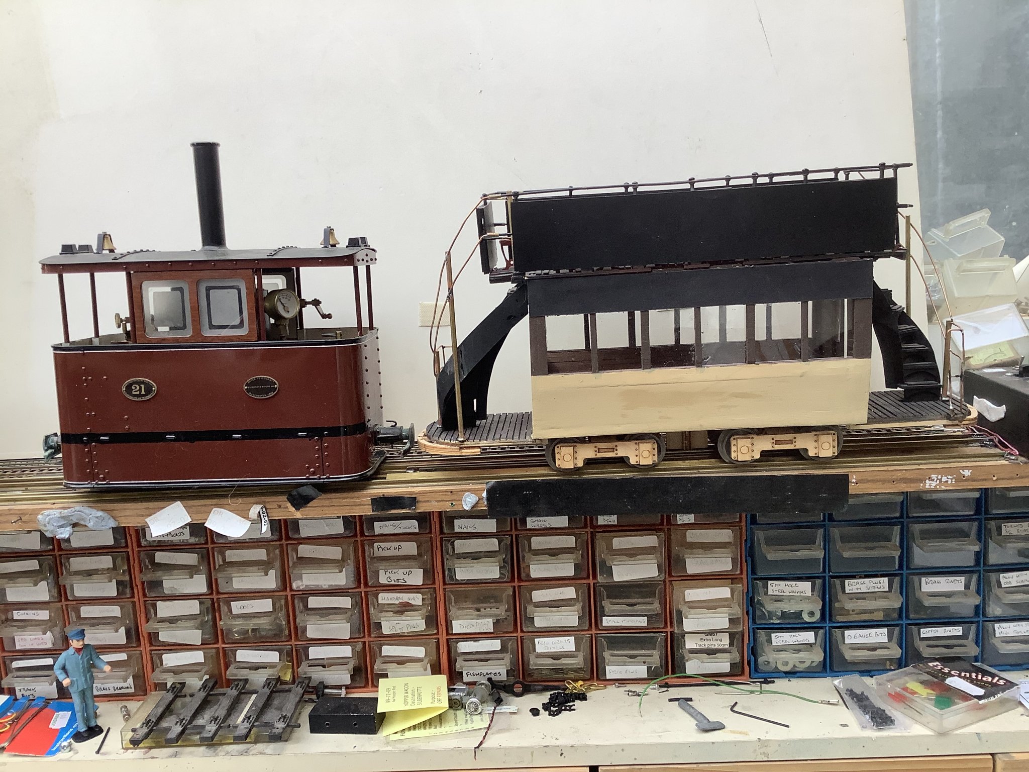

Here is a picture when the top to deck was mostly completed out in my line with the Peter Angus Steam Tram (buikt by Mike Flack).
