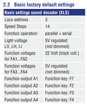

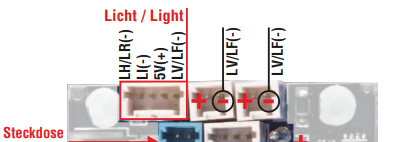

I have fitted a massoth onboard xls to an lgb tram, sound and motor functions work fine, now for the issue,
The headlights are quite dim, originally the bulbs were 5v, cv 50 read 131, I changed the bulbs to 24v and cv50 to a value of 30,
still they are dim,
any ideas?
I can use either 5v or 24v bulbs,
Thanks
