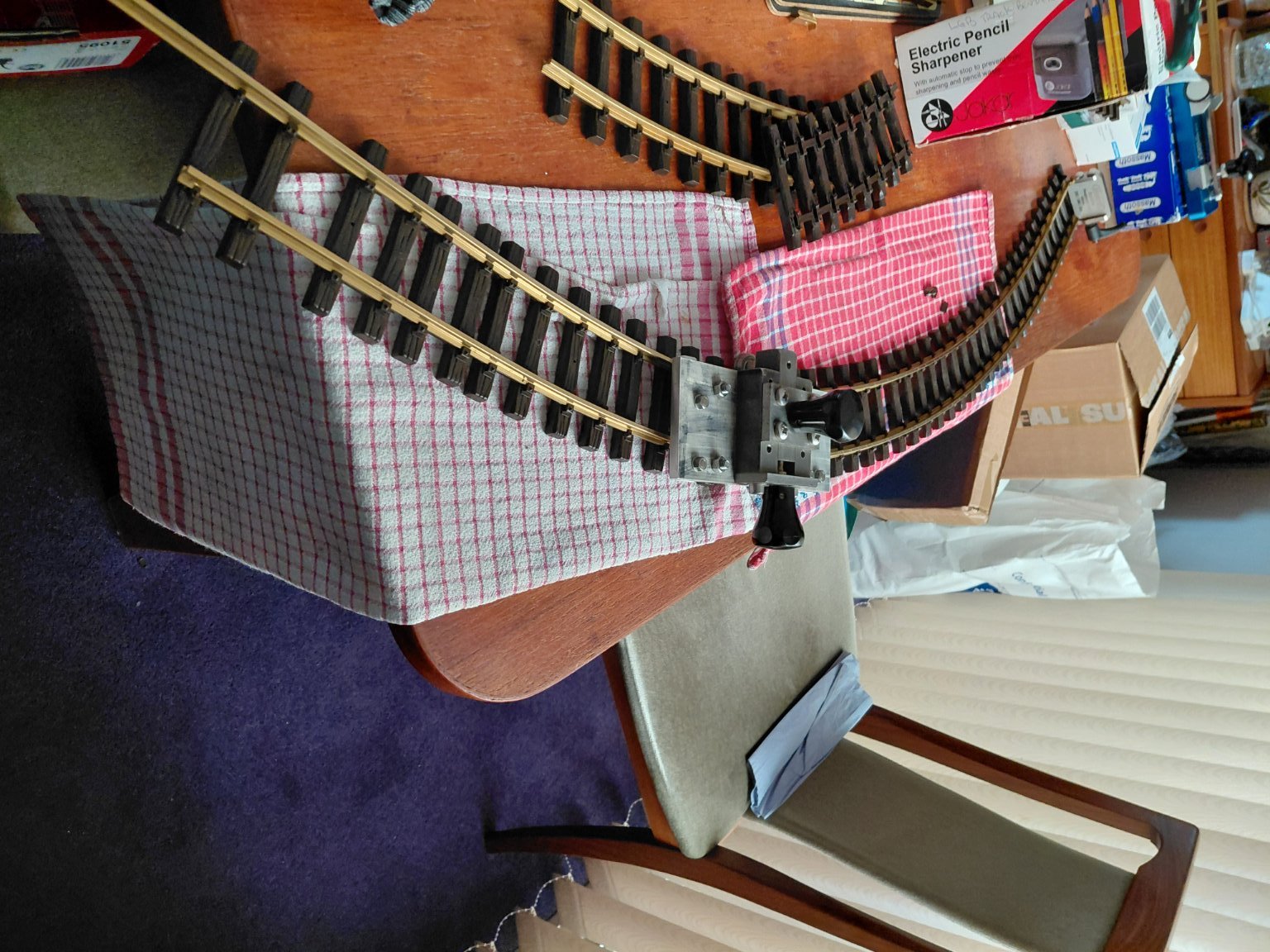

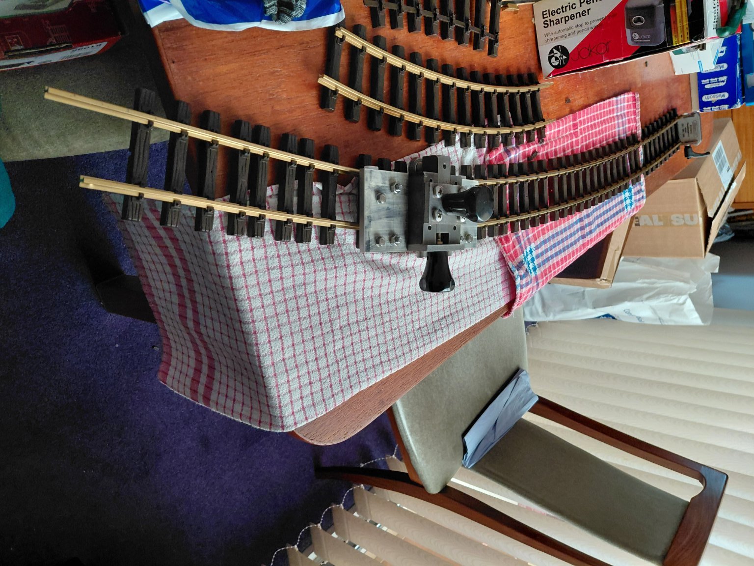

Ok some pics of mine. As Philip says you are clearly missing the rollers, these look much like a ball bearing and there should be 6 as you can see from my pice below.
Above with a length of rail in to show how it fits, but Inthink you may have already worked that out.
Above without some rail, felt line shows how rail sits in bender.
Above showing the top, I have given my self a reminder in felt to show how the bender works as it can be years between each time I use it! Noting the scale 0 is where you start, anti clockwise turn goes to less press with the rollers makes fitting the rails easier and clockwise moves the scale up thus pressing the rollers harder onto the rail and thus curving it.

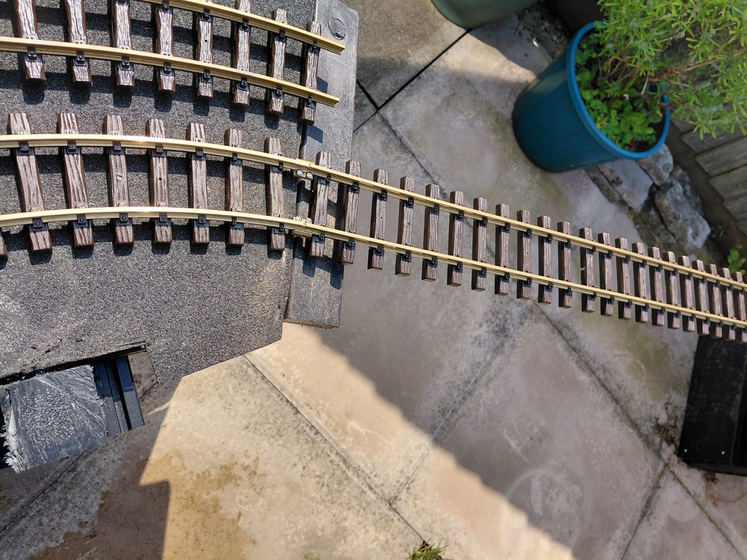

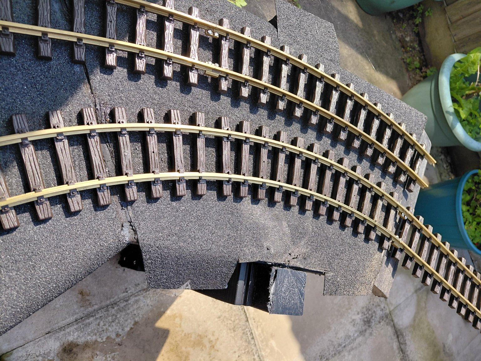

Afternoon Guy's Well we have made some progress.Sadly I had to use the other track bender as I could not get the massoth to work we are nearly there When it's dry later in the week I will replace the offending bit of track MyPartner has had to turn the handle/nob as I have lost all my muscle power in my arms in the latter stages of the bend.
