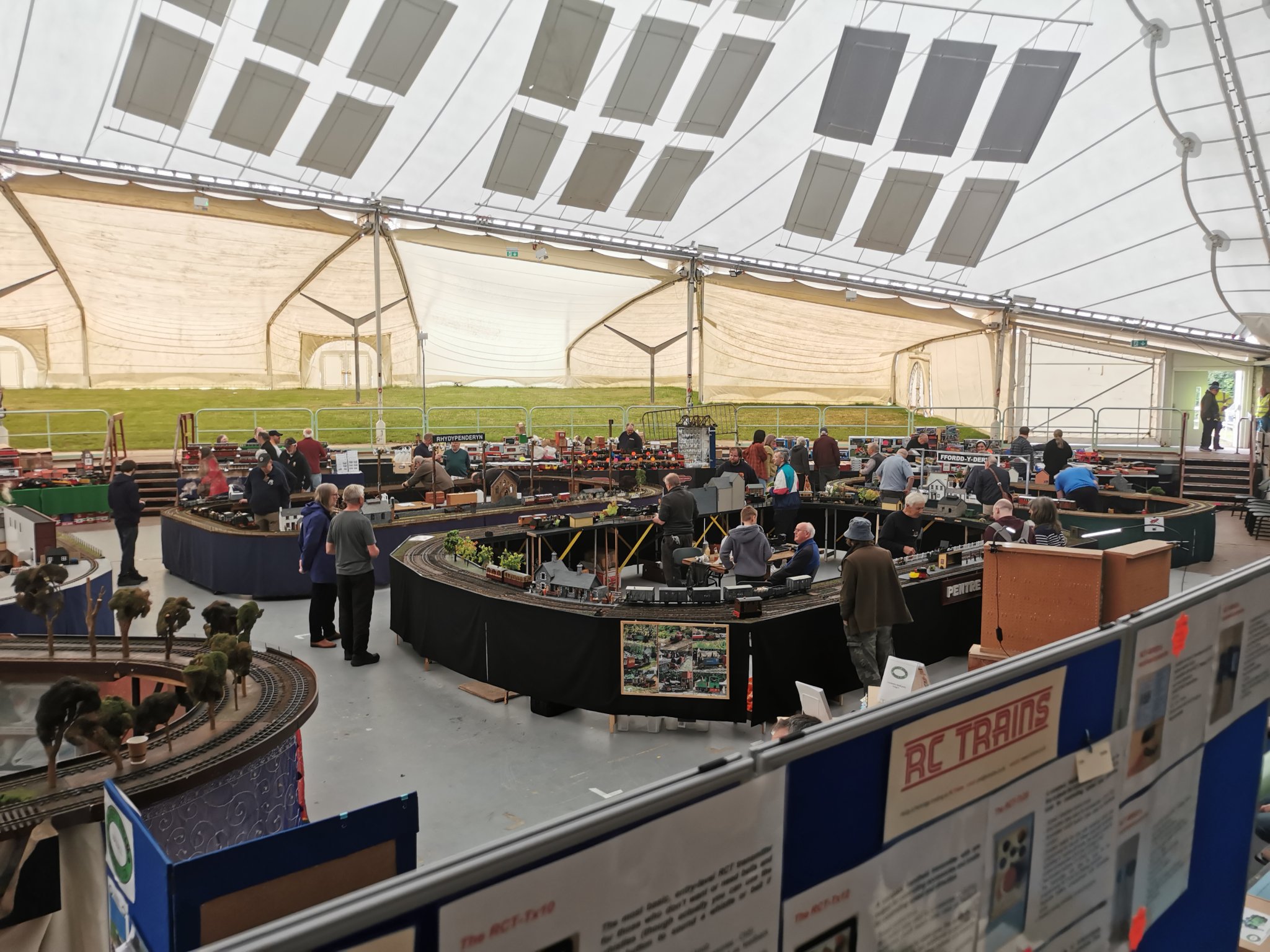

This year was the first year we had a chance to go over. My personal view that it was absolutely brilliant - really nice variety of layouts and traders on offer and, more crucially, something for a very excited 2 1/2 year old who was with us to get involved in. I have taken him to a number of shows (big and small model trains) and more often than not you're looking at a layout with more rolling stock value than your car so understandably signs requesting not to touch. However that's exactly what they're wired to want to do so was brilliant to have separate areas where children had the opportunity to do just that.
He had great fun with the Playmobil on the floor with a number of return visits and vigorous hand pointing in that direction when we were not there. He also had a great time building his own wagon using Lego as well and watching his completed creation go round the track once done.
I'd say at a very minor point the eating area was a little cramped at peak time compared to the likes of the Midlands show back in March which had generous table space upstairs however this didn't prove an issue - just that the room it was in got quite busy. Will definitely be back next year - a brilliant show!

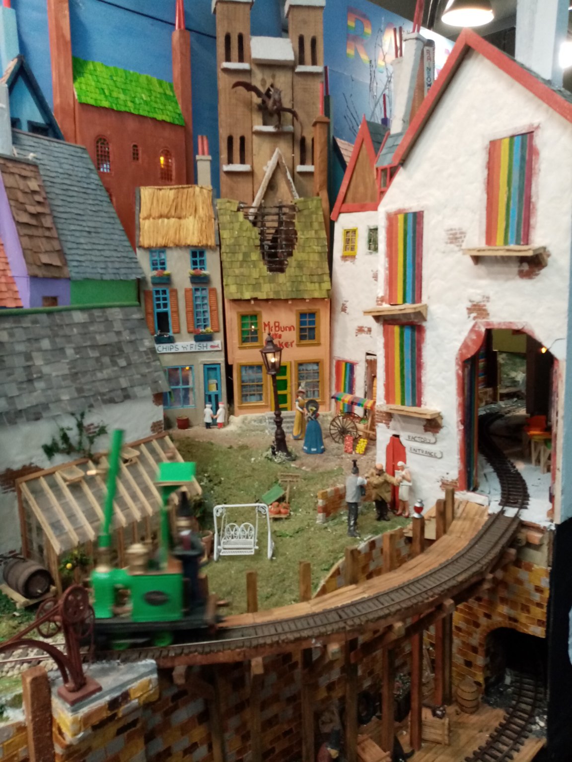

I bought a full circle of R5 track from Footplate, as I want to add a roundy round part to the railway, but I'm not sure why I left also carrying a rack locomotive. It will have to be built in on one of the slopes in the back garden. I do remember seeing some used rack inserts at the last trader on the left hand side, just before the steps up to the platform. Can anyone remember who that was please as I am going to have to acquire some? Frances was enthusing about the quirky nature of the Rainbow Rock layout, taking me over to look at it. It just goes to show that you never can tell. Browny points that builder.

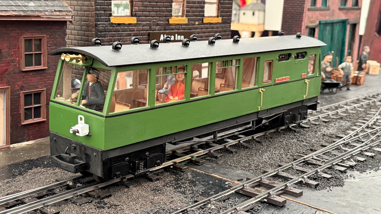

This was (I believe) on the 'modular' layout:
Image credit: Mike Docker.
Can anyone tell me if they are done as a kit, or if it is a conversion based on an observation coach, perhaps?
Thanks,
Hi Philip. I know the person who built that so will ask and get back to you. I was indeed on the modular layout. David
Hi Again Philip. Here is his answer.....
Nice to know it was appreciated! It's a converted IP Engineering Ataltic Observation coach. I was given the kit as a birthday present and decided it would be better as a double ended railbus. The 'cafe' end was closed off to hold the r/c and sound system. I made a new end to match the sloping one instead of the square end. Batteries are slung underneath. I did a write up of it for SMT which I think may have been published in about 2016/17. I started off with IP motor bogies but fairly quickly changed them for Essel ones, which made it end up a bit taller. As a consequence it really needs something else slung underneath and the steps extended down a bit for when it doesn't stop at a platform! They're on the list - one day!! Hope it helps.

David has taken a few pictures of Rainbow Rock, it looks fantastic, hopefully I'll be able see it the flesh (as it were) at some point. It must send Rivet Counters into meltdown though

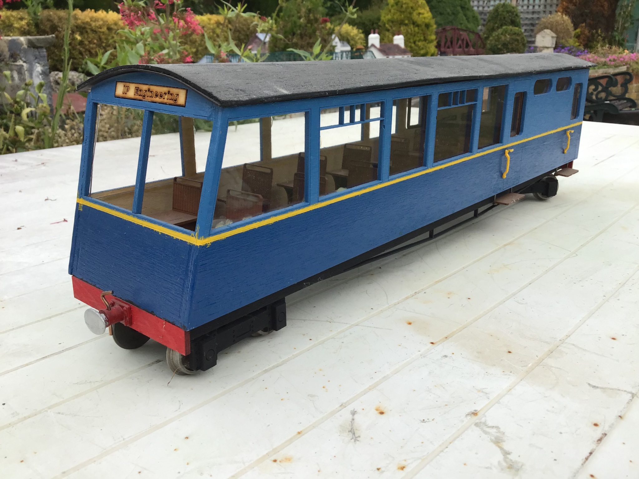

That’s sort of what it looks like as a coach, built a looooooooong time ago and in need of an upgrade…….I actually have another one the same!!
Dave
I have a memory that some time in the past a Magazine did a special Pullman car much like this, may have been 16mm Society or Garden Rail was I think produced by IP but memory fades! Perhaps someone else remembers this and has the time to research the mag. Most of my back numbers have been trashed now.
