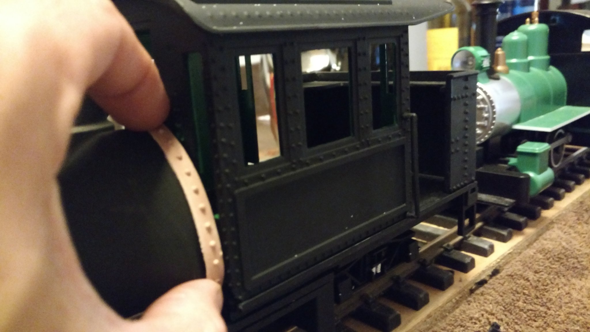

Lil big hualer saddle tank loco bash.

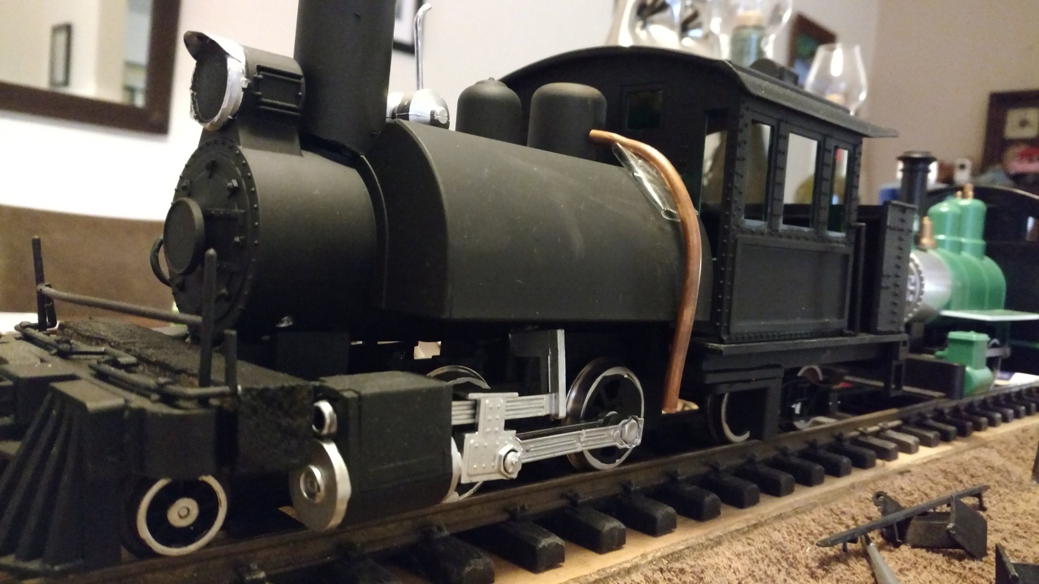

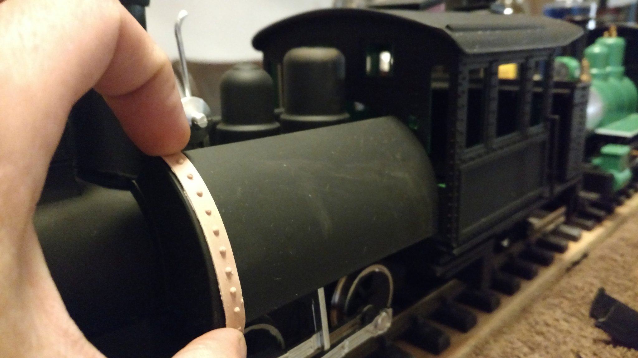

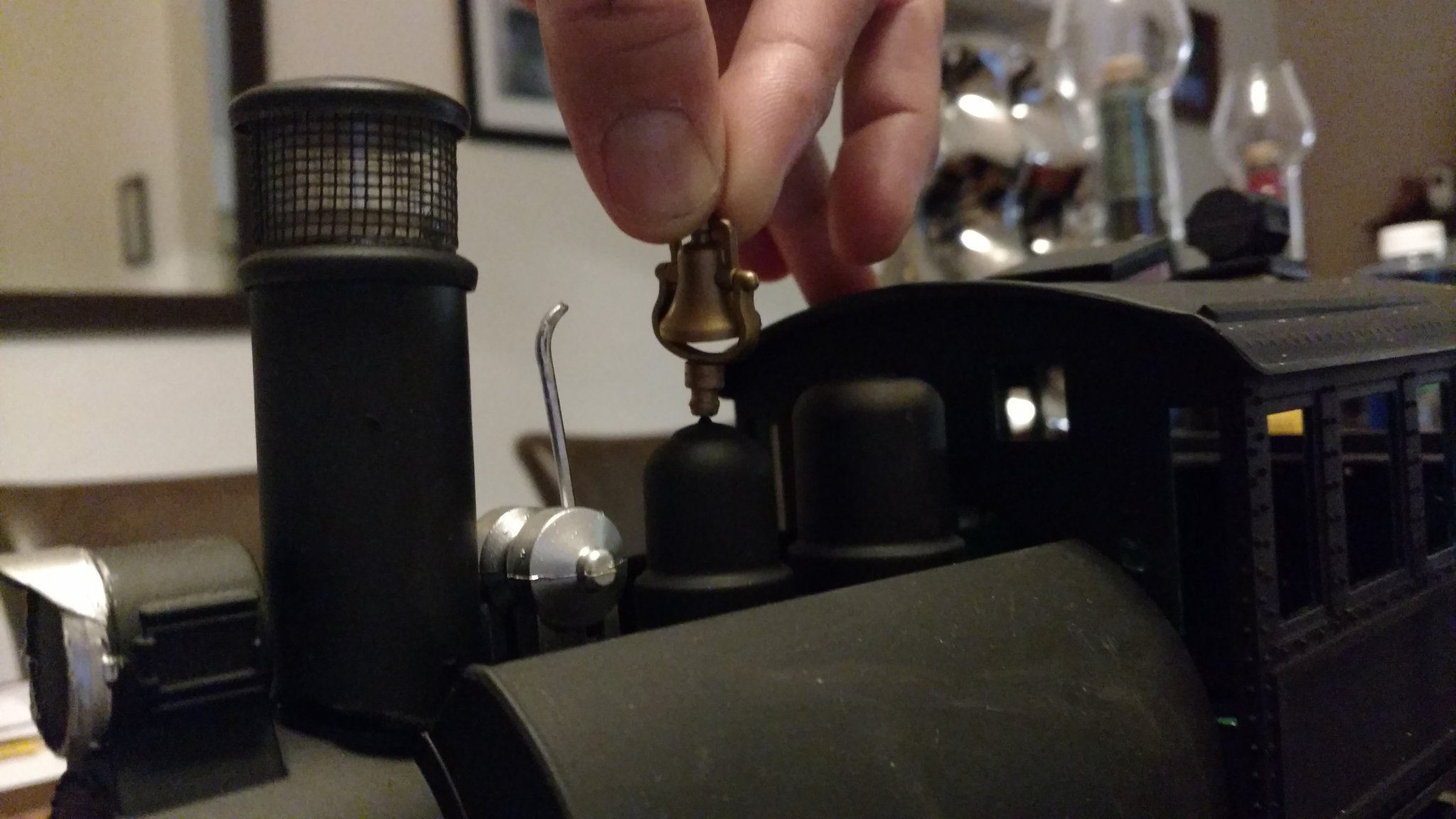

I am thinking of adding more detail parts from the big hualer. Generator,bell, whistle and a pipe on side things I've seen in pictures on loco's. I need to learn the placement of things so I can make it at least a little beliveable. And I am putting the rear light up on top of the cab roof. I also am thinking of putting these rivet strips I made on the tank. Not sure if I like it or not. This hobby is addicting now I've taken over the dining room table lol.IMG_20180122_095120741.jpg IMG_20180122_104807677.jpg IMG_20180122_095150398.jpg IMG_20180122_095159098.jpg IMG_20180122_104839026.jpg

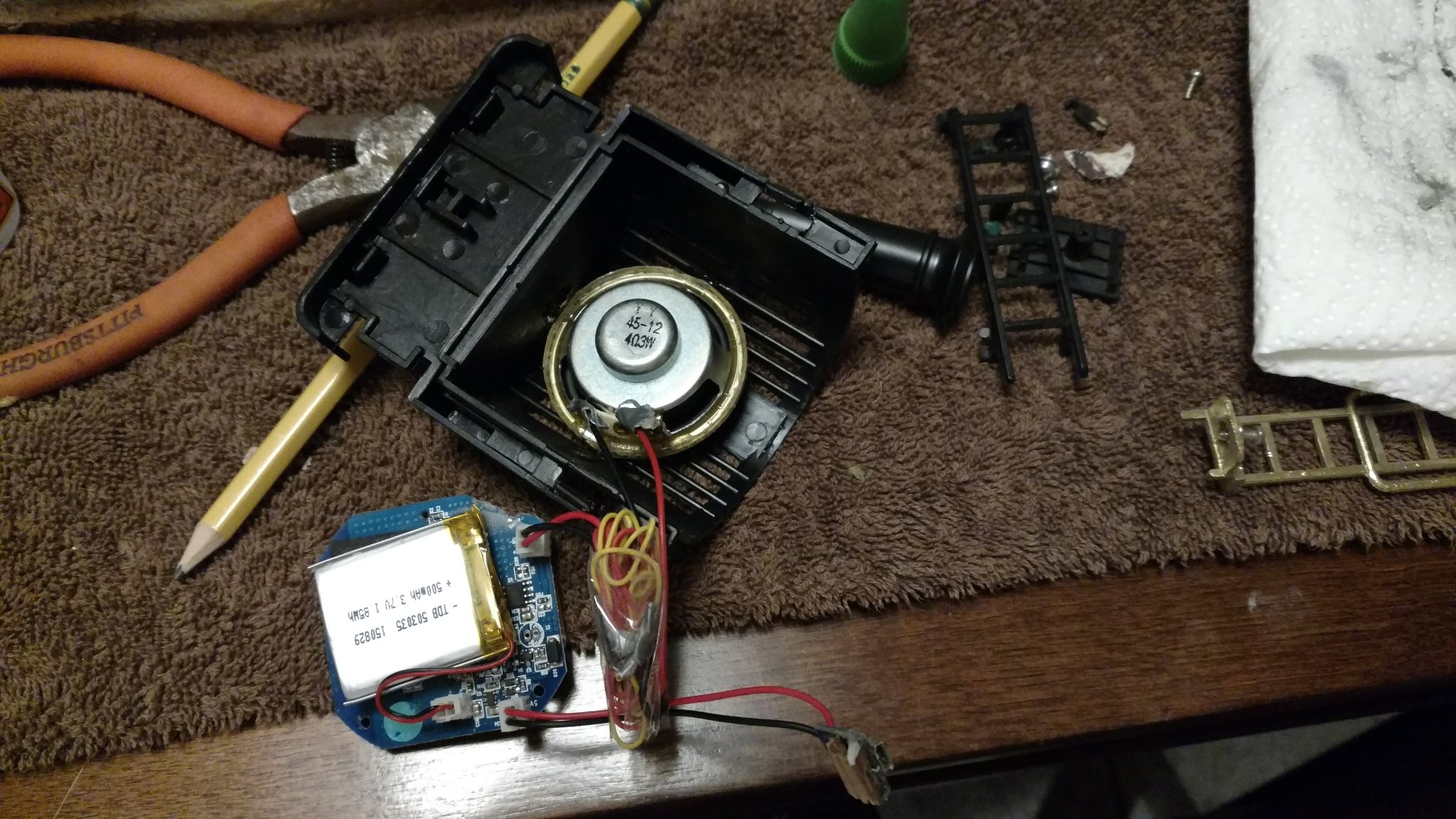

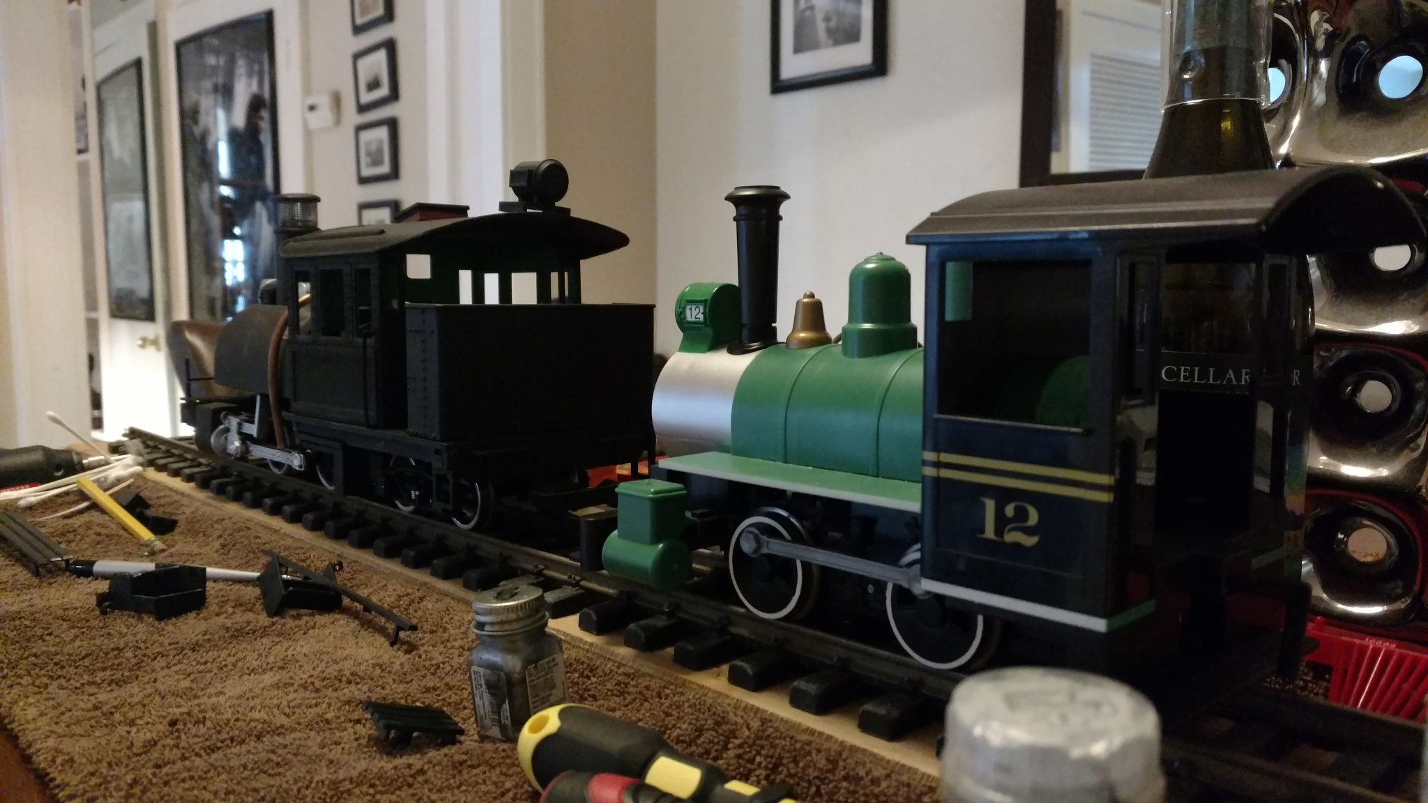

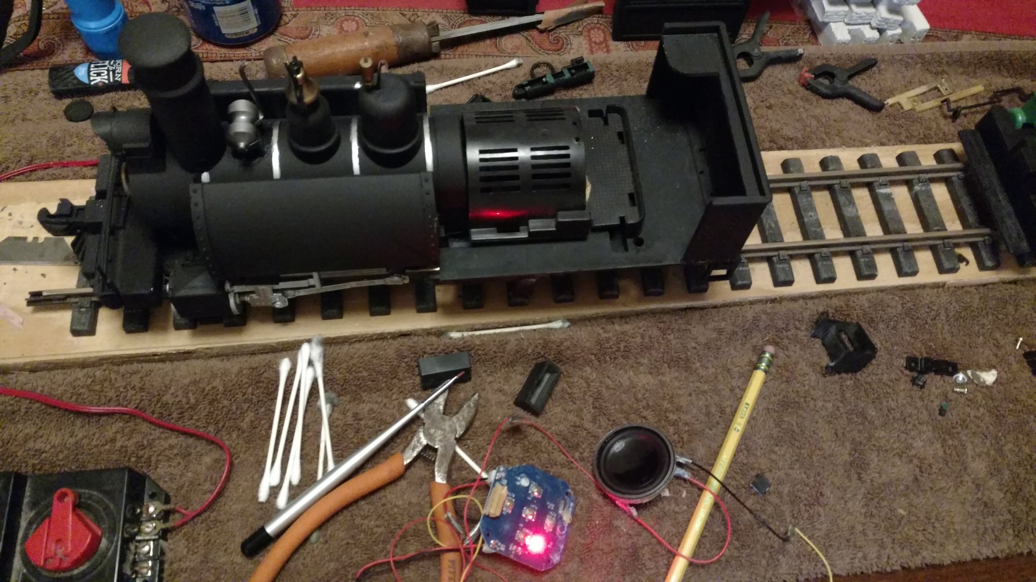

Ok . Getting some detail pieces on . And I had a old Bluetooth speaker that it took the guts out of that fits in the boiler with slits cut in it to let the sound out. I tried to do a outside track test today and it kept jumping the track. I never thought that it would be to long for two of my turnouts. They are 5 ft . I have purchased to New wide radius turnouts so it should fix the problem.IMG_20180123_005411109.jpg IMG_20180123_013155022.jpg IMG_20180122_104807677.jpg IMG_20180123_013155022.jpg
Ok . Getting some detail pieces on . And I had a old Bluetooth speaker that it took the guts out of that fits in the boiler with slits cut in it to let the sound out. I tried to do a outside track test today and it kept jumping the track. I never thought that it would be to long for two of my turnouts. They are 5 ft . I have purchased to New wide radius turnouts so it should fix the problem.View attachment 232365 View attachment 232366 View attachment 232367 View attachment 232366
Think I would be inclined to do a a retest to see exactly what is causeing the Jumping Off the track. If you do this really slow with your eye close to the track the cause will become immediately apparent and a solution possibly observed. My inclination would be to say that the Pony Wheels or Bogie are binding somewhere on the Bodywork. Might be possible to shave something off to resolve your problem.
