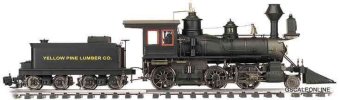

Here are two photos of the girls (not my ones)
K36
K28
