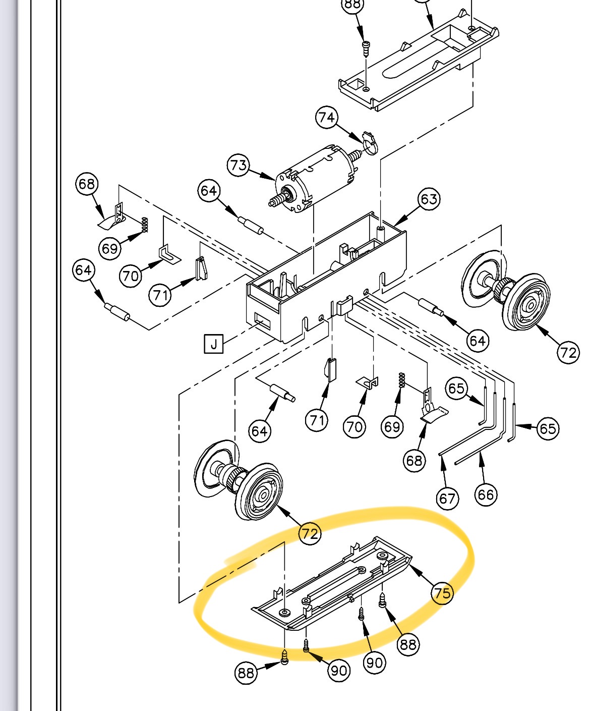

If it not getting power in from either of the pick ups on the two motor blocks and thus triggering the lights ( from my experience it only needs one to work for power, and it doenst have a panto) I bet the main board is the problem, somethings fried or unsoldered/uncliped . Sould be easy to open this up. I look forward to hearing about this mystery. Parts Diag below.
https://www.gbdb.info/data/zeichnung/LGB/23510.pdf
Ah ha, it was your good self that got that lovely looking Diesel from the SAS sale, think it had been returned from another sale the auctioneer said before it was opened up for sale. Thought it might be a good RC conversion because of that as you remove all the gubbings inside.
