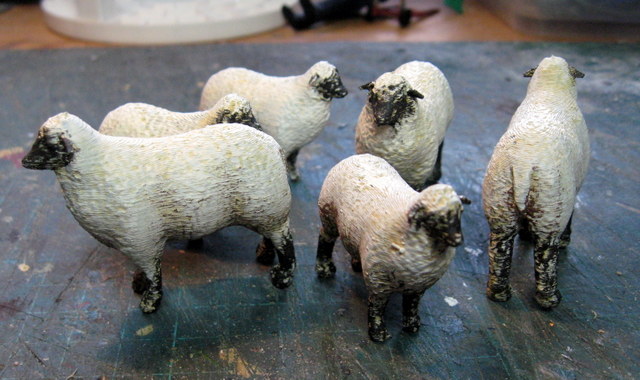

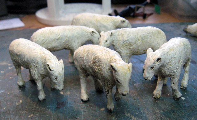

Sheep:
An off-white, with a hint of yellow, and sheep-nuts! - 'Acrylic Lanolin' comes to mind.. :think:
:rofl::rofl::rofl:
