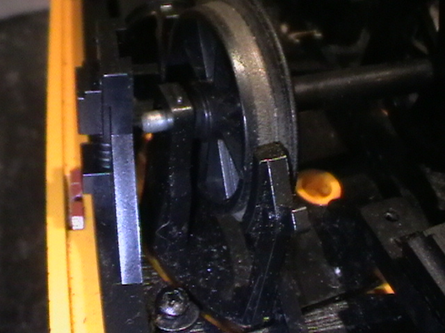

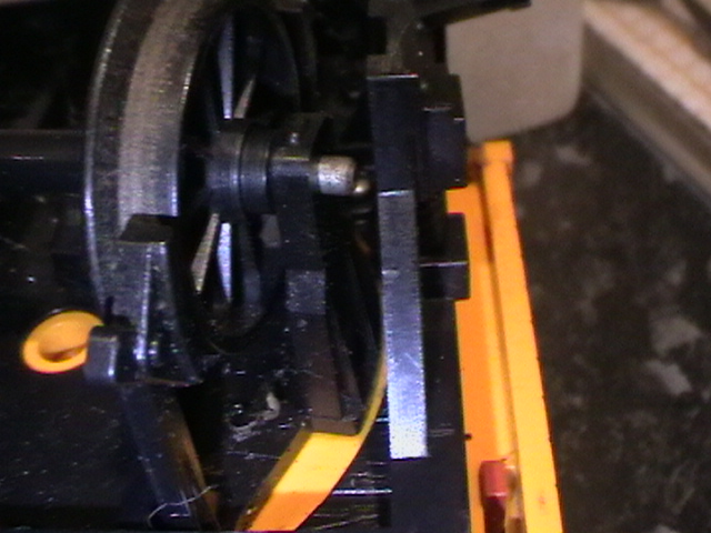

Hopefully I have attached photographs of the wheels and axles of my carriages showing the way the wheel axles are secured to the vehicle.
It is different to that shown in the other picture. I'm still doubtful about removing these so I'm not going to touch them.

They turned out fine...we just have to click in the picture and it enlarges, they show your situation rather well.
It shows that you just have to put a drop of lubricant on the axels where they go through the "Bearing" rather simple... You don't need to remove the wheels at all.

The wheels and their mounting are exactly the same on my coaches. When I can, I change my plastic wheelsets for metal - but that's my preference. As Fred says, if you don't need to remove them.....
