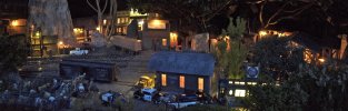

When I first put lighting into and onto my buildings and street lamps, I was using 19V tungsten bulbs (some screw-in and some just wired).
There were a lot of them and so I was using LGB 1amp power supply/controllers in parallel to supply the necessary power (two sets, one of three units and one set of two units). These LGB units have been working for over six years stored in the open under a cover.
A few years ago I found a fairly cheap resource on ebay for replacing the tungsten bulbs with a non-polarity sensitive screw-in LED variety (5,5 screw size) and also self adhesive led stip.
I have now got a mixed tungsten/led array and will gradually replace all the tungsten screw in ones and then the wired ones (with 5,5 screw in bulb connectors and led bulbs or led strip).
I can now cut down the number of LGB power supplies as there is less power needed and also know that they will cut out if anything untoward happens.
