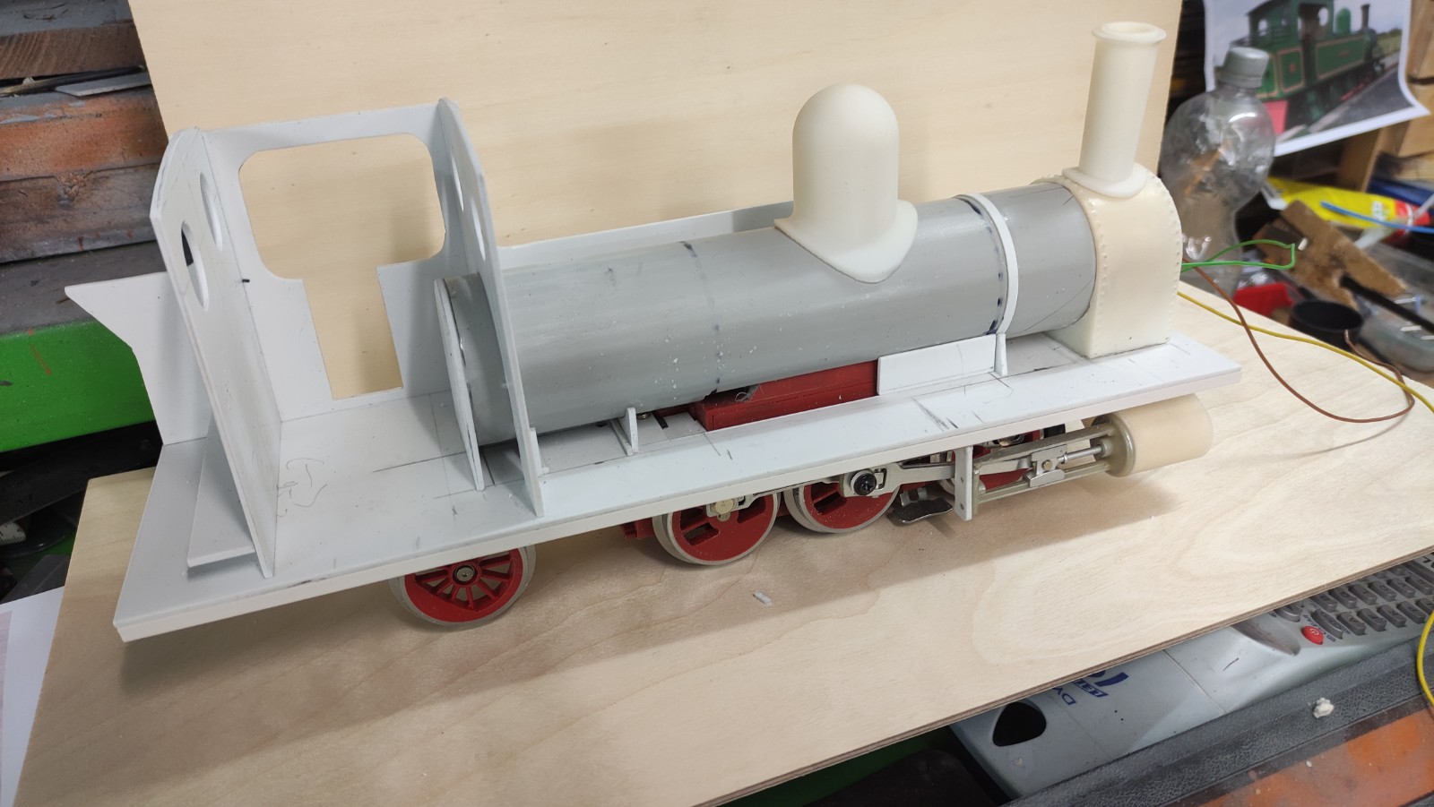

Hello together,
Here is my latest project. I would like to build a locomotive to go with my "West Clare Railway". I have chosen the only surviving locomotive as a prototype. It will not be a scale replica. As with me, I just want the picture to be right. I have found several pictures of the "Slieve Callan" in the internet.
The motor is old and comes from the "LGB Spreewald Lok 2074", but it is unused.
The loco is built in a scale of 1:22,5, but the proportions are adapted to the drive. The boiler is a piece of tube, the rest is made of 2mm polystyrene. Some complicated parts I have 3D printed.
I plan to run this loco with battery and radio.

Fantastic! Very tidy modelling with the polystyrene and the 3D parts look great too. look forward to seeing this progress.

Andreas, if you are going to run this on battery, I would remove the skates as they provide no use at all, but also disconnect all the pick ups from the wheels. You may think this does not matter, however is any thing is connected to the track then the power from your battery will run to it, minor problem it may not work, major problem could short out the circuit, Oh and on that subject ensure you have the correct type of fuse close to the battery to prevent any unwanted fires :)
I applaud your intention and your achievement to date, but it does remind me of my own frustration when pondering on replicating locos from the Irish narrow gauge lines.
Slieve Callan has 4 foot driving wheels (and, unusually, the trailing wheels are the same diameter!) which would equate to 54mm at 1:22.5.
The most common wheel diameters on LGB steam engine motor blocks are 37.5mm (as on the Spreewald) and 46.5mm (American Mogul). The only LGB loco I'm aware of that has wheels of virtually the right diameter for Slieve Callan would be the Mikado, assuming this retailer's list of replacement traction tyres is correct . . .
And then, of course, the LGB motor blocks tend to have very short fixed wheelbases. That on the Spreewald is around 100mm whereas the prototype's 9' 6" fixed wheelbase would need 128mm.
When I put a scratchbuilt body on a Spreewald chassis, this all led me to "go freelance" (even though I hoped the result had "Irish leanings"). I was fortunate enough (right place, right time) to purchase (second-hand) a hand-built model of Blanche (Donegal Railway class 5A). It has a brass chassis by Pete (?) Janes using the driving wheels and motor from an LGB American Mogul. Fortunately, the fixed wheelbase is fairly close to the prototype, but the driving wheels are undersized (46.5mm rather than the 54mm needed). i'm still working out how it got smuggled out of the UlsterTransport Museum to operate on my line. Maybe I need to get a set of plates for one of Blanche's two twin sisters. Distorting history to rescue a loco from a scrap merchant is more plausible than nicking one from a museum!
The good news in all this, though, is that a model that has been hand-built is regarded (by those "in the know") as something special (when compared to the "straight out of the box" alternatives) so precise fidelity to scale is not the most important aspect.

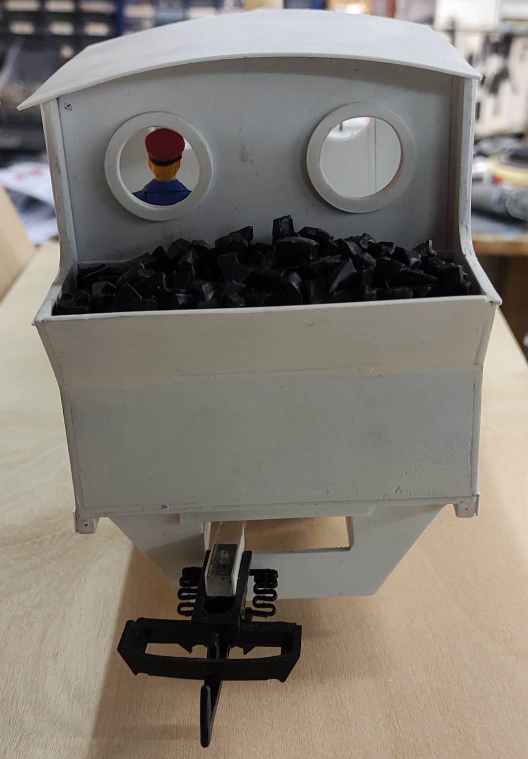

The superstructure of the locomotive is almost finished. All the current collectors have been removed from the engine.
The power supply is 4 Li-Io cells. I have installed the batteries in 2 battery holders in the water boxes. This way I can take the batteries out to charge them.
The batteries hang on a protection board. The receiver and speed controller are from Fosworks.
It's a great system. Playing with the locomotive and the radio hand controller is much better than track power and the cable controllers.
I think I will gradually convert my locomotives where possible
I must admit - the top speed is very fast - too fast - I noticed it in the film.

I have continued building a little.
Not perfect, but I like it and the locomotive looks good. The optical impression is harmonic.
What do you think about the name? Should I call the loco "Slieve Callan" although it is / will be a free replica or should I find a phantasy name?
I have set the speed controller to power curve 3, so the locomotive is slower (approx. 40 Km/h max).
The Loco weighs a total of 2.5 kg. The Foswork technique works very well. driving....

Hello together,
the first test drive of my almost finished Slieve Callan. I think she looks good. Not quite the original, but I think who knows her knows what I want to represent. A nice driver and stoker are still missing. And maybe one or the other little detail...
