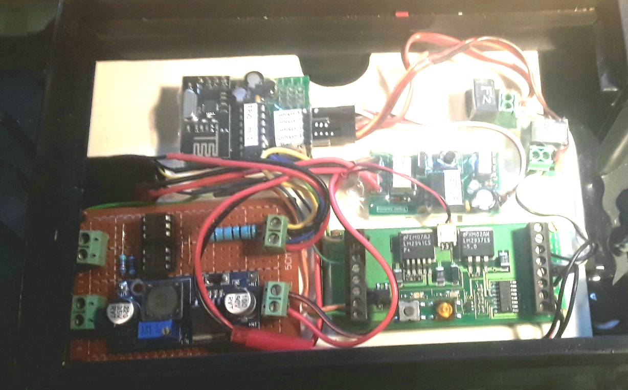

A Sierra can work with modern ESC's that output PWM. However, you really need to interpose a bridge rectifier between the Sierra and the ESC' so that the Sierra gets a smooth DC power supply. Additionally, you need to place a voltage regulator (only) between the traction battery and stay alive functions on the Sierra, as these are usually above the 7.5v the Sierra needs.
Problem is finding a bridge rectifier. John Scanlon, formerly of this parish, made me one that also included a voltage regulator on separate circuit on the card (installed in my Accy K-27). I also use the, now sadly defunct, RCS SSI-9 device, that combined the same functions into one neat package. My 2 Bachman K-27's and a Climax use this in conjuction with their Sierras.
We all love our Sierras but you may have to bite the bullet and look at something like the ESU card allied with an appropriate TX & RX. I did a couple of years ago. The sound fidelity of the ESU cards is excellent. The important bit is getting a good speaker and enclosure to optimise tha quality.
My K-27 sound installation as described above
ESU/Fosworks equipped Bachman Heisler and Mk2 Climax Sierra/RCS equipped.
RC sound installation on my Accy' K-27. Joh's bespoke PWM smoother/voltage regulator card bottom left, Sierra on the right, ESC above the Sierra, RX on top left. The 2 little boxes top right are onto triggers for non automated sounds. All controlled from an Omni 2 (Timpdon) TX. It can be done. Look at where the wires go. The top line on John's card is cleaning up the feed from the ESC, the bottom the voltage regulator for the "stay alive". Somebody may recognise the bits to make a replica. Happy to take more detailed pics to help identification of components.
