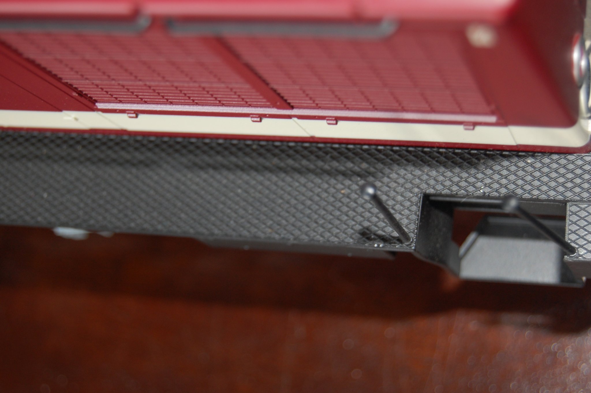

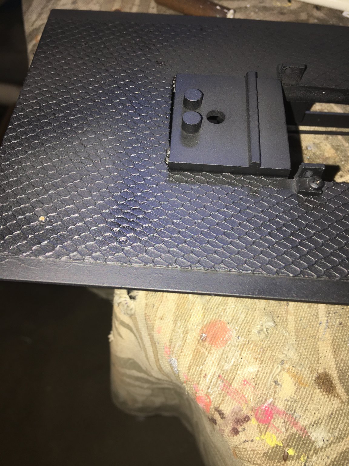

Doh!Another method:
Rough the surface of some Plasticard (a little thinner than you want the finished item. A good adhesive is then required, and stick some 'car body filler reinforcing mesh' to the plasticard. Weight it down well, and leave to dry..
Then spray a liberal coat of 'primer-filler' (spray-putty) to fill any 'voids' between mesh and plasticard. - Not too much!
