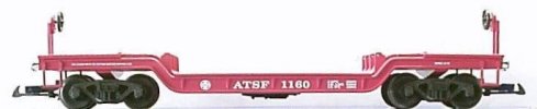

Next project....
After the Heavy Load Center Depressed Car i have started on a new project a depressed Center Flat Car after inspiration from USA Trains models.
ro-usa-trains-americanseries-scale-f_1_0e78d5939c59533c39c942a15a7abc61 (1).jpg
I'm modeling in Autodesk Inventor, and it always interesting to think how to create a model.
I have decided to spilt it in 3 major parts the same way as the Heavy load car, and split it in to frame & deck
