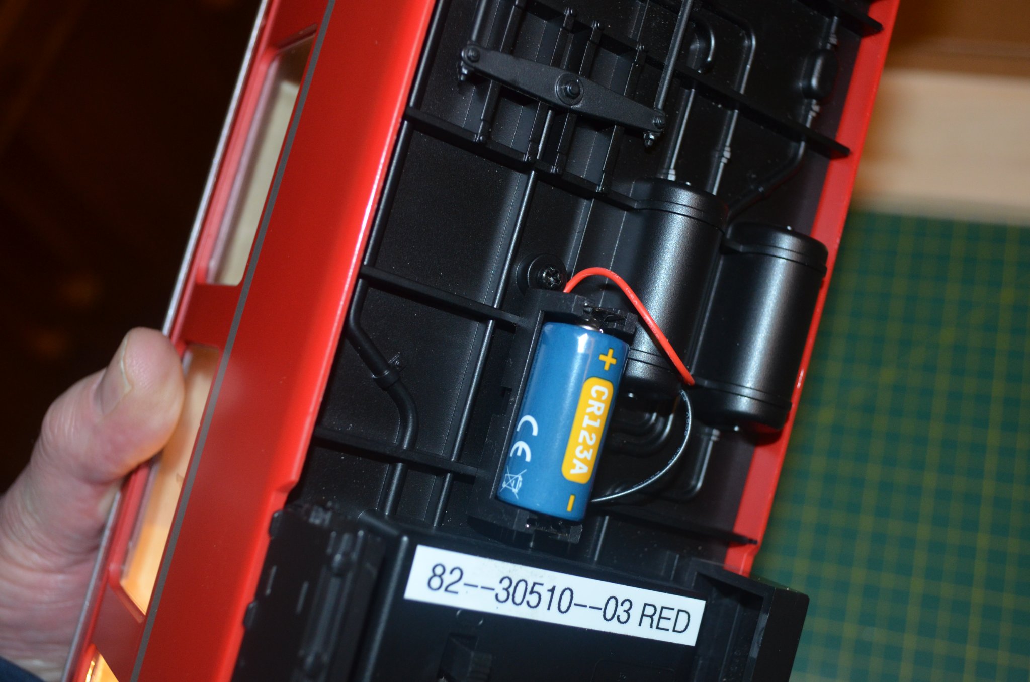

Trying to figure out if I can run my DC Crossing Gate. With my newly converted DCC stainz. DCC is a giant leap forward in the realism on our layouts!

You should be able to with a DC power supply. I run DC (battery power) light on my station whilst running the trains and point on DCC.
With the caviat, of don't interconnect both the Dc and DCC supplies.
Agree with Nod, run a separate bus for DC accessories, whether DC or DCC, is best practise....
