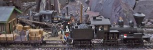

I used the `black background` method to make the decals for these locos and stock cars:

Mr Beckett sir, The crane is based on the Pola yard crane kit. I did not use the `helmet` roof and titivated it a little.
A few more views to give the flavour:
