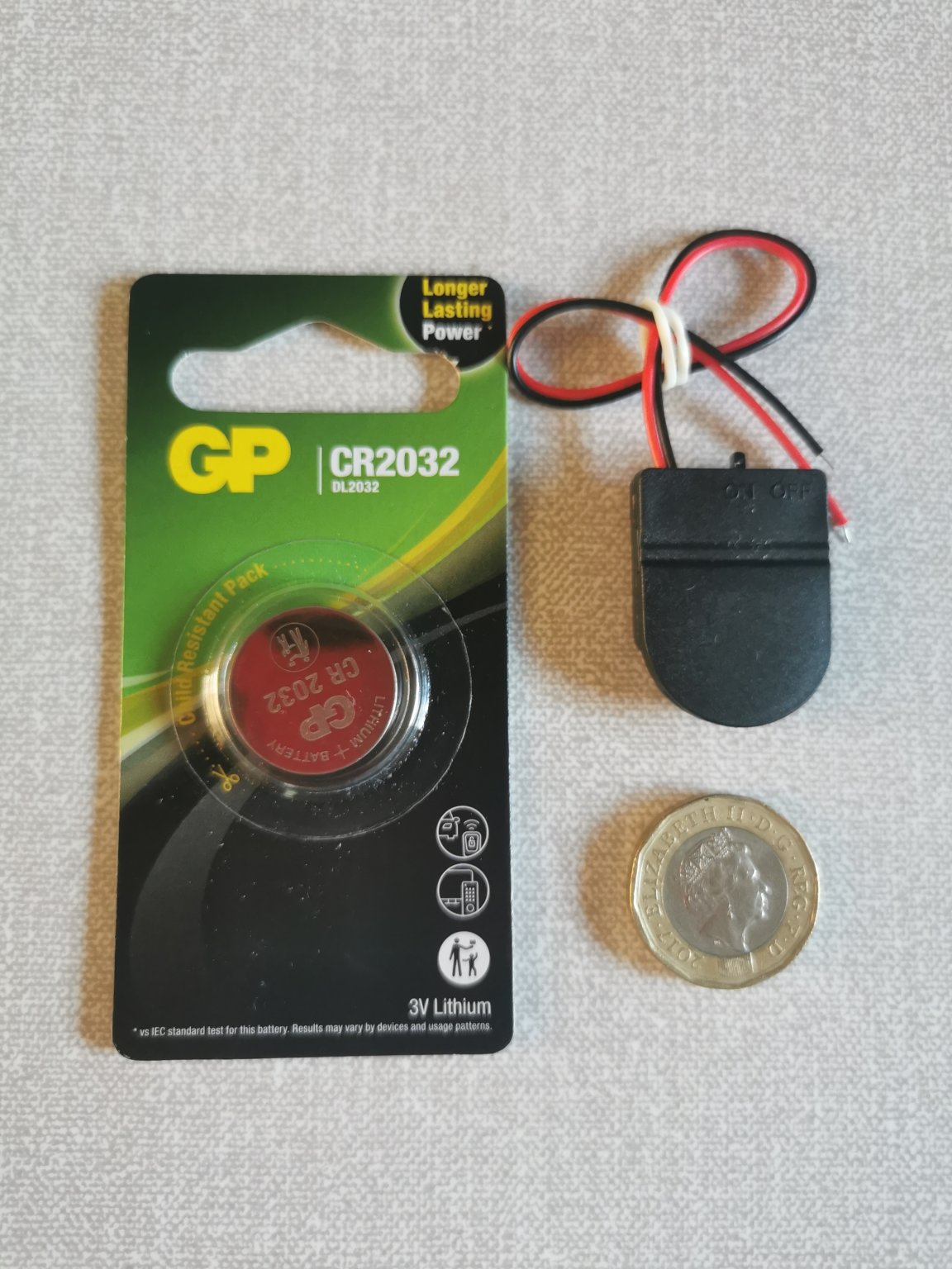

A 123a battery is huge for this. - If using LEDs..
Two or three LEDs and one of these:
There is even a switch on the battery box. - 'Thatcher' not included..
