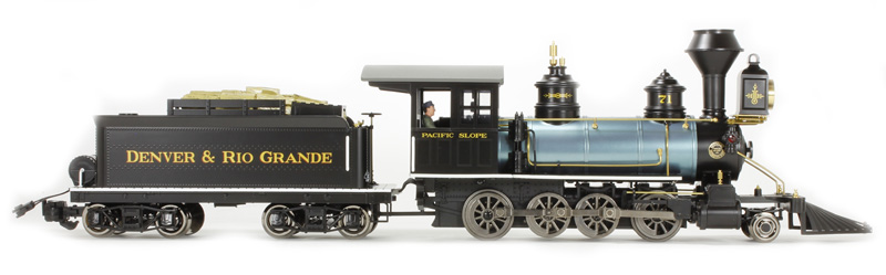

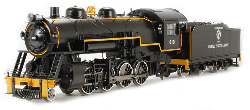

Current production C-19 Consolidation below:
Not outside framed, has new wiring and socked, probably best large scale loco they ever built.
Greg, I'm not sure that's a Bachmann C-19 - I think it's a 4-6-0 with a Barry's Big Trains 2-8-0 chassis - Barry did a 2-8-0 conversion for the Bug Mauler / Annie :nod::nod:

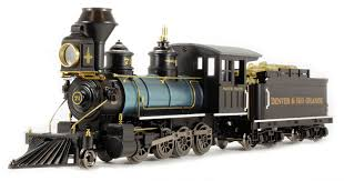

Here's the Aristocraft C-16 - the later version with upgraded mechanism (you can tell by the wheels - the early version(s) had plastic inners)

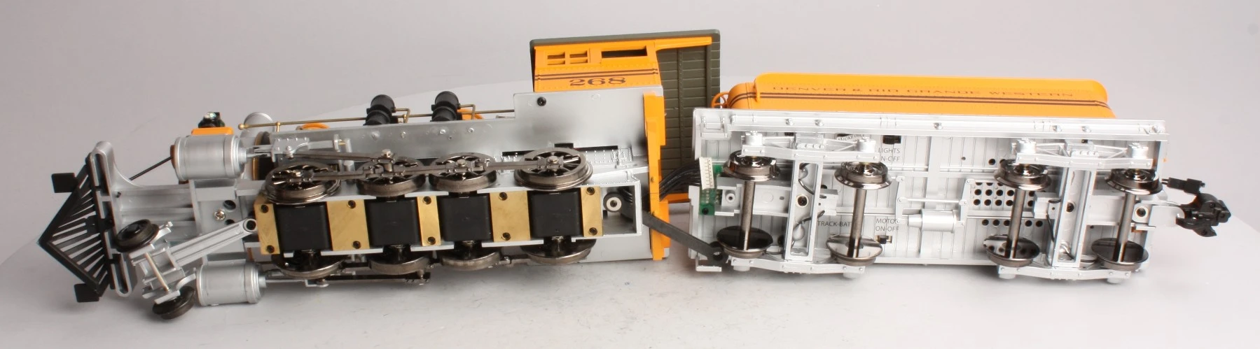

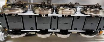

and here's a picture of the underside, with four separate gearboxes.

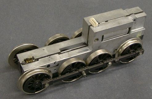

the earlier C16 motor chassis block
