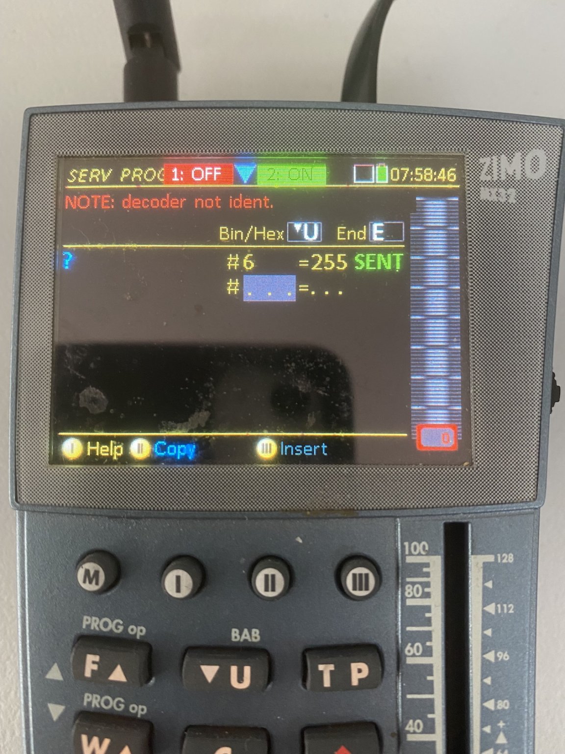

I am working with 2 locomotives one of which was thought to be analogue but actually has a decoder, the other was dismantled (Heidi steam loco) when I first became involved and I reassembled it. Both run well on a DC track so I assume the motors are in good condition. Heidi had extensive sounds, smoke etc. the other doesn't seem to have a speaker but I have not dismantled it fully so I am not certain this is correct.

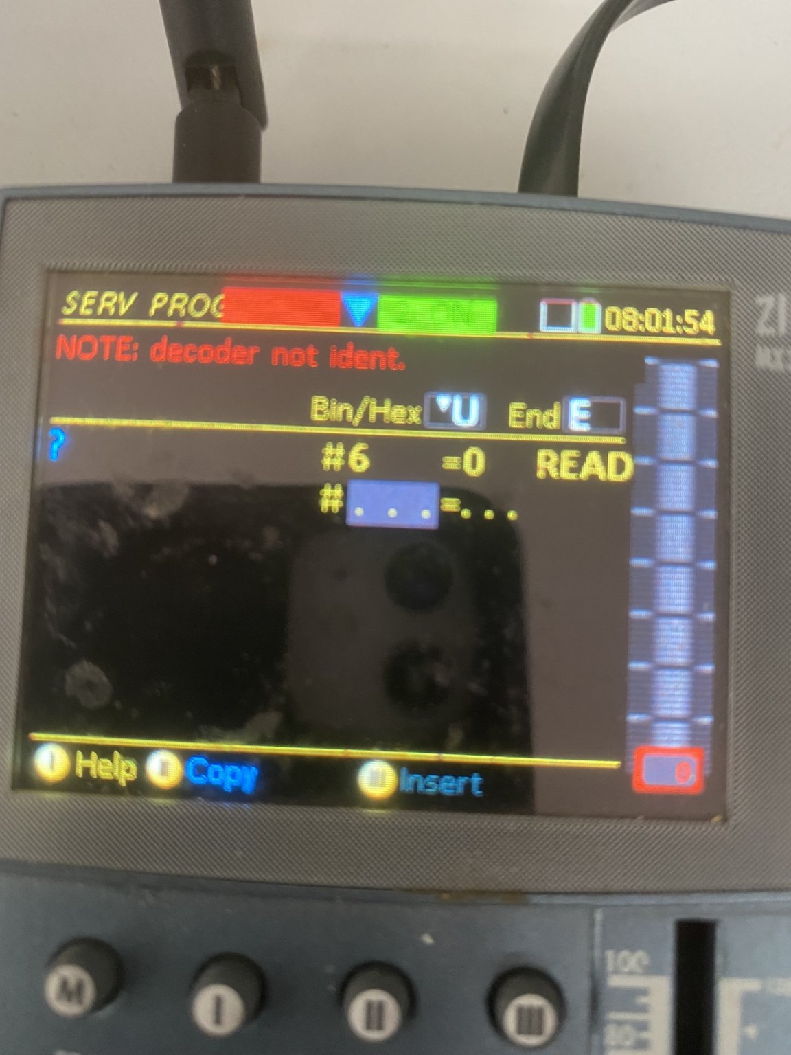

Both Locomotives respond to CV read and write requests and they judder with each selection which presumably means there is a connection between the decoder and the motors. On the programming track the lights work correctly with direction. When placed on the main track neither of them will run, I can control lights but no sounds. Prior to Heidi being dismantled the sounds, smoke etc. worked correctly.
My question - do I have a programming problem or a faulty decoder problem?
