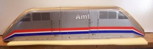

I picked these up on Ebay and am waiting for them to arrive. I am contemplating a single locomotive design. Basically, I'd like to cut them and join the two ends to form a single loco that will have two motor blocks. I don't want it to be too long. The simple solution would be to just cut somewhere in the center of each loco and join the two halves. However, I will loose the pantograph depression if I do. I could just mount the pans on the arched roof anyway by making my own flat area.

But on this bash... I would cut one unit just beyond the door and the other would lose the articulation system "thing" - and would join the two hence?
I am sure you have done such chopping before. If not, use a hobby razor saw by hand- it is definitely the easy way. And i am not a craftsman like you!
We await the progress photos, Cheers, Ian
I was thinking along similar lines. There is a line just behind the door that goes up one side across the roof and down the other side. It does seem like a natural place to cut.
Yes I noticed the line too, have u seen one in the flesh/plastic? Things have a habit of not being simple when you have it on the bench, but seems the natrual option from the picture.

Some photos of my progress so far.  I still need to do a bit of tweeking and detailing.  the body is only sitting on the chassis in the photo.

A bit more detail added.  I`m experimenting with lettering schemes.  I don`t like this one.
A bit more work on lettering.  Although at this point the model is still at ten foot away viewing quality.  maybe even eleven feet.  The two dummy units were not in the best of condition when I got them.  I still may decide to repaint the loco altogether.  But I may wait for the critics to have their say first.
