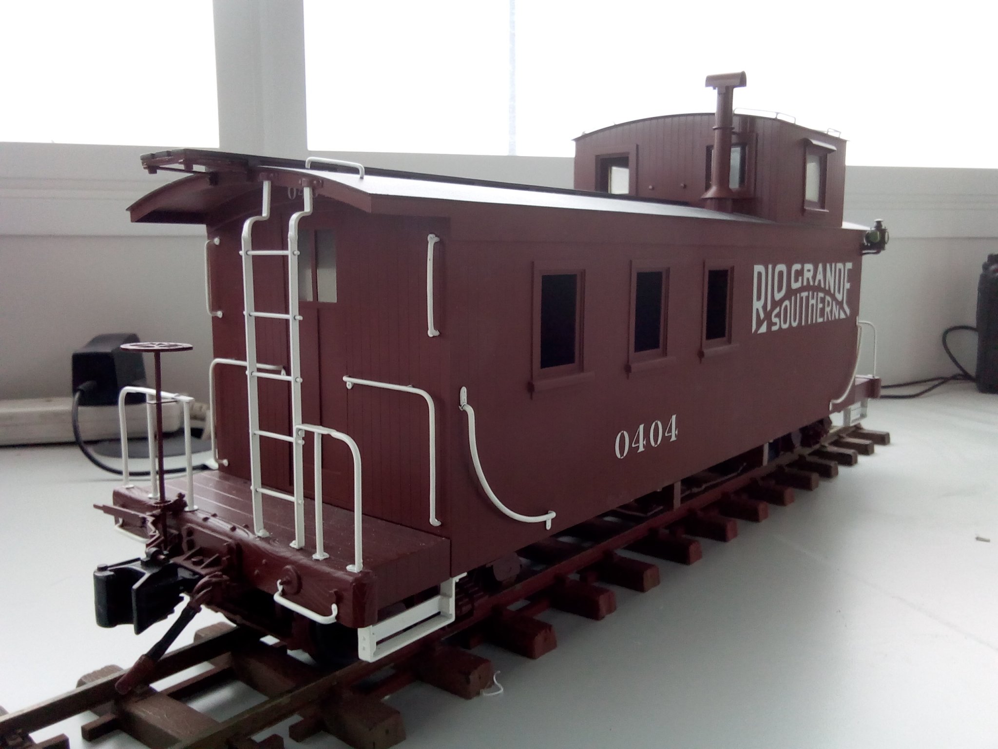

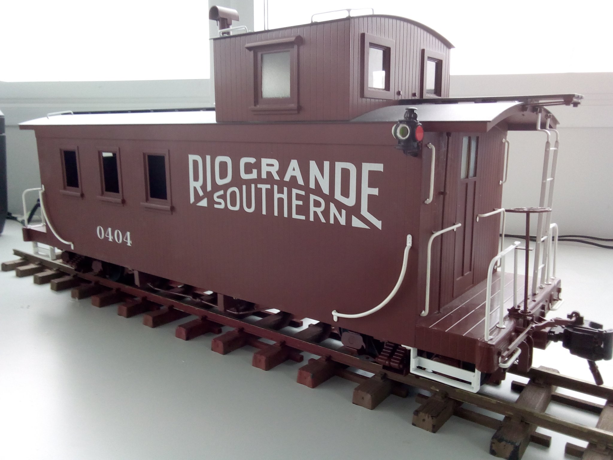

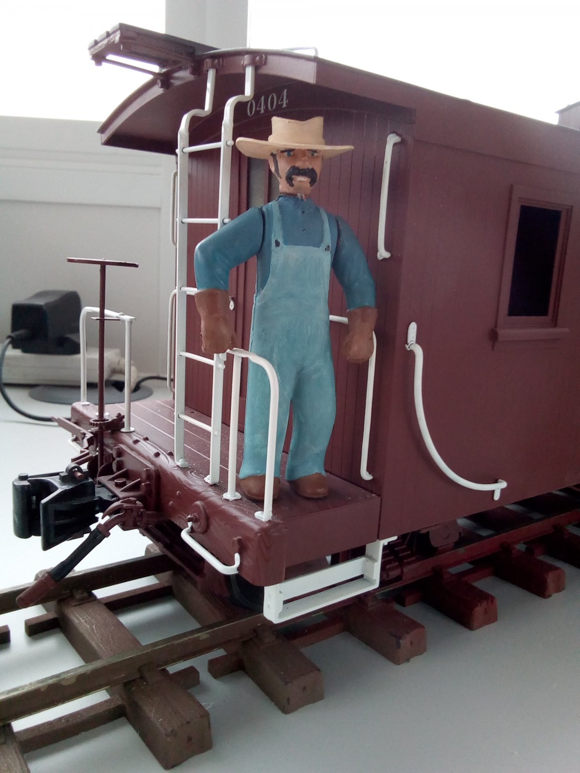

;)A new caboose for the railroad and a test of pictures with the new computer,some little jobs to do on the car and a simple interior is being knocked up to hold the glazing in as the glaze falls out due to the glue loosing its stick, lights are to be fitted to the interior to take the plainness out,Bachmann brakeman also being modified and so far just had a new hat;).The car body has had a matt varnish coat to take the shine off,one of the marker lights needs refixing and a couple of lenses missing and to be fixed.Overall a very nice car,all brass but the biggest problem is the roof does not come off:DIMG_20200216_125507.jpgIMG_20200216_125447.jpgIMG_20200216_125550.jpgIMG_20200216_125848.jpg

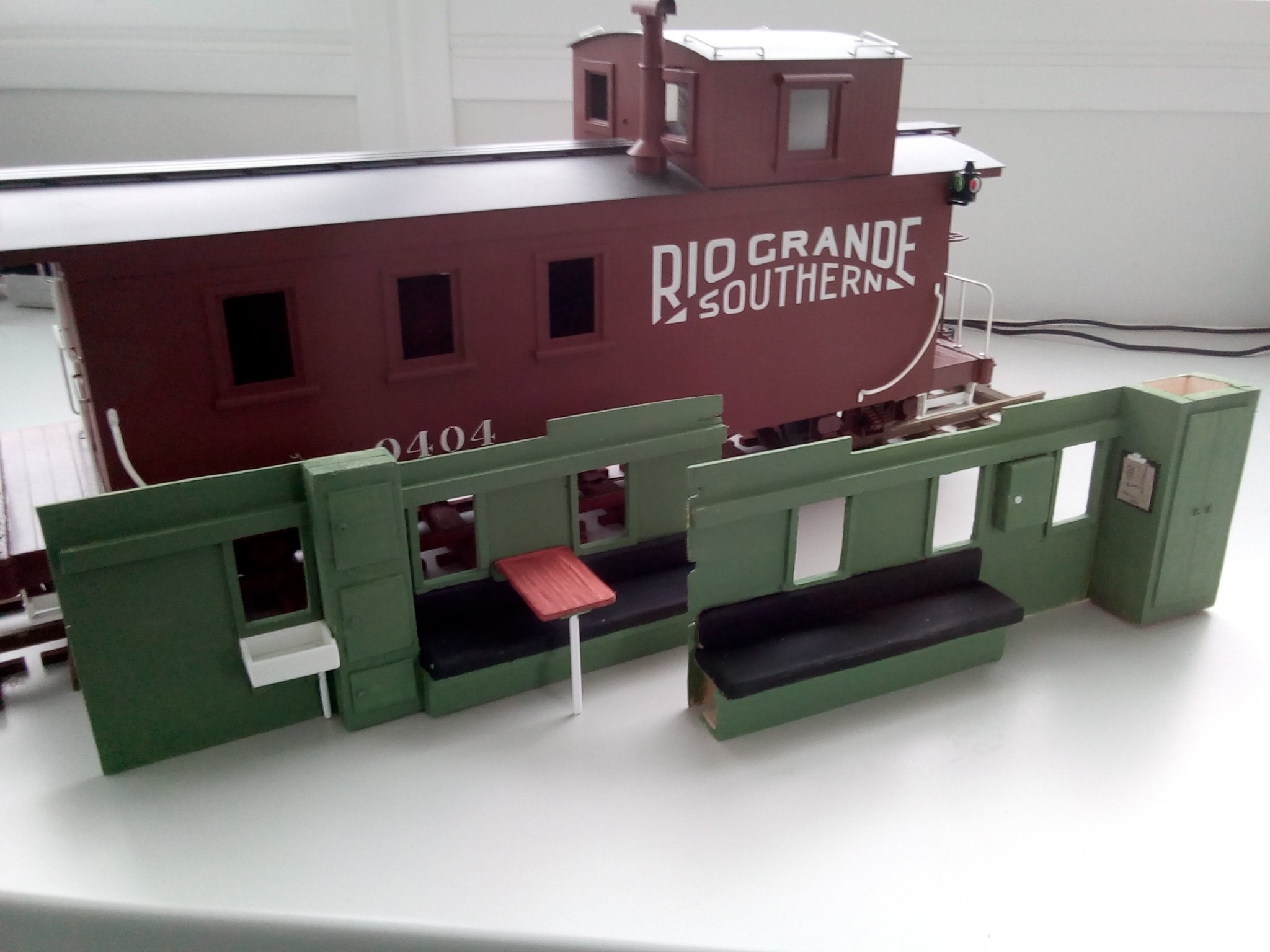

No super glue for glazing he says from experience!!!A little more done on the interior,cupula panels cut and ready to go in but I may make the safety gauges and shut off valves as a little extra detail,the cupula seats have been put together with a half height floor,just the tops of ladders and locker doors to cover the electrics on the floor,when the item is inside the car the high floor is not noticeable and saves weight.I don`t plan to light the cupula anyway,stove still to make.;)IMG_20200224_131949.jpgIMG_20200224_132012.jpg.

A little more done on the car,the glazing is in and should not push out anymore and some of the interior now in position,I used 20thou clear on the cupola and 40thou on the main body,the side windows on the cupula I left open as easy pick up points when lifting the car :clap:.I had to make up the difference from the car body to the original internal window frames and 20thou styrene sheet was the perfect solution to allow a one piece of clear to cover all three widows in one go,then the difference between the car body and the glaze made up with some 60 thou,the internal panels/seating then glued in nice n flat,sorted;).
A simple stove which is lit and ready to go in and working on internal lighting now,some way still to go but slowly taking shape.Oh I wish that roof came off as would make working on the inside so much easier.The only way to take a pic inside is through the end door!!!IMG_20200301_031308.jpgIMG_20200301_031544.jpg
