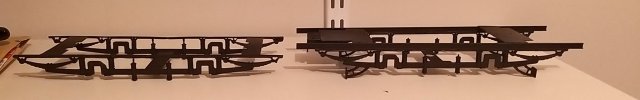

The two styles of trucks I have, the lower one for toast racks.
For the enclosed trams I have put a section of H brass between the underside of the body and top of the truck, soldered to the H brass are some short pieces of brass angle for cables to be tidied away, the centrally mounted cross piece carries the charging socket.
I am wondering if your truck sides printed with removable axle boxes (for me anyhow) and inclusive of the cross plates I have soldered to the casting and H brass, would have the required strength if a piece of flat brass was glued to the cross pieces, if that makes sense, then the whole truck could be printed as a single piece.
My method of fixing the truck assembly to the enclosed tram body is a single M1.5 x 3mm screw at each end through the truck end cross plates in to the body shell floor, to fix the toast rack truck in place I have used the models weight fixing stands with the screw heads catching the central cross member.
Would you mind sharing your side frame CAD file for my friend to play around with a couple of ideas?
To give a bit of an idea what I was going for this is the complete unit:
It sounds like it is broadly similar to what you describe. The key difference is that instead of having the axle boxes move individually the side frames are a single piece and twist relative to each other. The left cross member has a single screw on which it tilts laterally, the right one is rigidly fixed to the car body. The side frames are held to the cross members by an M2 screw at each end. The central cross member is not fixed to the side frames, it just supports the back of the traction motor cases.
The holes in the cross members are all designed to line up with the existing screw holes in the bachmann tram car body, though some shortening of the plastic mounting posts will be needed to get the floor height right.
The reason why I went for a rigid side frame rather than separate moving axle boxes is it allows the use of a small flanged roller bearing in the axle boxes, as well as making the whole thing a lot stiffer for printing in PLA. For my printer at least I think the side frames need to be separate parts so they can print inside face down on the table. I could potentially make a version with the sideframes rigidly fixed to the cross members and separate axle boxes, though I'm not sure what orientation you would print it in to make sure everything was fully supported. I would think it would probably need to be ABS too, just because without the axle boxes in place (and presumably the primary suspension springs?) the frame on its own is pretty thin.
I have a rough running Bachmann toastrack that will probably need a new motor(s). Would you mind clarifying how the motor case itself is mounted to the Bachmann chassis? Thanks,
Hopefully this answers that as well.
I was going to wait until I've had a chance to print and test fit a prototype to make sure everything lines up properly before uploading to thingiverse but the sideframe on its own is attached if you want to see if you can make it fit your purposes.
  • 21E_sideframe.zip

Mr. Melbournesparks, thank you very much for sharing the stl file. Agreed, I think we are talking about basically the same thing with a single piece truck but with a different fixing methods.
I have passed the stl file on to the friendly CAD man who said last night "what another project" , all I know about his creations are they are produced on a resin printer. He also has a KW truck side to help him see how a truck side would look. I'm hoping if the frames are a similar thickness to the white metal ones having sprung axle boxes will work.
The big thing for me will be the ability to produce different wheel base trucks.
One thing I did have a ding moment with last night is that I am converting the tram the hard way, I have tried to mount all the wiring and switches etc on the truck, I'm what we would call a ti'et, I should be fixing control units etc to the tram body and simply running motor feed wires to the truck, TITT.
MkIII arrangement is being developed.
I did admittedly prioritise it being simple and robust over fully prototypical function in some ways, but my modelling leans in that direction given the operating environment.
I'll be interested to hear about how it goes printed in resin! I don't really know much about designing models for that method of printing so stuff about orientation on the table might not apply. I've only printed this one in PLA so I'm not sure how that compares strength or durability wise.
I can split the sideframe in half so the two halves can be recombined at different lengths if that would help, but your 3D person may well have already done that. The axle boxes as designed fit a 6mm OD flanged roller bearing.
