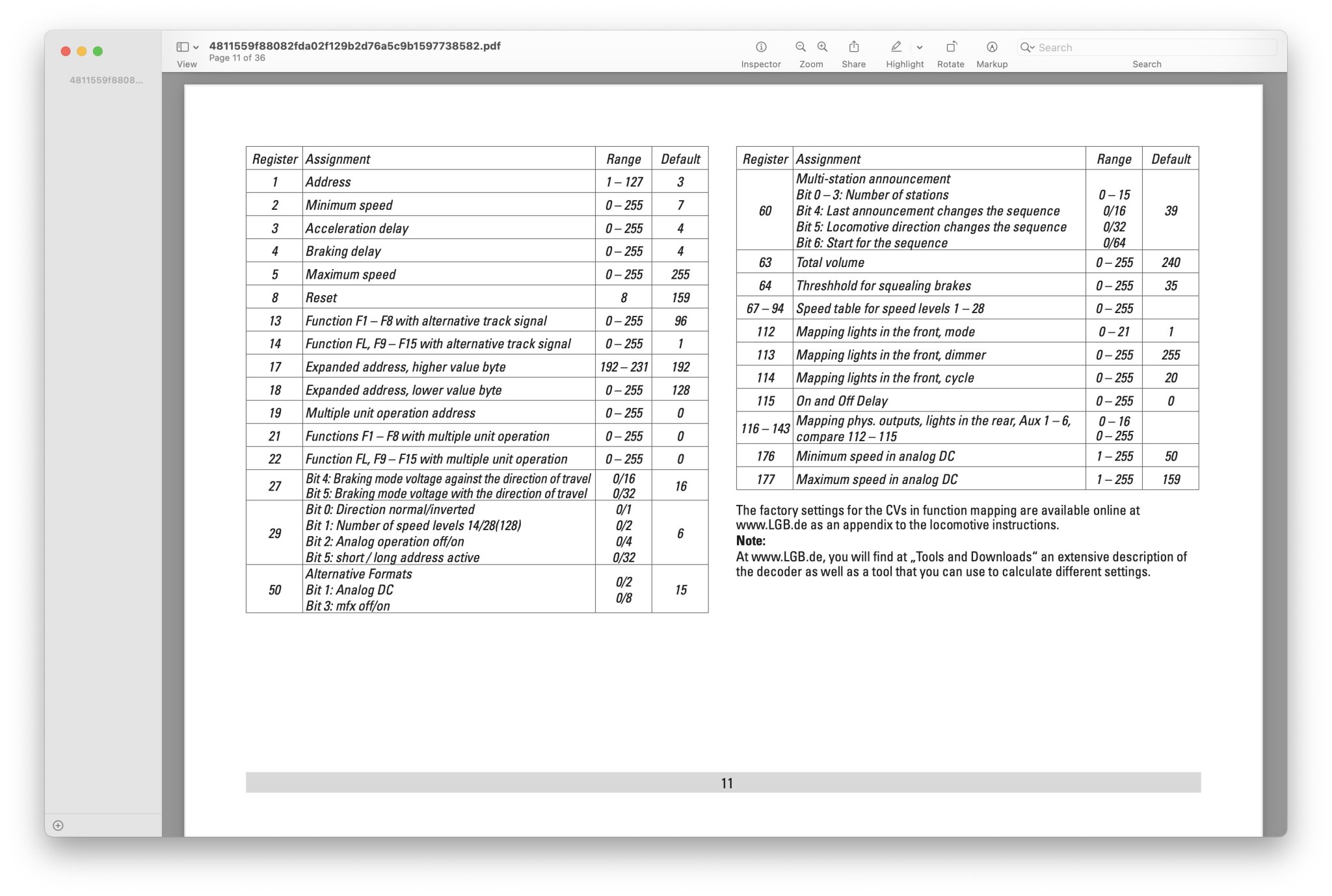

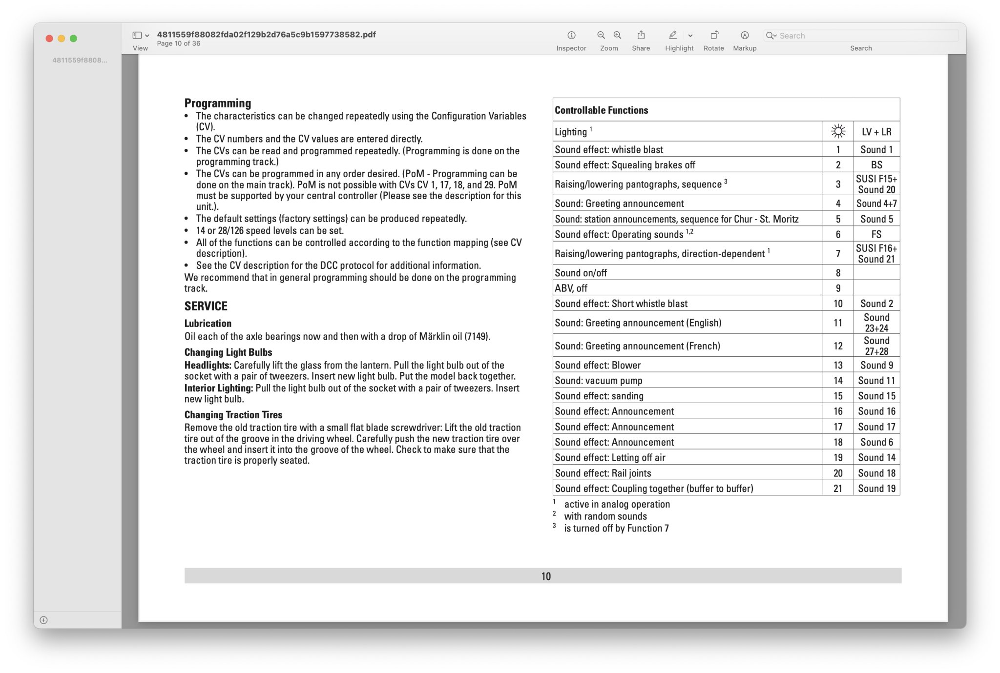

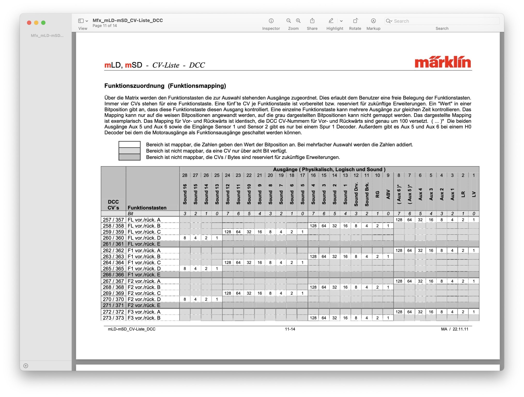

I have managed to alter the sounds (changed F button allocation and individual volume of sounds) on six older Mfx equipped locos successfully by Dimax Navigator PoM and using the functions mapping chart (see third attachment below.) The handbook on these other LGB Mfx locos also listed the CV numbers to control individual sound volume on various functions. The 28446 handbook does not give any of these sound CV's (see pages 10 and 11 from the 28446 handbook attached below.)
Additionally, I have attempted as previously to move sounds from one F button to another, using the logic on the third attached chart. This has worked in moving Mfx F button functions around before, but has not this time. The other difference is that this RhB loco has 28 sounds and lists 21 functions (see p10 below), which is considerably more than my older Mfx locos had. Obviously with only up to F15 identified on the third chart means that many will not be able to be used. However, this would not matter if I could choose which of these listed sounds are on which F button, as I have managed to achieve in the past.
I am wondering if this being the newest loco with Mfx I have purchased have Marklin taken a decision to make personalisation of the more extensive sound library impossible using the Massoth Dimax PoM by withholding a newer CV listing and not publishing it?
