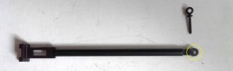

I had to file a little bit off the top and sides of the coupling bar, the part that fits into the "funnel" and has the pin inserted through it, to get it move freely around R1 bends. The way the coupling bar links to the LGB hook and loop couplings is ingenious and works very well

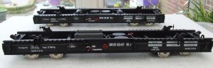

JonD, I think you could be right about the rollwagen models perhaps not sitting quite low enough - but I wonder if it's a deliberate decision to avoid risk of the fouling on things such as lineside fittings.... or it may be down to the size of wheels that are available to the builders, I think that even the quite small (20mm or so) wheels that are used on the models are possibly still a touch oversize compared with the very tiny diameter wheels that the real wagons seem to use?
These are my Modellbau Uwe ones, as also available from Zenner: they might ride a little bit higher than the real ones, true, but I think they are close enough....
....and with the open wagon loaded up....
Yes I think it is, the "simple" model only just misses the top of LGB point motors on inside bends, and just brushes the top of PIKO point motors which are a little higher.
And yes the wheels are spoked, but you can't see they are spoked unless you look very carefully, with your eyes at track level.
Jon.
I used IP Engineering 16mm Insulated Wheels on my Rollwagens. Yes perhaps some compromises needed to be made to miss Point Motors etc as Dave has said. Plus access to Production wheels as well. Sometimes it is not always possible to have things just so, as I found out when looking at my own bodged ones. Never mind, I can live with the looks 'looks from a distance' rule, for mine the further away the better!
