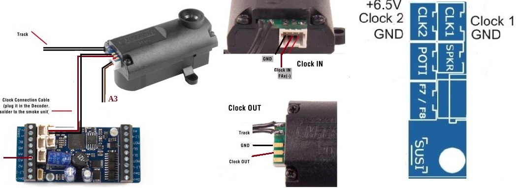

thanks @The Shed . It looks you recommend to connect the smoke generator to the Clock OUT and not the Clock IN. I was confused connecting it to the Clock OUT as the XLS describes that the Clock 1 connector should be connected to an external pulse generator, something we usually find on the axes. In this case, the smoke generator is to be considered as an external pulse generator ?
Where did you get this drawing from ? In the current manual, it's described but in a slightly different way.
Scrambled brains earlier, the Pulse Generating is taken care off by the CV settings from the decoder.
hmmm.... It was my understanding that the CLK1 & CLK2 connectors were inputs and that if you wanted to supply an external clock signal you would use A3 to simulate the clock pulse.
@muns, quite correct, Flu had scrambled my brain cells earlier, added the missing item and amended the picture

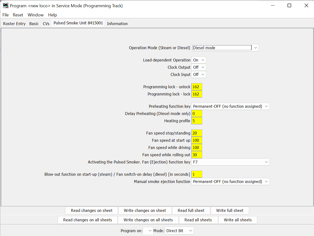

BTW: those that use JMRI, I created a new decoder file for the Massoth pulsed smoke generator (8415001). It has been submitted to github and will be available in one of the following JMRI releases.

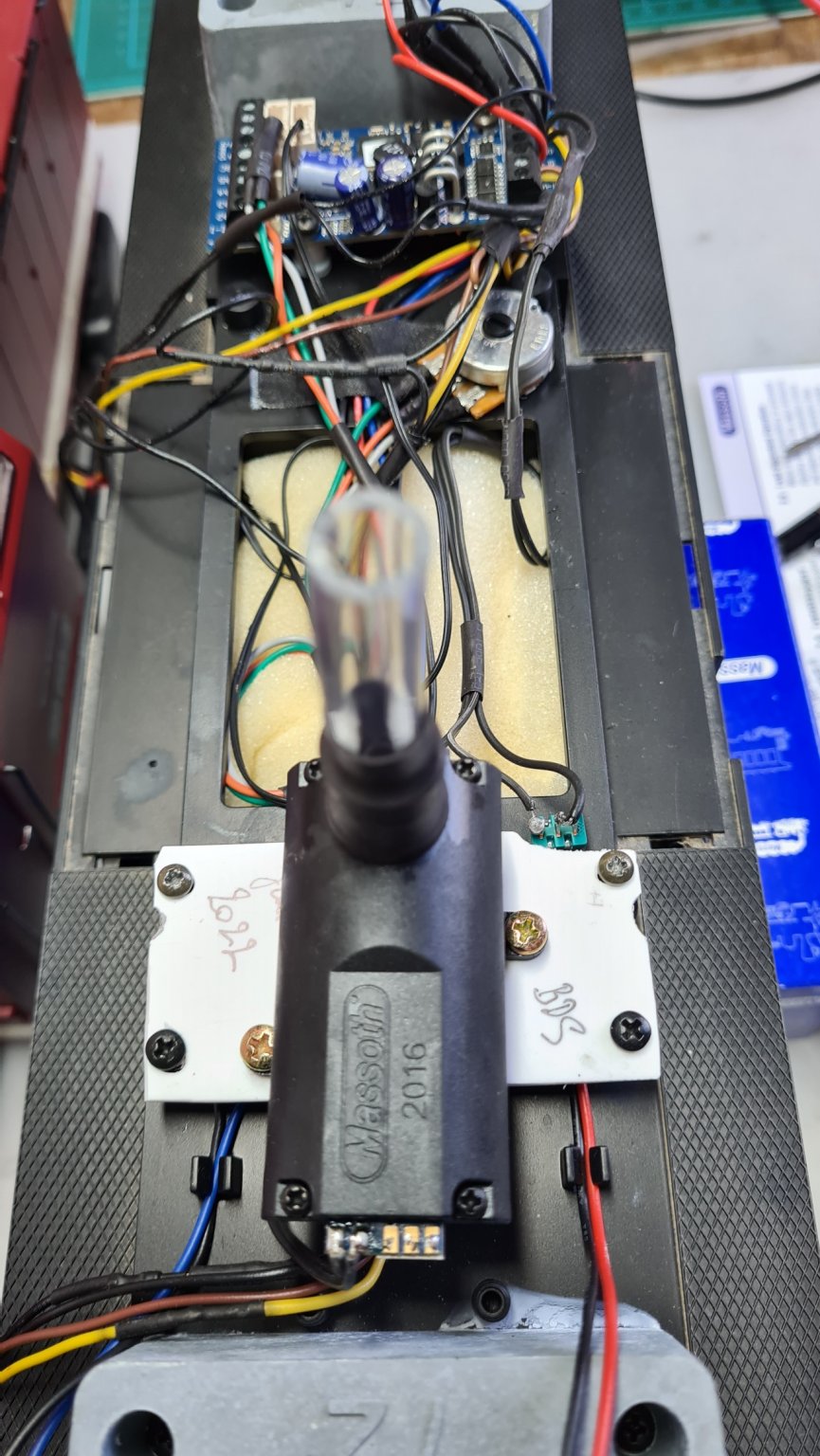

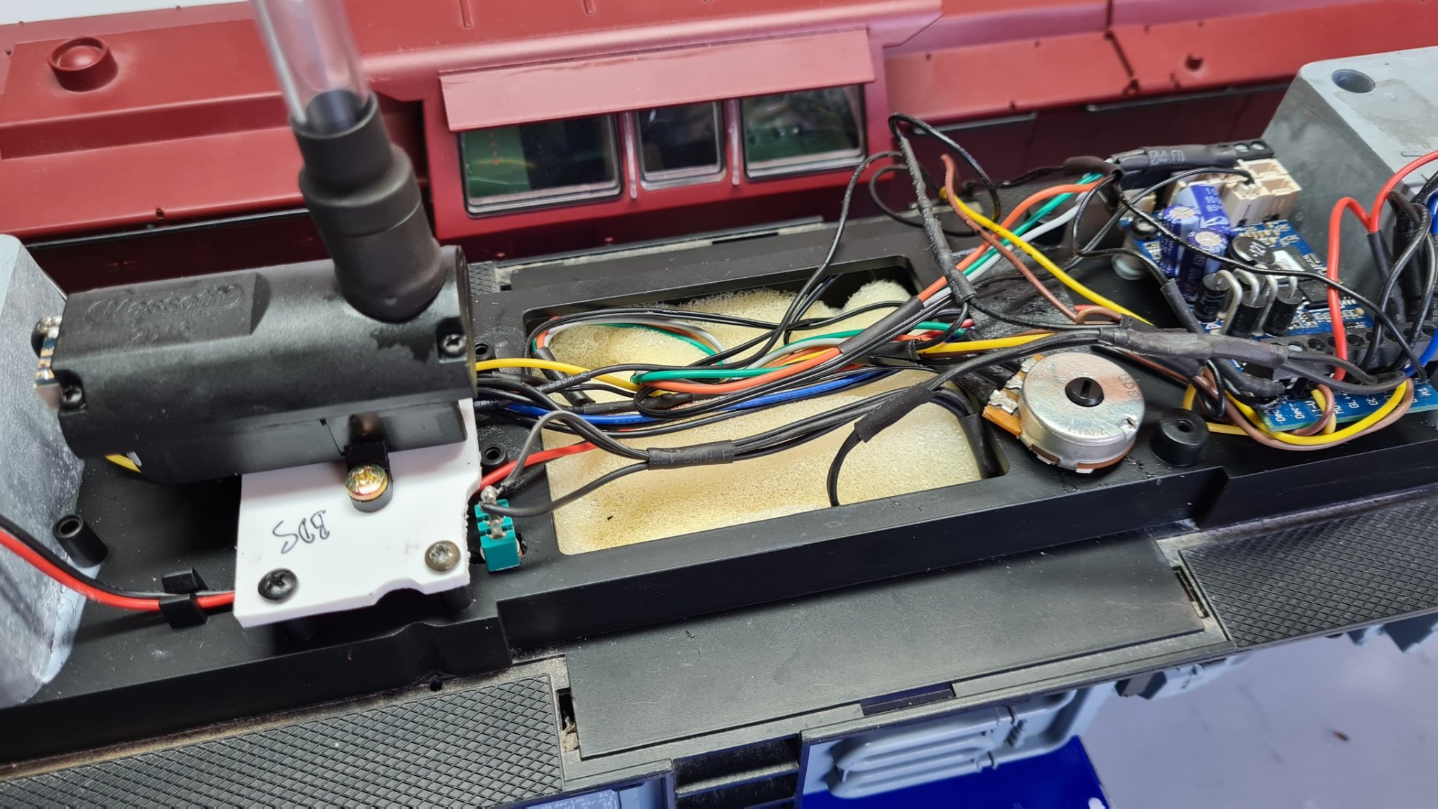

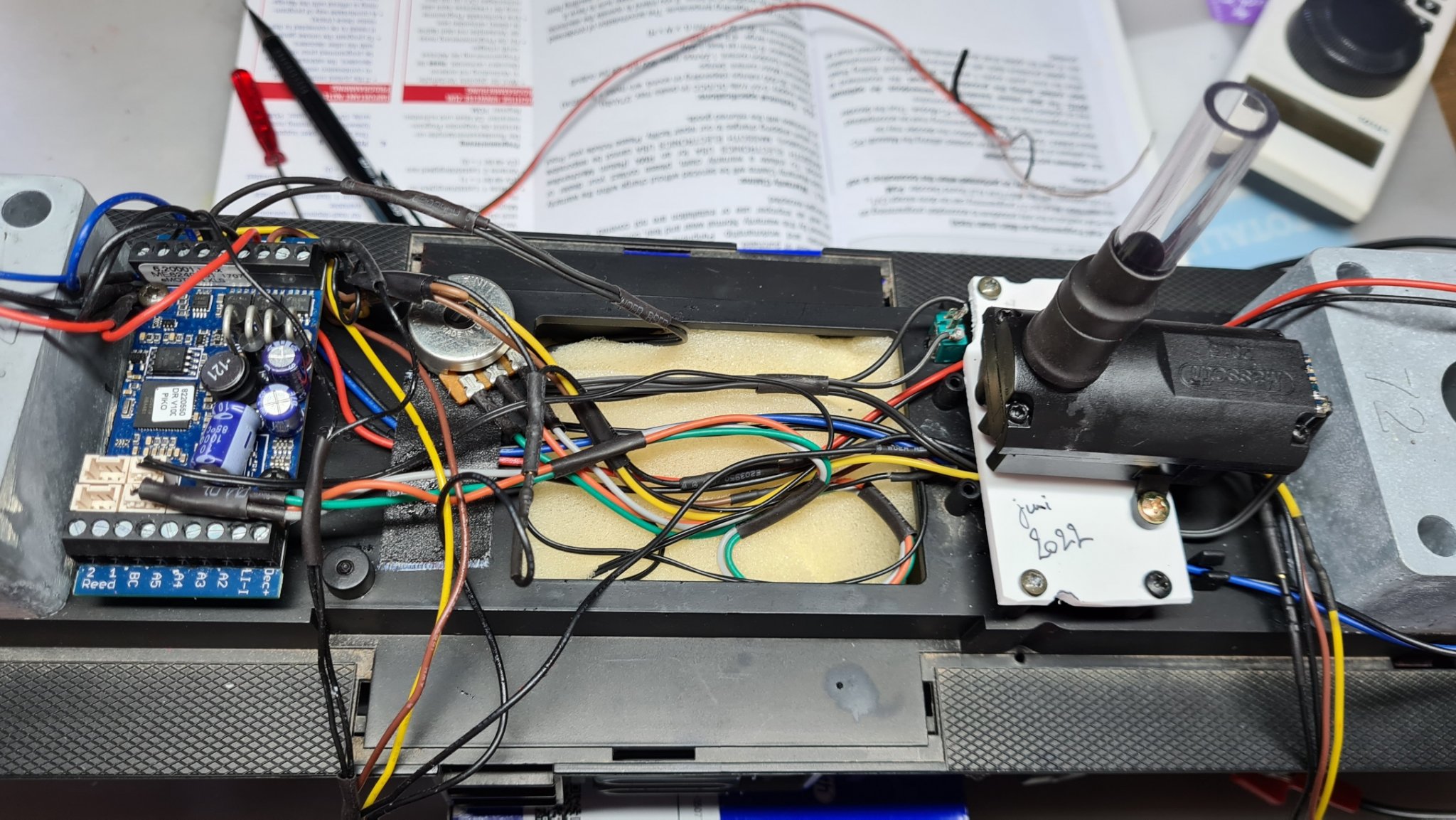

@Diesel2000 many thanks for the confirmation. I had the same idea to install a small switch (green one at the left) and also added a potentiometer to manage the sound volume. I changed CV15 of the smoke generator to something else than 162. It's locked. Great support. Hopefully somebody from Massoth reads with us and could add a small paragraph to their existing documentation ;-)
